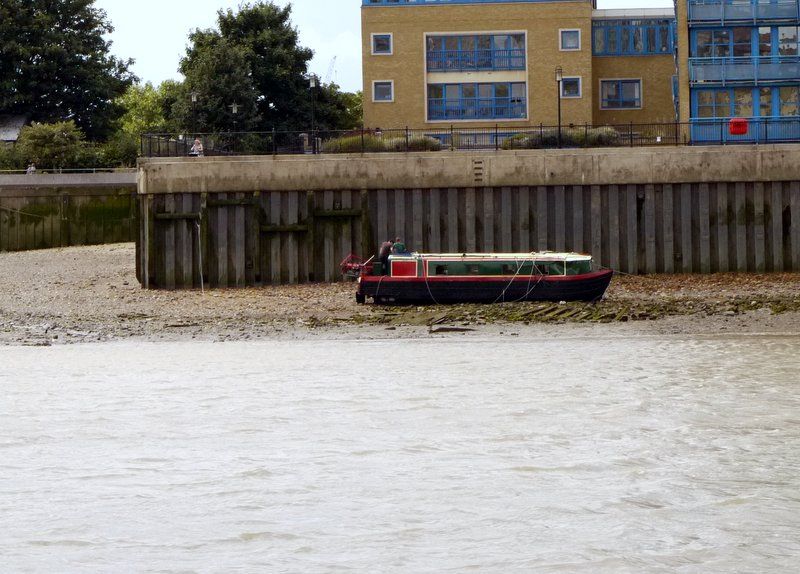

It would be interesting to learn why it sank.
One possibility is that the wash from a fast-moving boat (like the RIB Experience) swamped the stern, which, if all five people and the dog were stationed there, would have been dangerously low in the water anyway.

I'd say it was quite an old boat with possibly an air cooled engine and would probably have quite a low down in the hull open air intake grid of something like 12X6'' always very vulnerable in rough water,the hot air outlet would be a bit higher up.
Sounds quite likely, and if so, then it was definitely not suitable for the conditions.

We went past it yesterday. Local gossip was that it had been dropped into the water at south dock and was going across to Limehouse when they had a "stern gland" problem. I have never been into South Dock so may have the position wrong but I think the rescued boat was perhaps 100m away the entrance. A marine surveyor and welder were just climbing on board as we went past, I have to say that having a problem on the tideway which needs help from a welder does not sound good. There was also a nasty punch like dent in the superstructure at the front, we could not work out what caused that.
When came back up to Limehouse there was someone there but we were too busy watching 4 ribs and 2 clippers go past us all within a few seconds of each other. All 6 went past us at speed and I have to say it was not too bad, there is less wash when they are at speed but I get the feeling that we get random bounce back waves from the river walls which can be awkward. Slow moving boats especially the City Cruiser that we call Battleship Potemkin are worse but not the very worse. Yes treat the tideway with extreme respect, take loads of care, prepare properly but don't get too paranoid about the other boats.
We wanted to get the rest of the gossip from the lockies when we came back but after 4 hours of minor squalls the heavens opened as we came back into Limehouse - the rain was silly intensity so we let them dive for cover.

Indeed and these engine space air intakes are usually only a few inches above the water line as are some engine space ventilation grids in some water cooled engined n/b's and w/b's, so crossing the river with perhaps a strong tidal current running and possibly a strong wind with it and fast boats passing by could have caused the boat to keep broaching and become quickly flooded through these apertures. In such conditions indeed if the conditions were similar to how i've explained then the safest way across would have been to have gone up or down stream far enough to enable it to cross over at a gentle diagonal angle quartering any large waves. But of course we don't know the true state or design of the boat or the river and wind conditions at the time.

So, where it sits now, I take it that that spot floods when the tide comes in? Is that where she sank, or was she taken there?
I would guess the boat was taken there, because that is where it probably would have been taken (close to the wall, so as not to be a hazard to other boats) if it wasn't there to start with!

Is the boat a small Springer? I'm not sure as I'm used to seeing them with those flared bits on top of the bow.
A small narrowboat like that (especially if unballasted which is often the case with those boats), would tend to pitch considerably in the waves which might cause it to take on water, but if it was a stern gland problem then it wasn't really fit for the river. If the absence of lifejackets is any indication, then it sounds like the boat was equally ill-prepared as those onboard.
