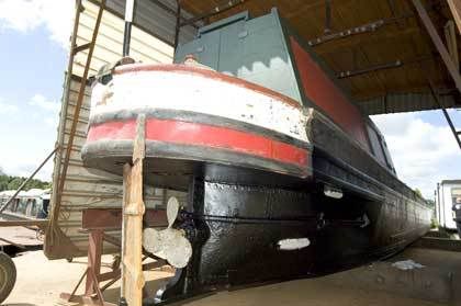

It's not so much the flat bottom as the sharp transitions from the sides to the base at the stern, and to a lesser extent the bow. The water wants to go under the boat, rather than round the sides, ( which is why deep water helps) but it has to come out again at the back. If there was a curve from the base plate to the sides of the swim the water wouldn't have to go round sharp corners and there would be less drag. The double curved stern swim ( never reproduced by washer josher builders!) on a Saltley josher is probably as good a compromise as any, but also probably is the cause of joshers' reputed ability to 'pick up a tea leaf'.
It does seem that you might be slightly too over bladed. If 7.2 mph and ~ 550rpm is bracket open then there's another 200 rpm to be had. Using this might save a little diesel- because you are putting diesel in at practically the max rate achievable but it's not delivering all the power it could ( flat torque curve) so at say 740rpm and 7.2 mph there would be the same need for power but it would be obtained more efficiently. It's all rather academic though- theres only a few stretches where you could get the benefit. Once in that wavelength=boat length trough the only way out is to plane- and I doubt Alnwick would do that even with two TS8's. I've seen a few skippers of lighter modern boats apparently trying though.

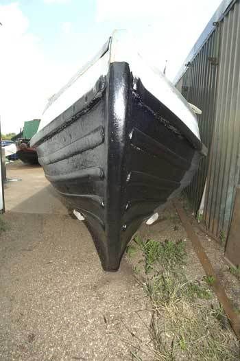

Narrowboats, whilst pretty well designed for their functions, do NOT have a particularly efficient hull shape.
Most these days have a very inefficient hull shape, but Phil Trotter is a different class of builder. It comes as no surprise to me that you can achieve the hull speed he estimated.
Then look at the lines of this boat - FMC motor Crane. The curves and length of swim you won't find on most NBs today.
