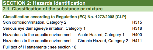

ditchcrawler Posted November 1, 2022 Report Posted November 1, 2022 On 21/12/2018 at 12:02, Lesley S said: Hi Everyone. Just thought I'd report back about my algae. I used Patio Magic and a week later (despite intermittent rain) it scrubbed off with very little effort. Thanks again for all you interest and taking the trouble to reply. I wish you all a Happy Christmas and safe New Year. Lesley not good for the environment https://www.lovethegarden.com/sites/default/files/content/products/documents/spec_sheets/UK_016491_PM_msds.pdf
