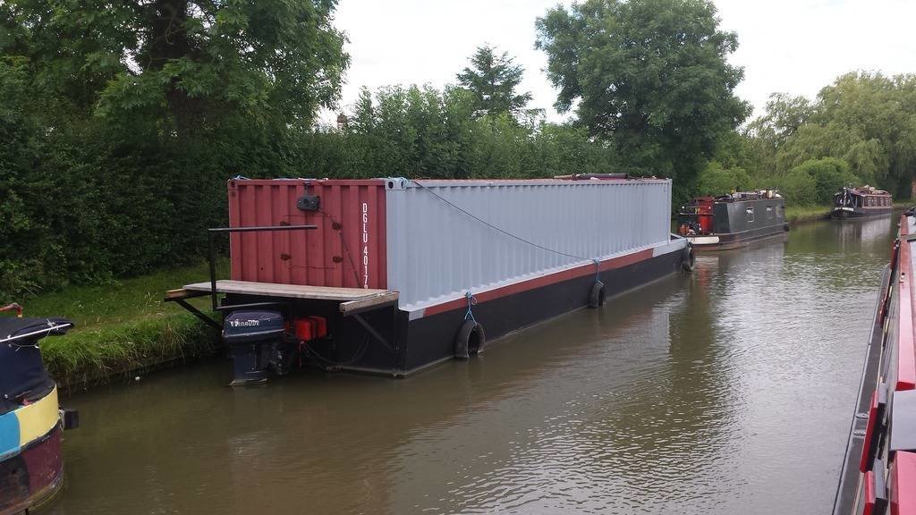

Please don't replicate this infamous monstrosity

Best place for such monstrosities, in the sea! Or better, under it.
Didn't there used to be a boat with a car grafted onto it for the cockpit? Somewhere on the GU I think...
The one pictured above almost makes me think that someone has plonked a container onto a hull! But of course no one would do that.

What is it about that fine vessel that makes you both think it would not pass a BSS?
No engine, no fuel system. About the only thing that would involve the BSS regs is gas, and it might not have that either. And if it has, you can't see any of it from the photo.
Stove?

How does a boat like that get its BSS?
Our Waterways will be  full of Vessels like that one before long ,and ,as has been suggested by several Members on here ,we will soon have Third World living standards in the UK.

I think this is still floating its way around the system, man powered !!
Could a boat have more character
