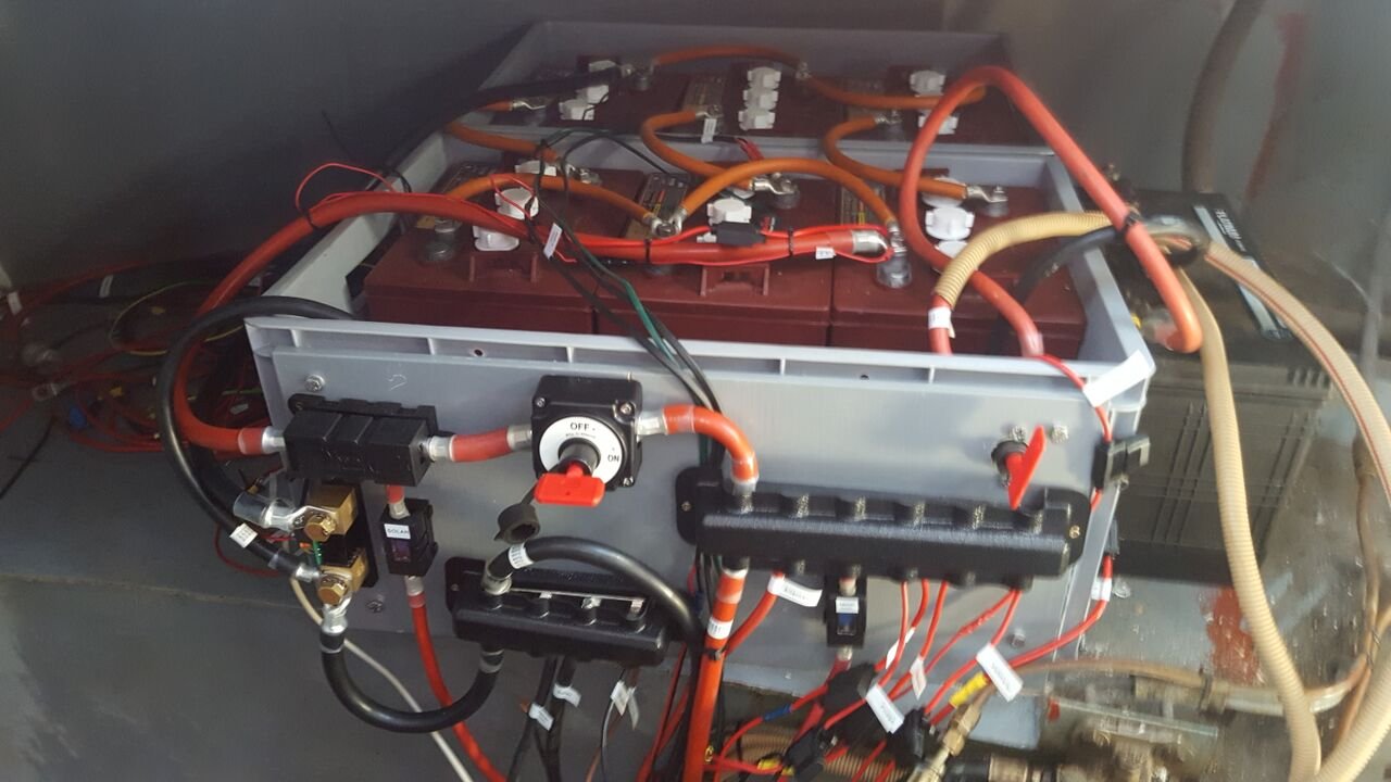

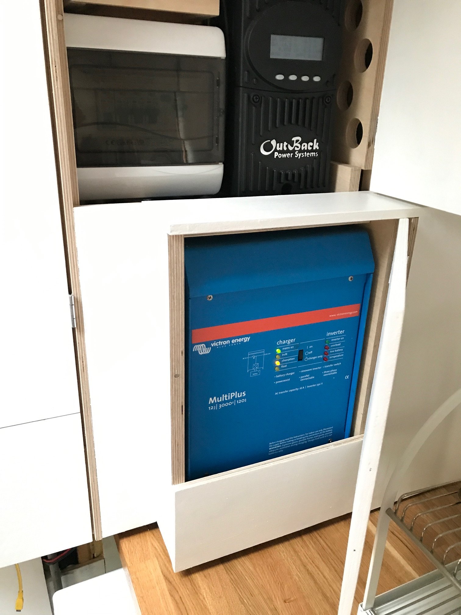

Hi @mross  Could you clarify how I can "measure the volts between the battery and the inverter." I will be checking the battery bolt and crimp in a moment.
I have added some photos of my setup annoyingly after a year I have finally boxed in my inverter so its a little tricker to get to the cables at the bottom :/
@nicknorman that would make a lot of sense!! it has only started happening the past 5 or 6 weeks since the temps have been getting colder, I guess the heating element requires more power as the water is colder, thanks so much for your idea I will try your hot water trick.
Hi @Phil.  does it do it automatically?? think I need to check my setup as in the summer months I certainly had enough solar.

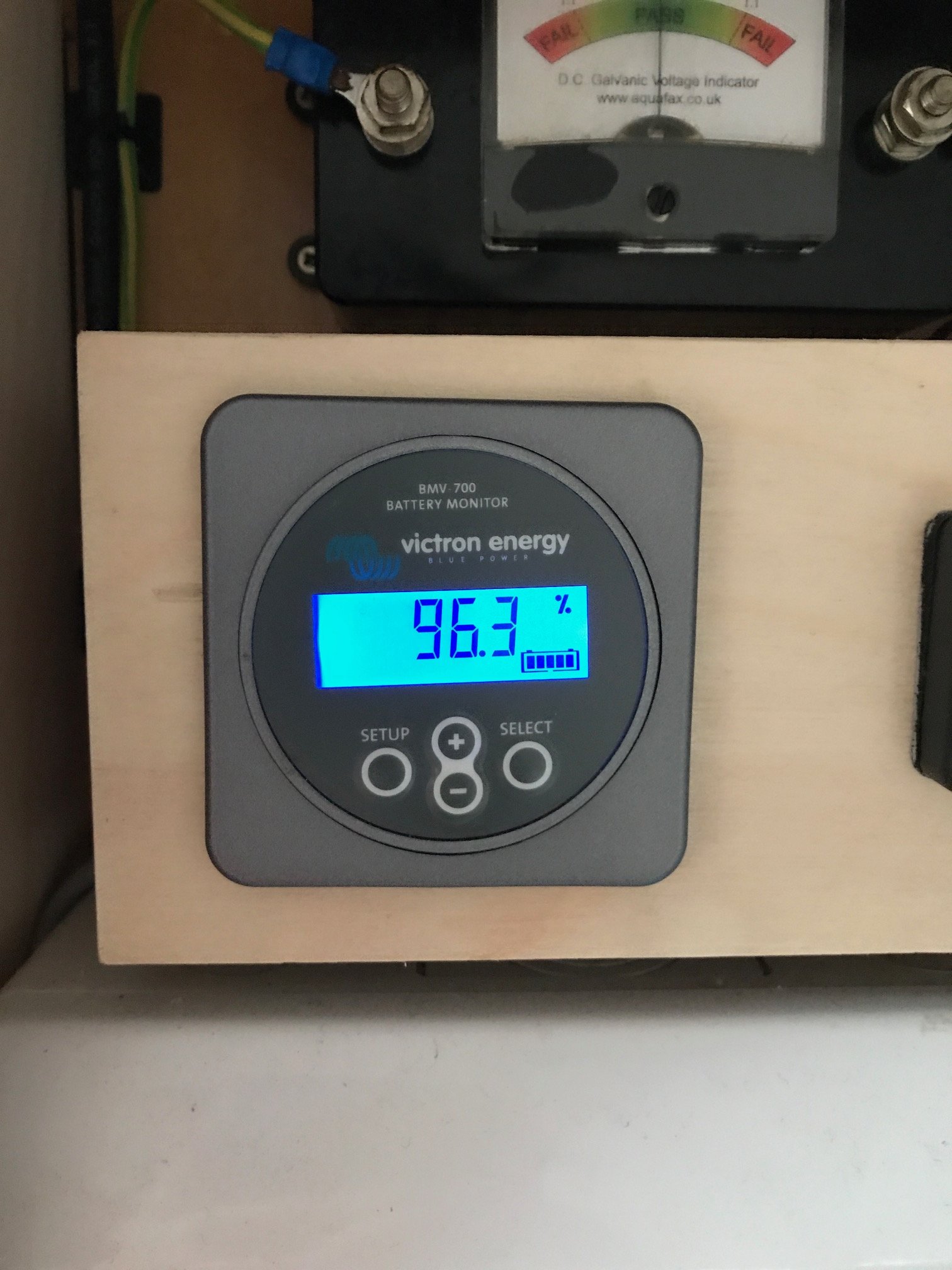

  • Author
#25

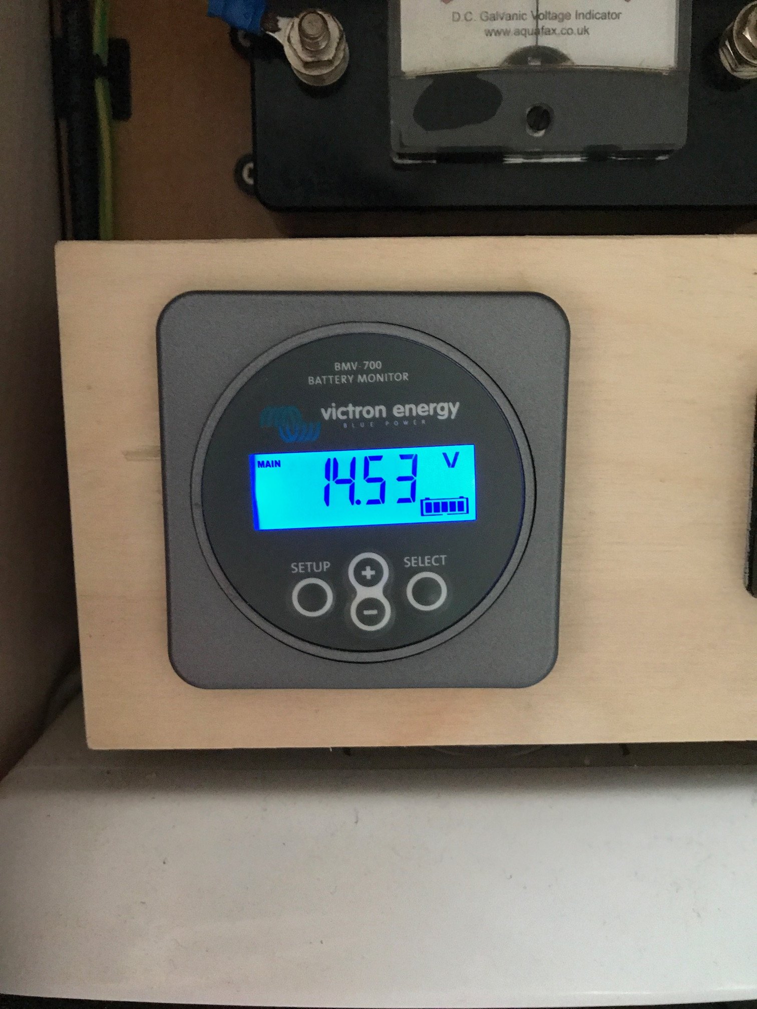

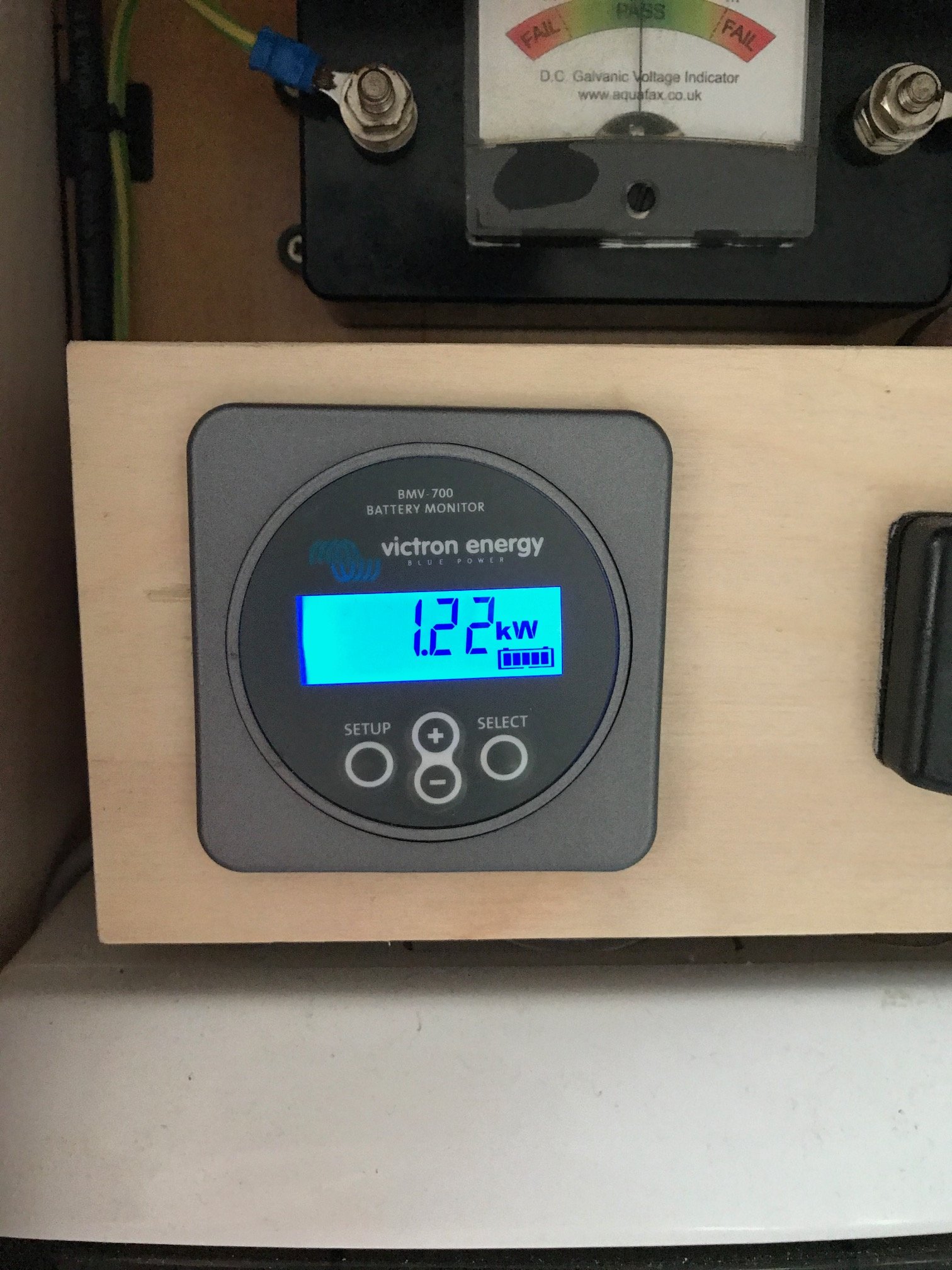

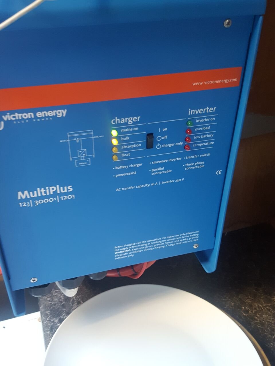

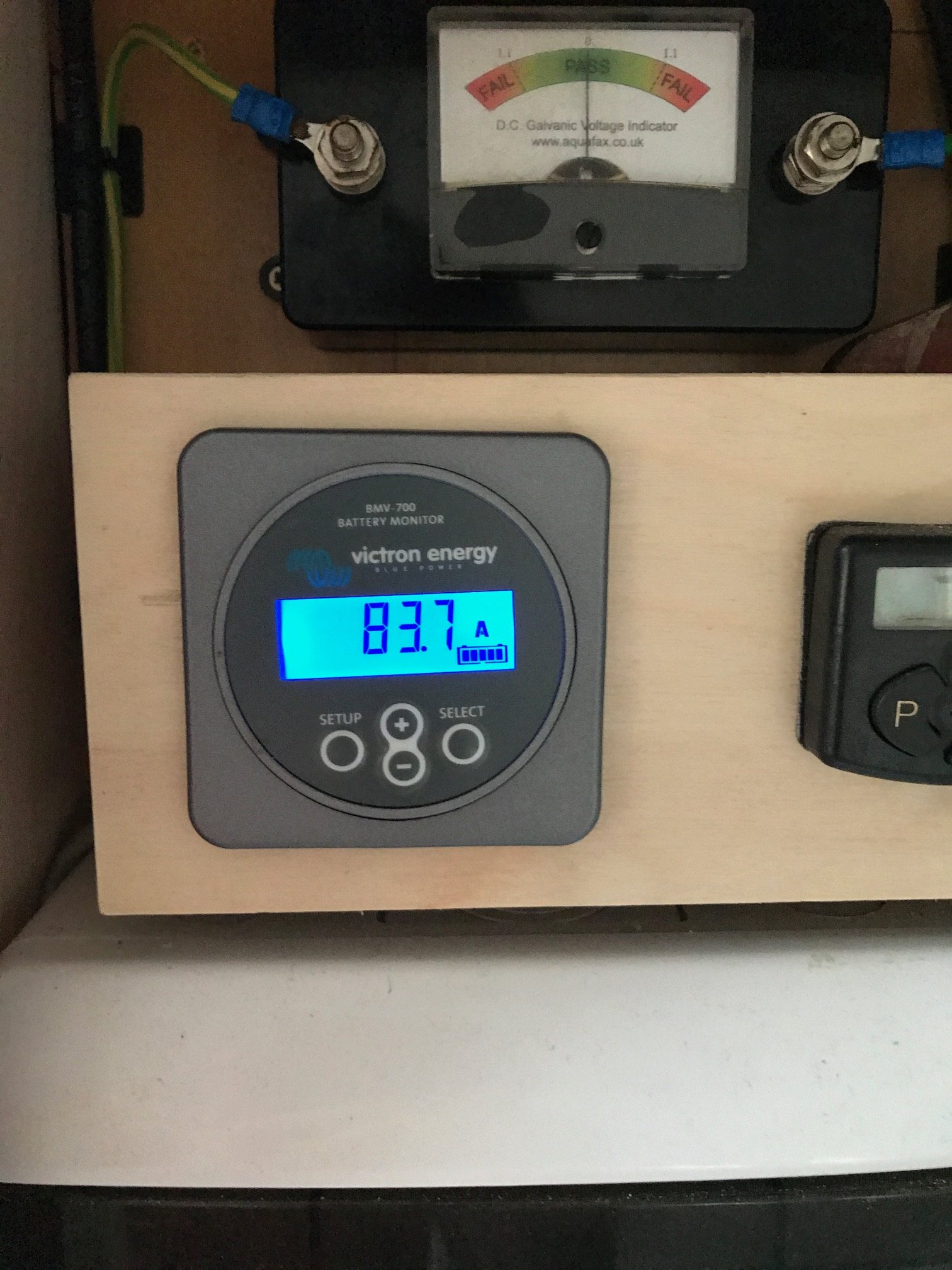

I am just charging my batteries to see if I can determine my tail current, (my hydrometer hasn't arrive yet) they were reading 90% on BMV for what its worth...
Not sure at what point but the Victron has switched to absorption and I took some photos of my monitor,
I am guessing I am waiting for the 83.7amps to read between 6.75 - 13.5amp which I imagine is going to take a long time...
Edited by meerlaan
forgot to add photos
