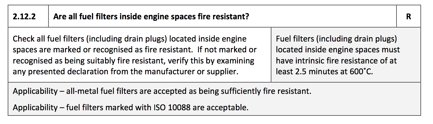

I was chatting to another boater today, we got onto the BSS scheme, my test is due shortly. He told me that I'd fail because the fuel filter on my engine, a Vetus, has a plastic bolt on the bottom of it, designed to be unscrewed to release any water. This should be metal apparently, plastic is unacceptable.
Does anyone know if this is true? If so, I bought the filter from a large internet seller a couple of years ago. Why would they sell an item that's obviously for a boat when fitting it will make it fail a test? Should I get on to the supplier and tell them they should stop selling them, and ask them to send me something that will enable my boat to pass the test? Any other thoughts?
Yes it's a fail. A metal bolt won't be hard to find.

Unfortunately this is not allowed on narrowboats and would fail the BSS. If you buy on the internet it may not be acceptable on the canals but ok for coastal/ocean boats - and there is very little difference in the usage of this particular item. Our original bolt on the Cav filter was also plastic. I note the one on our current narrowboat is metal and thus complies with the BSS.
If it's the genuine Vetus fuel filter on the side of the engine, you'll find the plastic nut is only a cover to help you undo the aluminium drain plug underneath it. Have gone to a few boats that have been failed for this, till I proved it to the inspector with a new one from stock.

Thanks it's not a Vetus filter. It's a red one, Baldwin possibly?
Maybe I should try it on with the examiner, assure him that the plastic is just a cover, there's a metal one inside.
Your spot on meanderingviking, if it's the genuine vetus filter p/No STM3690 it will pass, the one thing with the vetus 2 pots is that some had mechanical fuel pumps and have to be manually bled after removing the filter.if it's a Baldwin filter, they come with a plastic drain plug.

I've found the filter I bought, it's a Baldwin BF1257. The blurb on the product (Inline Filters) mentions: Thread M16x1.5. Is it safe to assume that that refers to the drain plug and if so, could I simply get an M16 bolt, screw it in, and pass?
I use Baldwin filters from Inline Filters, and the Baldwin equivalent of Vetus STM 3690 has a metal drain plug these days. Baldwin 1257, as the OP states.  It could be that the OP has an old filter, or was supplied from old stock. Just order up another Baldwin 1257 and make sure that your supplier is aware that it has to have a metal drain plug.  The only time I've received one with a plastic drain plug is when Inline Filters had run out of the Baldwin filter and sent me another brand.  They immediately replaced it when I pointed out the problem.
Nay, the M16 thread would be the thread in the hole where it screws onto the mounting head casting. The plug would be something like M6 or M8.
Apologies to anyone who might be offended by the language but this BSS requirement is bullshit. I've just spoken to a mechanic friend who's been a car mechanic for 40 years. He assures me that if a car rocked up for an MOT with a plastic drain plug on a fuel filter it wouldn't be an issue. It's not an issue on ocean going vessels. But it's an issue for the BSS board.
Is this a good example of health and safety gone mad, I wonder. Do the board of this authority have to create a large number of items of potential failure, just to justify their existence?
I wonder how many people have died due to fuel filters being made out of plastic. I wonder how many near misses there have been. I suspect the answer to both is nil.
I doubt if many folk have died through a plastic plug, but. The idea is that if a fire broke out in the engine space for some reason a plastic plug might melt and spill-pump out fuel  especially if the engine was running, the spilling fuel would feed the fire. A fuel leak like this on a vehicle would most likely just leak away onto the road and away. On a boat it can't do this, it stays on the boat and burns probably until the whole boat is consumed and probably burnt out to a cinder. Its for a similar reason why gas piping on a boat mustn't have soldered joints. Sounds like your mechanic is a bit of a goon.
