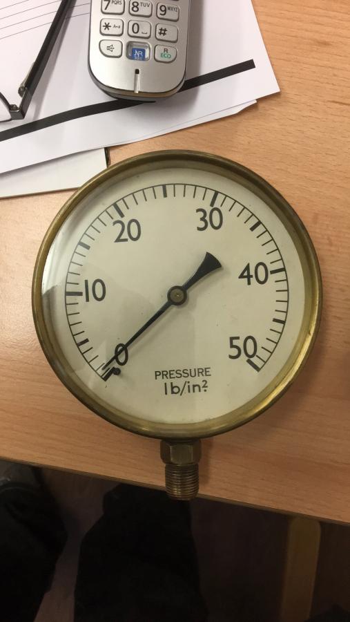

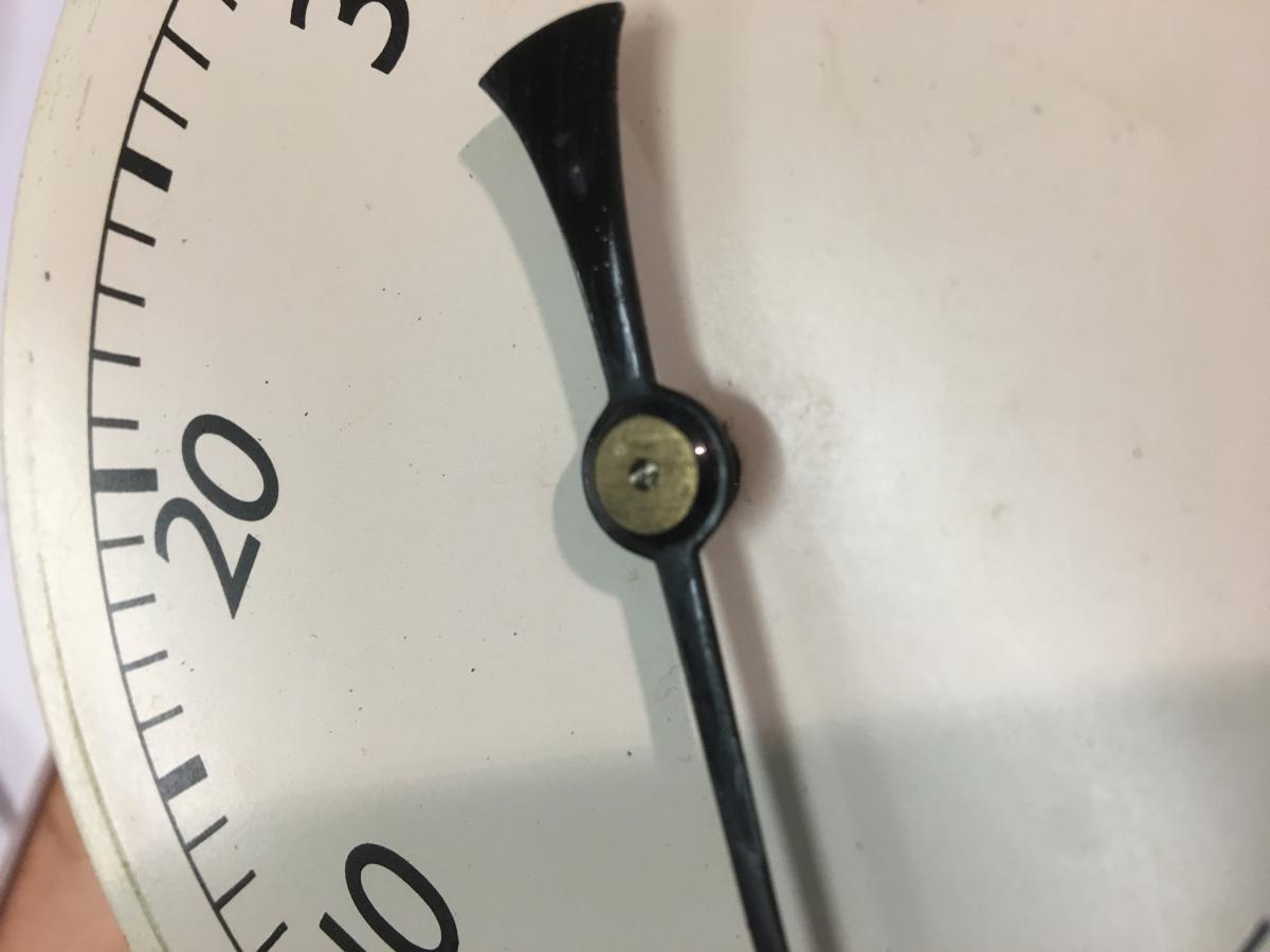

Does anyone know the correct way of removing the needle so I can refurbish the facia ?
I don't want to damage it with the Bull in a China shop method
Thanks
Chris
Ahh Flyboy that would make sense ... Thanks
Take care! some of the larger gauges like yours have a tiny cross pin, but that should be fairly evident if it has one.

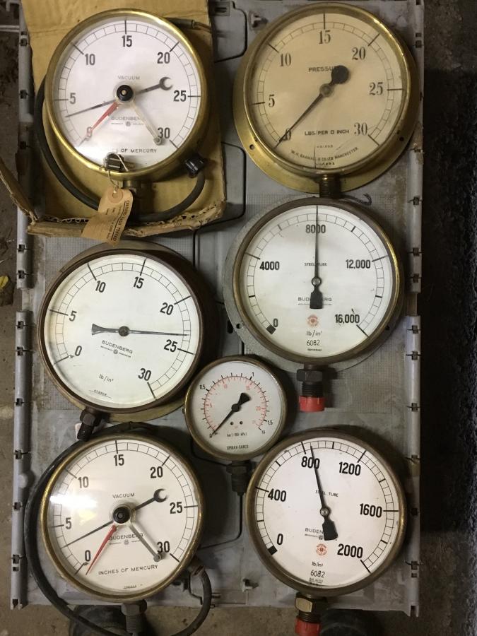

Clearing out some junk in my garage and found a box of budenberg gauges of various denominations
Two of them are rigged with alarm contacts, one has cracked glass and one no glass
Lovely things that might be useful to some one with a vintage machine of some sort
Hopefully the pic will work !
PM if interested or with suggestions of how to get them a loving home otherwise I'll weigh em in, the're heavy beastspost-14426-0-97469700-1478557150_thumb.jpeg
PM if interested or with suggestions of how to get them a loving home otherwise I'll weigh em in, the're heavy beastsattachicon.gifimage.jpeg
Thanks
Chris
Check to see if the brass part in the centre of the needle will unscrew. They sometimes do, and then the needle should just lift off. If the brass part is knurled, it will probably unscrew.
