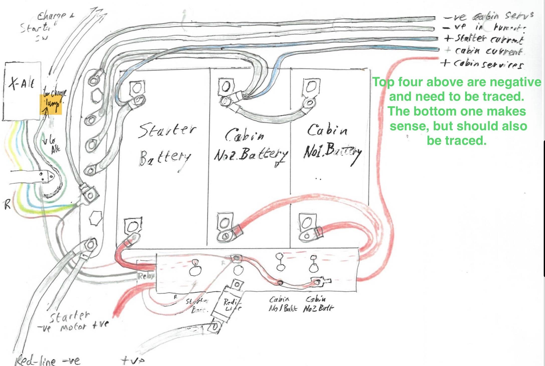

Just out of interest, here is a diagram that was left with the boat, there is a third cabin battery that's been added later.
 SScanner24111021480.pdf
A bit of a strange diagram to me. Although it's always a bit hard to understand someone elses thinking...
Thr alternator wiring doesn't make sense to me as o can't see where the main output is, their doesn't seem to be a thick alternator wire. And I don't understand the wires top right labelled  + starter  current and + cabon current both connected to the batt negs. Unless there is an ammeter or shunt somewhere... (even then they still don't make sense )
I'm assuming the box at the bottom with +ves are 4 isolators. If so worth checking the starter one, particularly if you switched it off whilst working on it.  The cheaper versions have a nasty habit of going high resistance when disturbed or failing for fun.
Personally I would draw my own diagram by tracing all the wires, that way you will understand it all.

The drawing seems generally ok apart from the top righthand corner.
Separate isolation of the cabin batteries is a bit unusual.
An X-Alt external controller is fitted to the alternator; the split charge relay (simply labeled "relay" on the diagram) appears to be controlled by the X-Alt.
230v ac (at least originally) is from a Red-line rotary converter. You may find that this has been replaced at some point by an electronic inverter.
The wiring will doubtless require some age related maintenance/renewal.

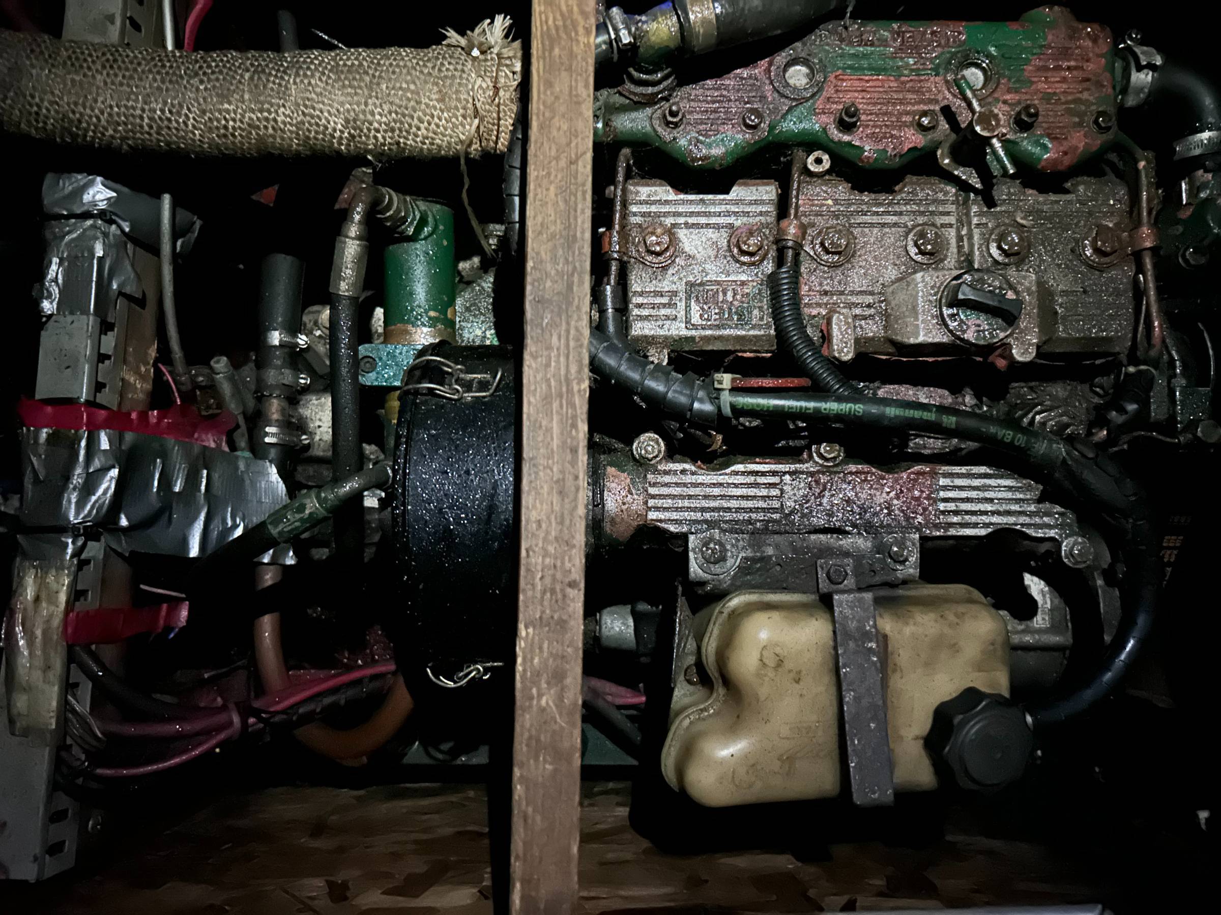

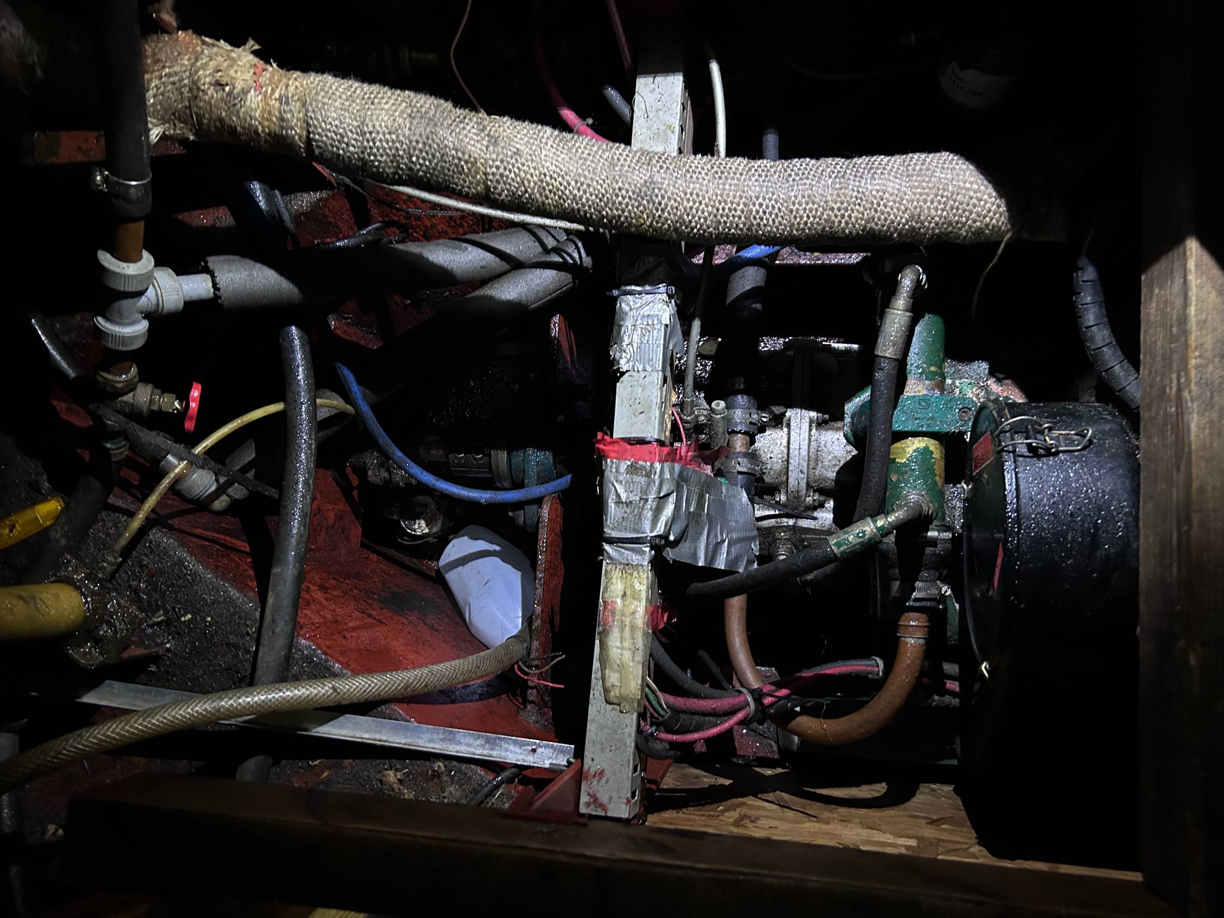

Here is a picture of the engine -

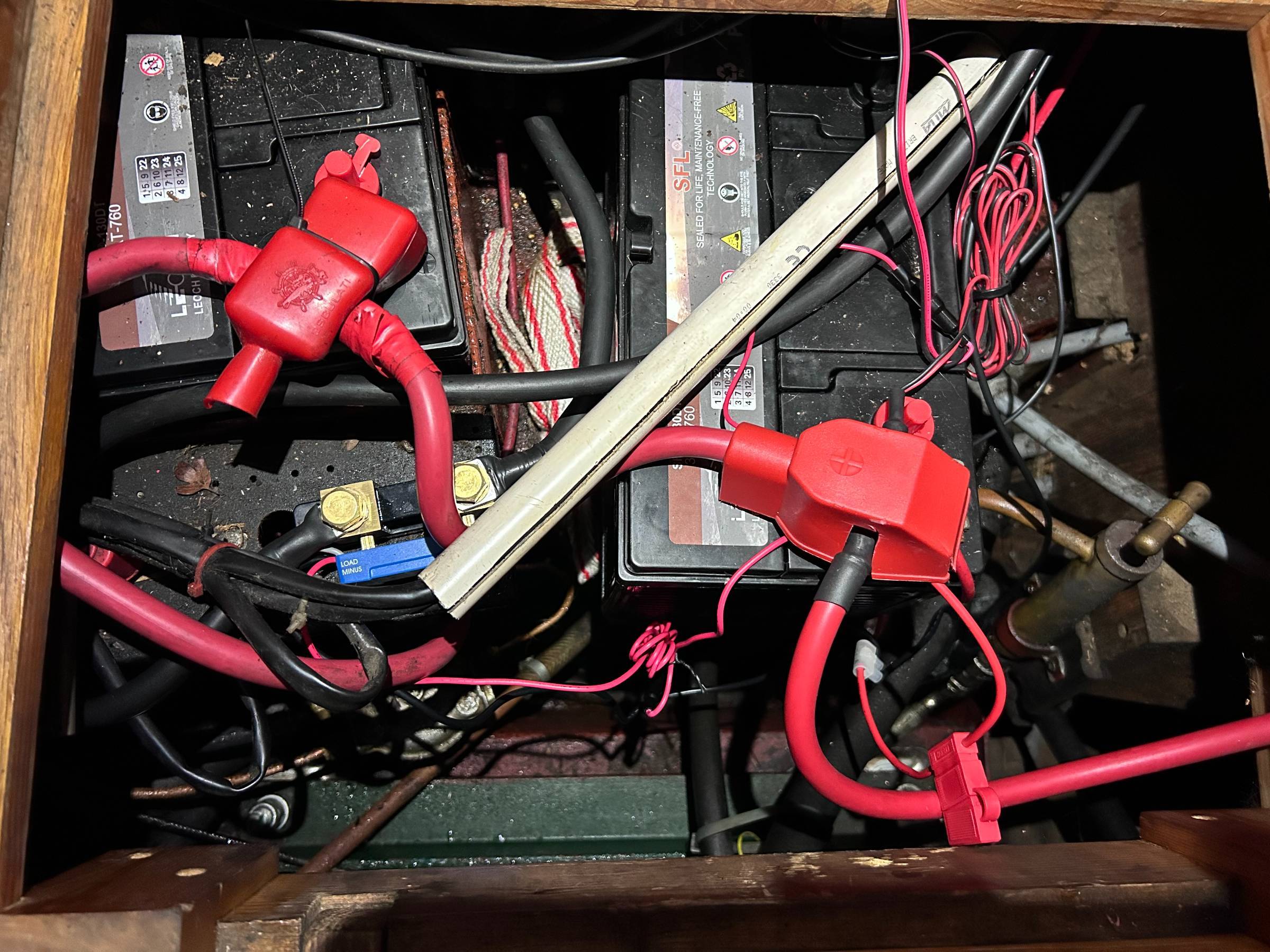

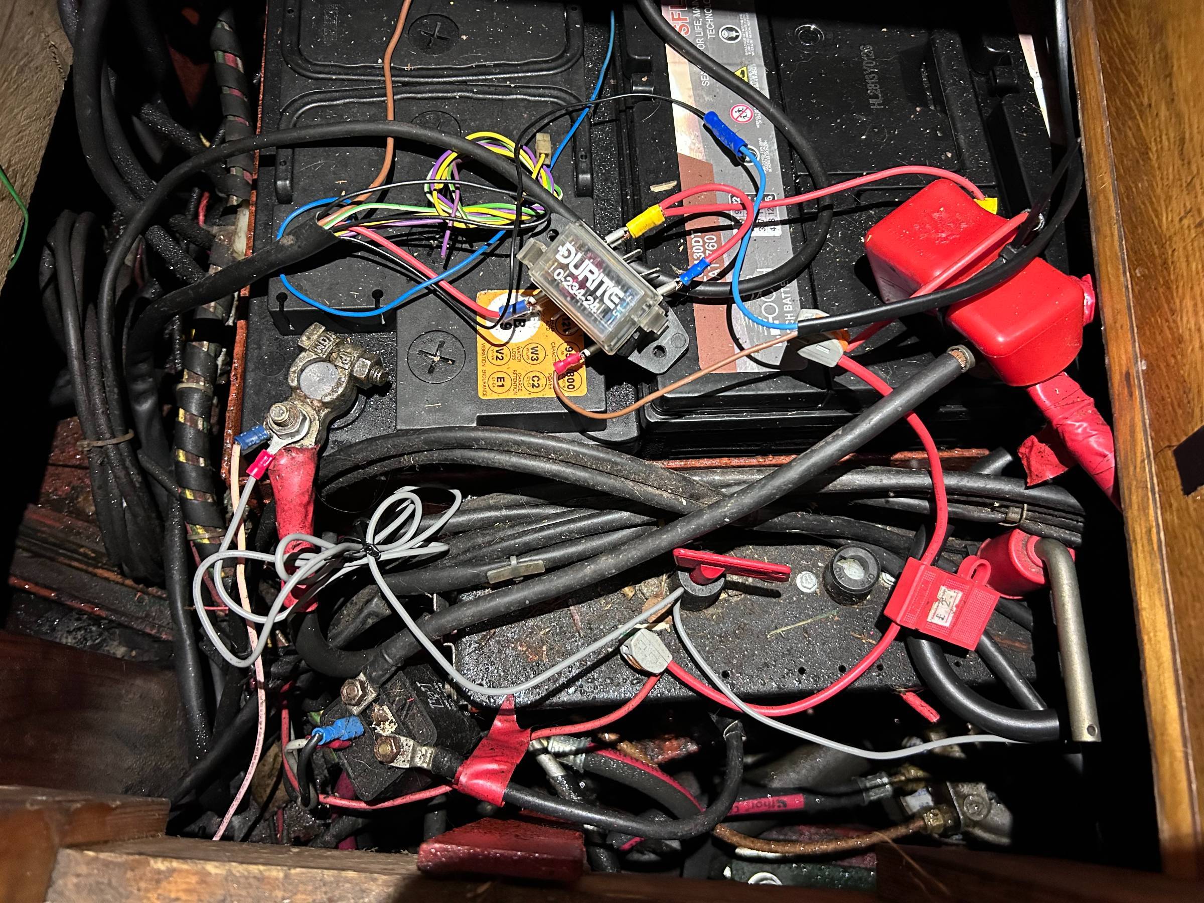

Starter battery and cabin battery 1 -
Cabin battery 2 and 3 -
It’s a 3 cylinder Lister Petter Alpha either LPW3 or LPWS3. Probably LPWS3 as I  would expect a heater in the inlet manifold for a LPW3. Does it have 3 heaters in the cylinder - one for each cylinder?
As Jonathan says there is generally a plastic multiplug connecting the loom( bundle of wires). It is definitely worth finfpding this it’s like a black plastic square bulge in the main bundle of wires. Pull it apart and clean the  contacts (aerosol of  contact cleaner helps) and reassemble. They do give a lot of problems on these engines

Can confirm by the photos that the engine is the LPWS3.
