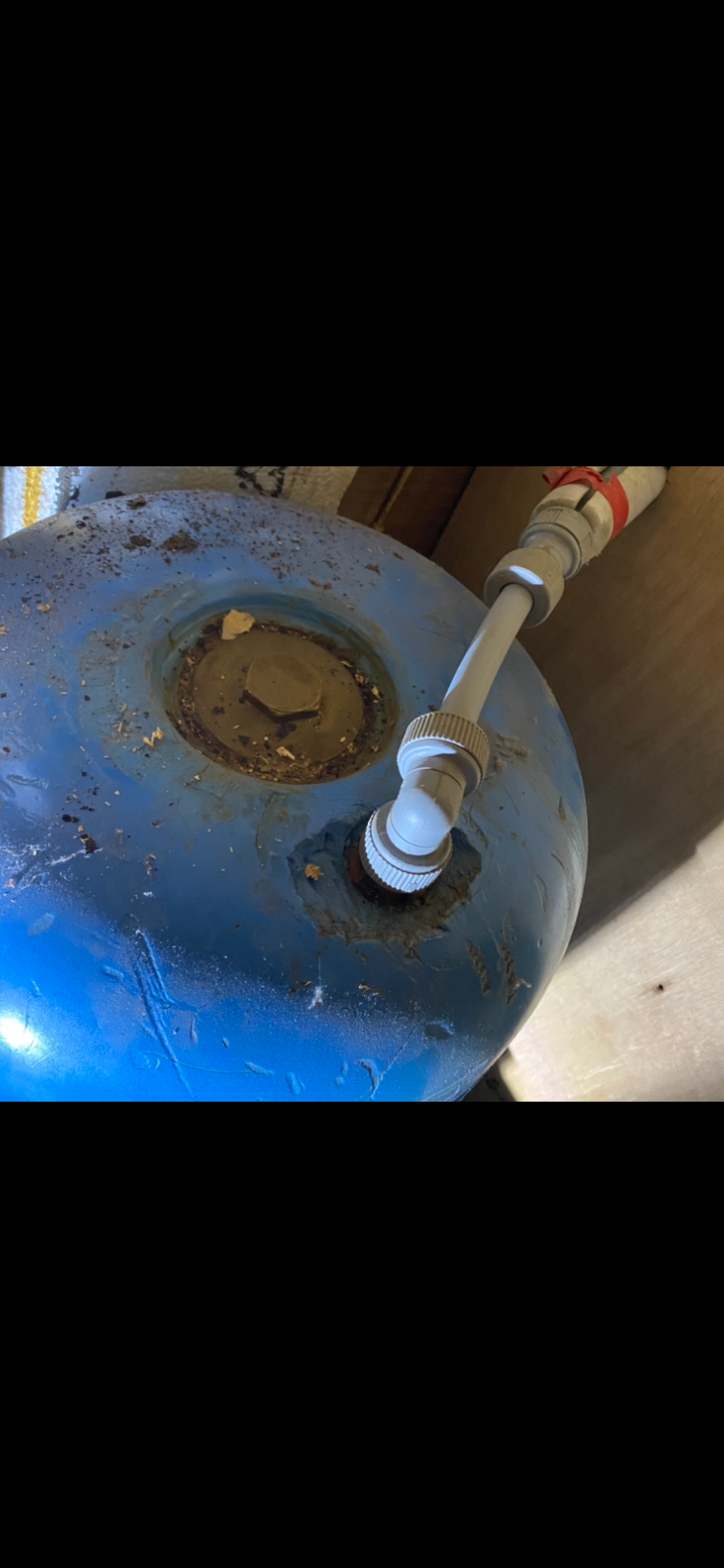

Thinking of adding 230v immersion element to our vertical calorifier for use when on shore power.
Have fitted a few on shore but never to a calorifier before. What’s the chances the big blanking plug will come out easily or are they prone to corrosion and Im likely to just damage the calorifier?
Any advice would be appreciated. Cheers

I would suggest about the same as a domestic one except the calorifier MIGHT be made from thicker copper so may be a little more resistant to damage.
Thanks Tony. It has a substantial hexagon nut on the blank that I could get a socket on unlike the elements themselves that require those awful box spanners.
Drain it down a bit so that the top is above the water level. Get the plug very hot, with a blow lamp. When it cools it will come undone. If the flange is soldered in, ( unlikely ) don't overdo the heat.
I removed the boss from mine without a problem (no heat required) and fitted an immersion, but I've heard some can be hard to remove and it's not that difficult to rupture the tank if you're not careful.
I had to find a lump in the insulation on my calorifier and carve the foam off to expose the boss, whereas yours looks like a better quality foam application. Hopefully that might suggest a better quality tank too, although why the builder would install it with the immersion boss at the top of the tank seems odd to me. Where's the PRV - at the bottom? 🤔

Thanks all. Will give it a go soon when the worktop is removed for replacement.
Couldnt get an element in there without the worktop off either.
My thoughts are:
1) Being brass plugs screwed into a copper boss they are not prone to corrosion.
2) The chances of it coming out are high, but not necessarily that easily.
3) Find an accurately-fitting box spanner or 1/2" drive socket for that hexagon, and a balanced T-bar to turn it. Don't try to do it with grips or Stilsons. Devise a way to hold the calorifier properly still whilst applying the loosening torque.
4) If it doesn't come loose first proper try, then heat it as Tracy described above.
Oh and 5), if you know who fitted it, ask them what sealant (if any) was used on it. Ideally none was used and the seal is a large fibre washer. This should come undone easily. Worst is if they plastered the thead up with Bosswhite and hemp.
The flange will be brass sweated/brazed into the copper, hopefully not soldered if it is original to the calorifier and not an addition.
If its been put in with red lead paint and putty you may never get it out!
I've read that you should keep the tank completely full to support the relatively thin copper skin while you first try to loosen the plug. Only when it has started to move (and maybe leak around the thread) should you drain the tank to below boss level.
when I put an 1.1kw immersion heater in my 1999 built horizontal twin coil calorifier. I bought a deep immersion box spanner and left the calorifier full but the water and pump off. a few taps with hammer to get more leverage and it was loose. have a few towels to hand.  This was 8 years ago. Dreading the day when the calorifier leaks. So expensive to buy.
Well if you have to heat it, the water has to be below. The rigidity of the copper is not improved by water, it just adds weight to prevent the calorifier moving.
Hard to heat it up much unless you reduce the water level to below the plug.
Yes the PRV is at the bottom🤷🏻‍♂️
A penetrating oil (such as  Plus-Gas if you can find it, or petrol lighter fluid if you can't) can help to release siezed screw threads.  If it doesn't work immediately, see-sawing the wrench to and fro can have the effect of  pumping the solvent into the inner turns.
