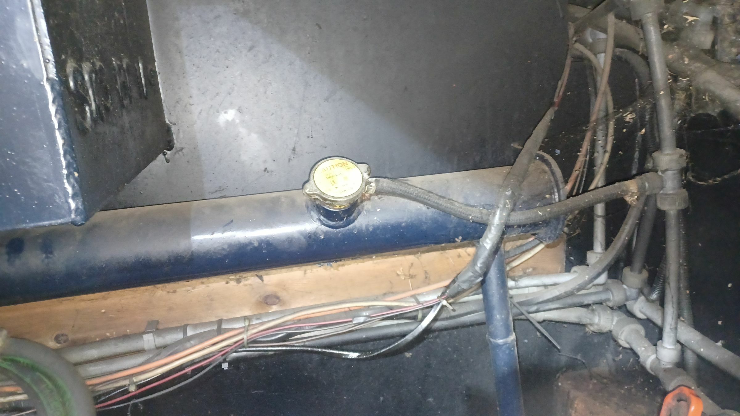

So this is a view from inside the boat looking aft?
That long tube thing with the pressure cap is on the bulkhead between engine and the cabin that is fed from the header tank, eber feed is next to it from the same header
This probably won't help much, but assuming the hose just below the cap running to the T where it joins the pipe running from the CH header tank to the Eber then I think it is only using the CH header tank as a convenient expansion tank. It looks as if the hose is above where one would normally expect the pressure seal to be located, allowing the engine to run pressurised but not the Eber. There is probably another seal immediately below the cap top, so if the engine ran short of coolant, it could send smell and steam into the CH header tank. However, that does not explain where the coolant is going.
Would it not suck it in as the engine cooled
It should until it sucked all the liquid out of the CH header and pipework, which I suspect may have happened, but why the engine temperature alarm/gauge did not show an overheat, I have no idea. This MIGHT be the result of a very minor coolant weep over a long period.

Going by the photo I think that they probably are - by the coolant pressure cap seal.

Mike, did you see my interpretation of the photo she posted?
I think the CH header tank may also be used as an expansion tank AFTER the pressure cap so not pressurised.  I think the CH tank is more like just a non-pressurised expansion tank as far as the engine coolant is concerned. No one has commented on this or tried to say I am wrong.
