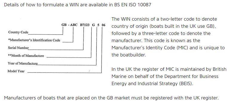

Alan de Enfield Posted December 4, 2023 Report Posted December 4, 2023 2 hours ago, ditchcrawler said: I didn't know that The screen shot of the HIN format (posted earlier in the thread) explains that a builder must apply to them for a builders reference.
ditchcrawler Posted December 4, 2023 Report Posted December 4, 2023 6 hours ago, Alan de Enfield said: The screen shot of the HIN format (posted earlier in the thread) explains that a builder must apply to them for a builders reference. Which builder is which, does the hull builder put it on with the fitter outs reference or his reference?, when is it manufactured, when the first steel is laid or when the boat is completed and passed to the owner, could be years apart
Alan de Enfield Posted December 4, 2023 Report Posted December 4, 2023 24 minutes ago, ditchcrawler said: Which builder is which, does the hull builder put it on with the fitter outs reference or his reference?, when is it manufactured, when the first steel is laid or when the boat is completed and passed to the owner, could be years apart This was discussed earlier in the thread - since the changes in the latest issue of the RCD / RCR a sailaway is now classed as a complete boat (as complete as the hull builder is going to make it) and it now has to have a HIN, all of the paperwork etc (I posted a list of requirements about 1/3rd of the way down page 3). As I said previously I do not know whever it retains that HIN, or if the 'person fitting out' (who now becomes the builder) has to apply for a 'builders ID' and if he has to give the finished vessel a new HIN. I suggested that if anyone thought they would be affected by this that they should call British Marine, & not rely on some strange fella on the internet that happens to have read a bit about it.
