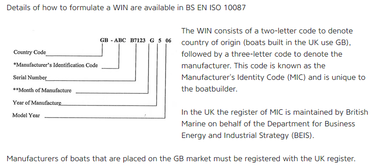

Midnight Posted November 29, 2023 Report Posted November 29, 2023 Prompted by another thread. I don't think Midnight has a HIN certainly no obvious builder's plate. Built by John White in 2002, but because of delays with extras wasn't delivered until 2003 as a 57ft shell. We spent a year fitting out on dry land before dropping it in the water and registering with British Waterays in August 2004. Never thought about a HIN until looking at the thread in General Boating about a reg number. Before I took delivery John White arranged for the shell to be spray-foamed so it's possible the plate is somewhere but covered with the insulation. It's also possible I just forgot seeing it as it is 20 years since the fit out was done. Would I have needed to have it when regestering for the first license? There's no mention of HIN on the My Trust page. Is anyone familiar with John White boats who could give me an idea of where to look?

Alan de Enfield Posted November 29, 2023 Report Posted November 29, 2023 (edited) 1 hour ago, Midnight said: Is anyone familiar with John White boats who could give me an idea of where to look? If you bought it as a sailaway, did you get the RCD approval to the stage it was sold at ? A boat (built to RCD compliance) must have the HIN / CIN marked in two places, the RCD specifies the 'public place' and the other should be in a hidden location only known to the hull builder. From memory the 'public' HIN / CIN must be made so it is incapable of being removed (ie stamped into the hull) at the stern on the starboard side. Typically it should be on the 'outside' of the boat, but I have known of them 'inside' the transom. The builder should be able to provide you with the HIN from their records (I don't think they are supposed to divulge the hidden location as you could have stolen the boat and tamper with the marking). The HIN should also be specified on the Bill of Sale, the Declaration of Compliance and in the Owners manual. Example of the HIN on the Declaration of Compliance (under technical data) The format should be : Edited November 29, 2023 by Alan de Enfield
