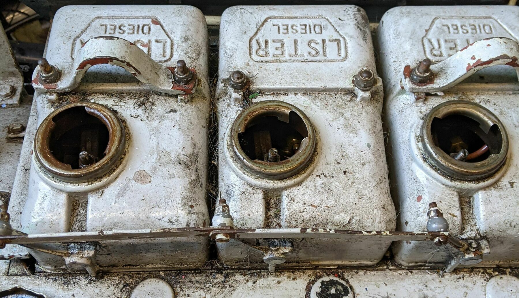

I wouldn't be taking the injectors out at this point. Surely if the decompressors are doing their job the oil in the bores will be shoved out when turning the engine.
The visible tappet screws look funny but apparently they have not been adjusted.

It sounds to me as though the engine is hydraulically locked with oil in one cylinder. This would explain the failure of either the starter motor or the raised hand start to rotate the engine.
I think the decompressors have not been properly engaged. With the three linked together like that, tey won't be "that bit stiffer" as Tony suggests but three times as stiff as a single compressor operated in isolation, and a lot of force will be needed to compress the three valve springs all in unison. My gut feeling is the OP is being far too timid with it. Give it a really good shove over. Also, if one cyl is hydraulically locked, opening the decompressor on it might be nigh on impossible due to the fluid pressure in the cylinder.
The decompressor arms do bend I have seen snapped ones so caution on the force.
It did make me nervous when the OP said they 'adjusted the decompressors'. I'm sure someone has adjusted the visible tappet screws. They look wound out but perhaps its normal.
From OP "but as a friend pointed out last night, after adjusting the decompressors when it first happened..."
If someone had been tightening or loosening the screws visible on the image it would cause problems.
The slots are showing signs of force from a screwdriver.

Of course it could, and with that length of thread showing, they may not even be lifting the valves. The OP needs to look down the holes and make sure he can see all three valve moving downwards as he moves the decompressor lever. That is apart from any that are held down by the camshaft etc.
Although brutal and not to be recommended, I think he could turn the engine BACKWARDS by a pair of stilsons on the splined extension shaft that may stick out of the camshaft. If it is the starter, that may be enough to free it. That way at least he knows it will turn backwards. Note to OP, it will not be easy to turn because  it is geared up to the crankshaft, but by going backwards you should not hit compression for maybe 3/4 turn.

I think I know what you mean the part you are referring to is just about touching the back wall and I think I need a pin spanner or something as do not want to damage the metal .I will post a picture!
Ah I have done that in the past when trying to start the engine after a fuel clean when I first got it (it had diesel bug) however it worked and the boat was running great until the oil accident on Sunday ..what should I do in relation to them now?

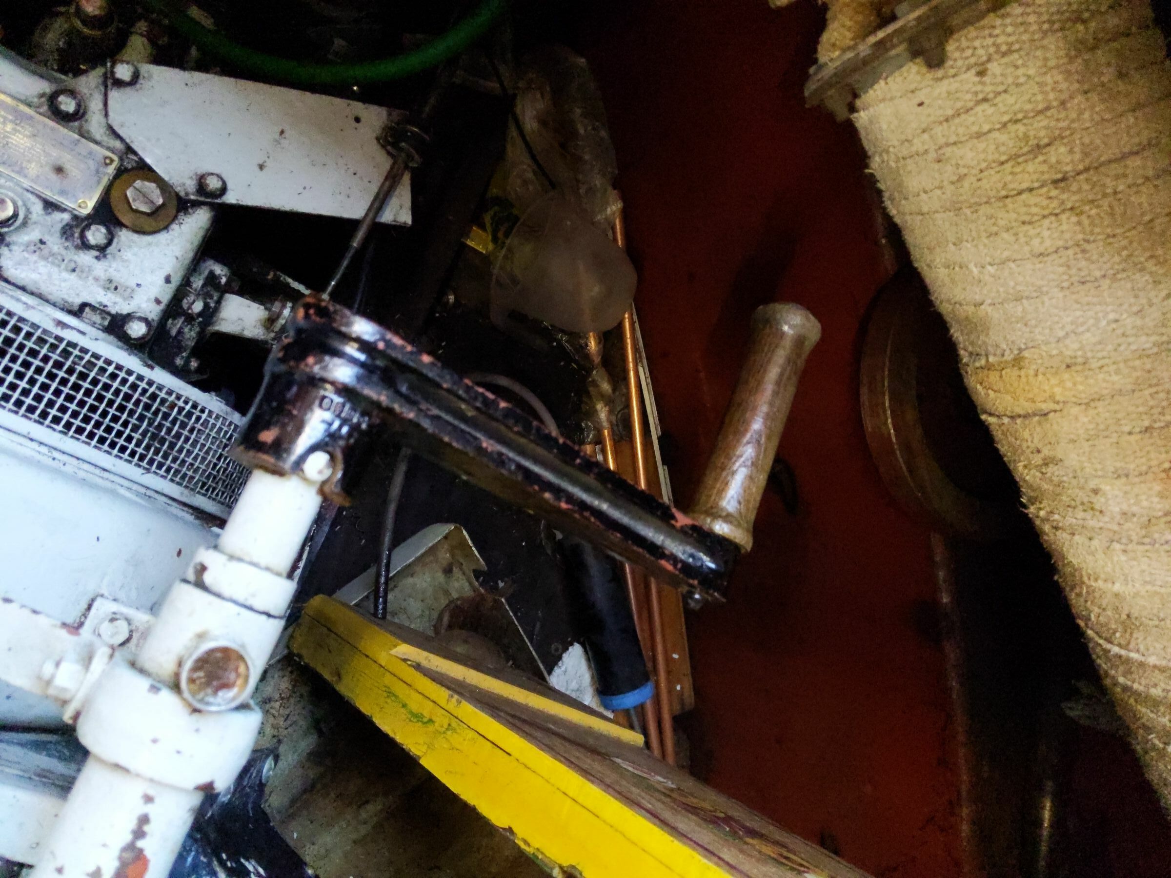

Also can you upload a picture of the starting handle that came with the engine.

Another possibility is that someone has loosened the nuts holding the rocker covers down perhaps thinking they might want to remove the covers to have a look.
If one were to loosen these nuts while the decompressor levers were in the position where they are acting on the valves the effect would be to defeat the decompressors because the levers are fixed to the rocker covers.
When tightening or loosening the covers the decompressors must be in the non loaded 'run' position rather than the 'start' position where they will be loaded by the valve springs.
I agree this is possible. It might be sensible to disconnect that linking bar so the three decompressor levers can be operated independently. Lift each one to the full extent possible. They should all open the same amount, but if one lifts less than the other two that could indicate a problem with the relevant cylinder. Even so you could then try turning the engine over on the handle again to see if you can get any movement in the forwards direction.
I think this should be talking about each compressor pushing the relevant rocker/valve down by the same amount. The lever may well move through its full travel but the rocker may not. The only exception would be if one decompressor was trying to push the valve open too far so the valve hit the piston at TDC. Then the lever would not move as far as the others.
I want a picture of the starting handle.
Hand starting is hard work if you try to do it with your hand ;) It won't budge an inch but would turn nicely the other way.
Ah you suspect there is no starting handle!
Only as a joke.

Also, before I started turning it with the key the hand crank allowed me to move it about an inch and it turned the flywheel I could hear a clunk when I did it.
