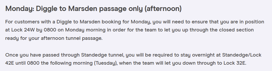

You can't go to Diggle on Day 2, you have to moor overnight below 24W going up, CART then take you up and through the tunnel from there the following morning.

https://canalrivertrust.org.uk/places-to-visit/standedge-tunnel-and-visitor-centre/boating-through-standedge-tunnel
They must not of incurred a water shortage yet. Is there other space to moor up there other than the tunnel moorings? I did note they had winter moorings there this year.

Site Information
For Marsden to Diggle passages, please arrive at the Marsden tunnel portal for 8:00am on the morning of your passage. You may moor up beside the tunnel entrance after 5pm the day before your transit, but not before.
For Diggle to Marsden passage please arrive at the Diggle tunnel portal for 11:30am on the morning of your passage.
Please note that the tunnel keepers may measure your boat prior to entry to the tunnel.
Petrol engines and fibre glass boats cannot pass through the tunnel.

Email screenshot
CART say you have to stay above 42E (Marsden top lock), we moored just above it outside the pub so I assume this is still possible.
I believe the information you showed is out of date, the one I posted is up to date.
I expect that means that if you're at 24W by 0800 you *will* get through the tunnel because the CART team will make sure you do.
That's a level of detail that isn't present on the notice on the stoppages site (unless I've not read it all).
It doesn't really matter because the trip is definitely a weekend start from the Marple area (I'm eying up New Mils for proximity to the railway station) and midweek through Standedge. There's time either way providing I'm at least at 24W by the previous evening.
ETA - is the discrepancy because your information is literally current (albeit moot because the canal is closed) whereas I'm reading the notices that apply for the 2023 season that is yet to start?
Edited by Captain Pegg
Info I copied from my booking email. I have emailed them with your link asking to confirm this years procedure. I will update the thread with their response

21 minutes ago, Captain Pegg said:
I have to say that in planning a trip it does feel like CRT make things off-putting.
At present the CRT website suggests there are no passages over the eastern L&L after this week. I'm sure that's not the case but it does not give confidence that I can reliably plan to spend three months doing a big ring across the Pennines and back. And that's before I consider it hasn't rained much this winter. Well not in my part of the country anyway.
ETA (because the software has merged my responses):
So this business about locks 24W to 32W seemed to apply to morning passages.
At present the west to east passage is only available in the afternoon so boaters make their own way up to Diggle by 1130.
Again that gives a bit more time to get there and given there will be very long hours of daylight I'm sure I'll manage.
