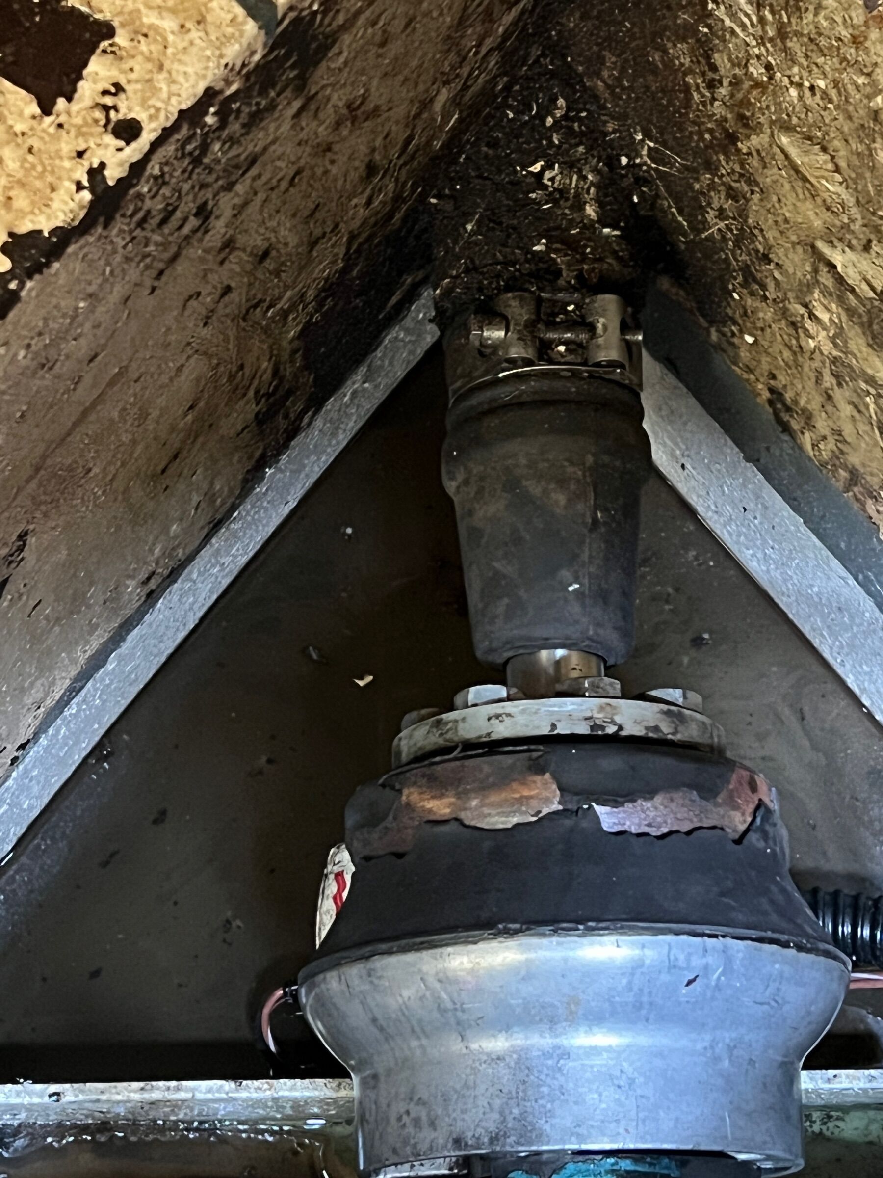

This morning’s adventure is… failed coupling. Forward/ reverse shift works but no propellor turning. Failed as I was nosing into a lock. No noise, no nothing, just works fine, as normal, then nothing. Managed to haul it out of the lock by rope and now waiting to see when someone can get to me.
Why am I waiting for someone? Because I spent a lot of money to have all this sorted and this is day three and she’s broken down twice.
Hydraulic gearbox short of oil?
Can you see a broken coupling between the box and shaft?
I sent a video of the engine running, with forward/reverse shift being used to the engineer. The engine side is fine.  But no rotation seems to pass to the prop. He said, “impact”, but there were none. No anything other than suddenly no propellor.

If its the drive plate between the engine and the fly wheel the boatyard have no way of establishing when it would fail, no service would find this.
I will ask again, can you see a broken flexible coupling behind the gearbox and before the prop shaft?

If it is a flexible coupling and its torn out of shape, its likely that the prop picked something up going into the lock and it has failed due to age and stress. A phone picture would be good.......................

That was taken with an iPhone. Can do another. Can send video of it running.
Got it. Centraflex coupling failed.  that will cost you.
Cost me how much?
Presumably the shaft from the gearbox turns but the shaft the other side of that big flexible coupling doesn't.  That almost certainly means the coupling is broke and I don't know if there is any repair possible. Personally i would look for an alternative coupling, those things are dear.

Depends on the shaft diameter but they are heading towards £400 inc vat.
To change it to a cheaper coupling would be no cheaper as you would need new gearbox and shaft flanges to fit say an R&D flex coupling.

R&D Marine 202-165C 4" Propeller Shaft Coupling for 25mm Shaft (asap-supplies.com) Something like this but it is not a flexible coupling so you would have to be meticulous in aligning the gearbox and shaft. Speaking of which I do not recognise the rubber bellows and stern gland - someone else might and if you are lucky it will accept a bit of misalignment. There are other alternatives as well so the hugely expensive Centaflex is not your only option.

Your shaft is bigger than 25mm. At a guess it will be 1 1/4"  or 1 1/2"  unlikely to be a metric size judging by the age of the boat and its condition.
  That quoted by  Bee  is just the bit that goes on the shaft, you would also need the flexible drive part and a flange for the gearbox, bolts etc.  Much more than the Centaflex  coupling.
