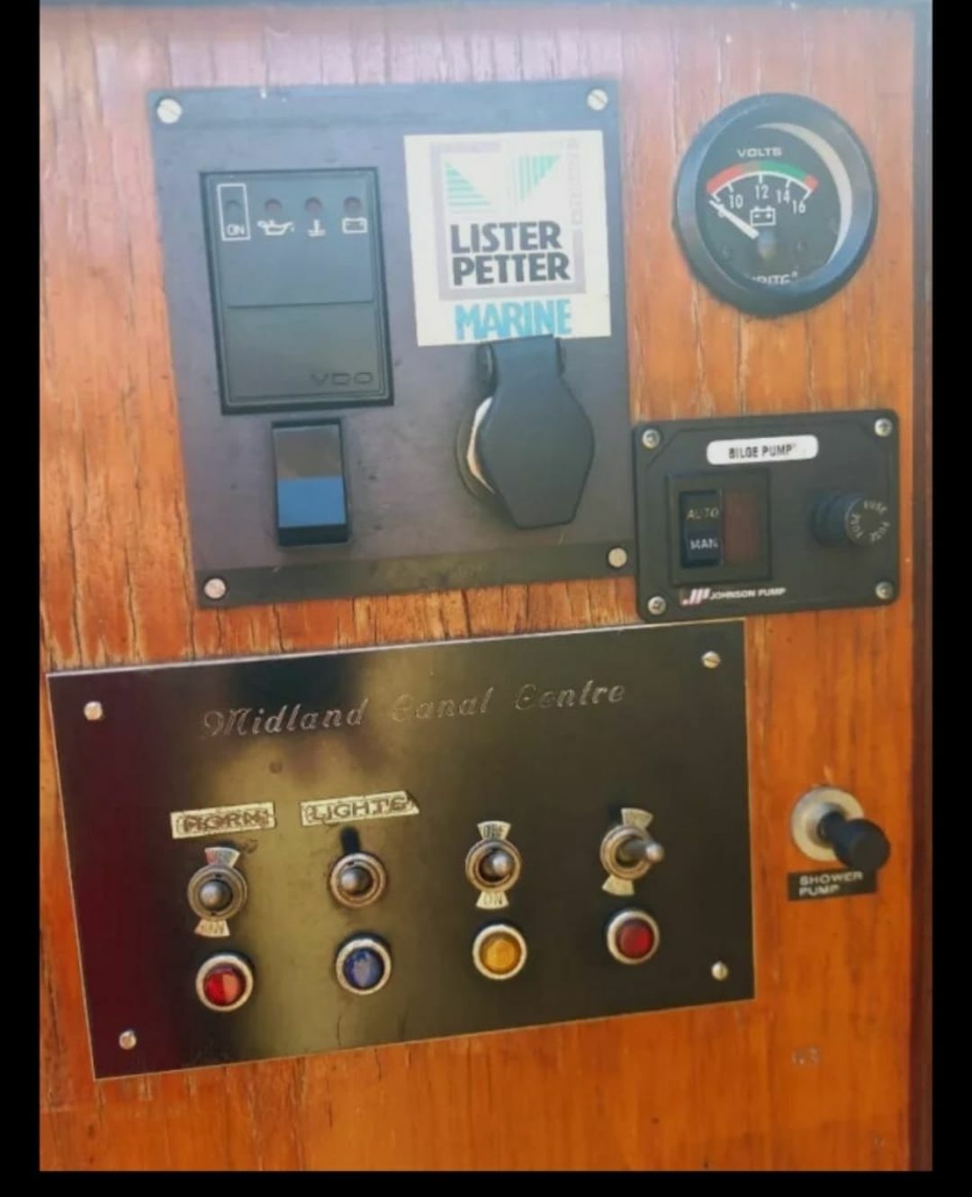

Pretty sure mine used to do that. A picture might help. If it's like my one, it's a group of 3 LEDs, not bulbs.
Yes that's right they're leds

Also check the multiplug (if you have one).
I seem to recall my lister has two of these. One behind the panel, and one down near the engine.

I also recall there is a capacitor and a resistor that connects to the rear of the control panel. Maybe worth looking at them after the multiplug.
Good thought, they could be part of a pulsing control. However, I am still mystified as to why one of the LEDs will not go out.
I view the flashing as needless marketing complication, not that the OP has any option. As I said in a similar topic, if nothing is obviously wrong, once I had checked the senders and alternator I would fit lamps with bulbs in them (not grain of wheat bulbs though).

But given we know it is not connected directly to the oil pressure switch, it seems probable the (unnecessary) electronic interface that generates the pretty flashing is prolly busted.

Good idea. I wonder how easy that would be to do in practice. I really don't like the LED setup on our system. Something simpler would be much better.
Yes, it is, but if there is a warning buzzer then it complicates things a bit because they need diodes as well, but you can sort that by using separate buzzers for each lamp.
