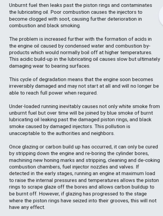

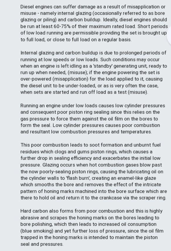

Steve56 Posted May 13, 2022 Report Share Posted May 13, 2022 Here is a write up on bore glazing if it is any interest. It is talking about generating sets but that makes little difference as it is the low load factor that seems tocause the problem. Link to comment Share on other sites More sharing options...
