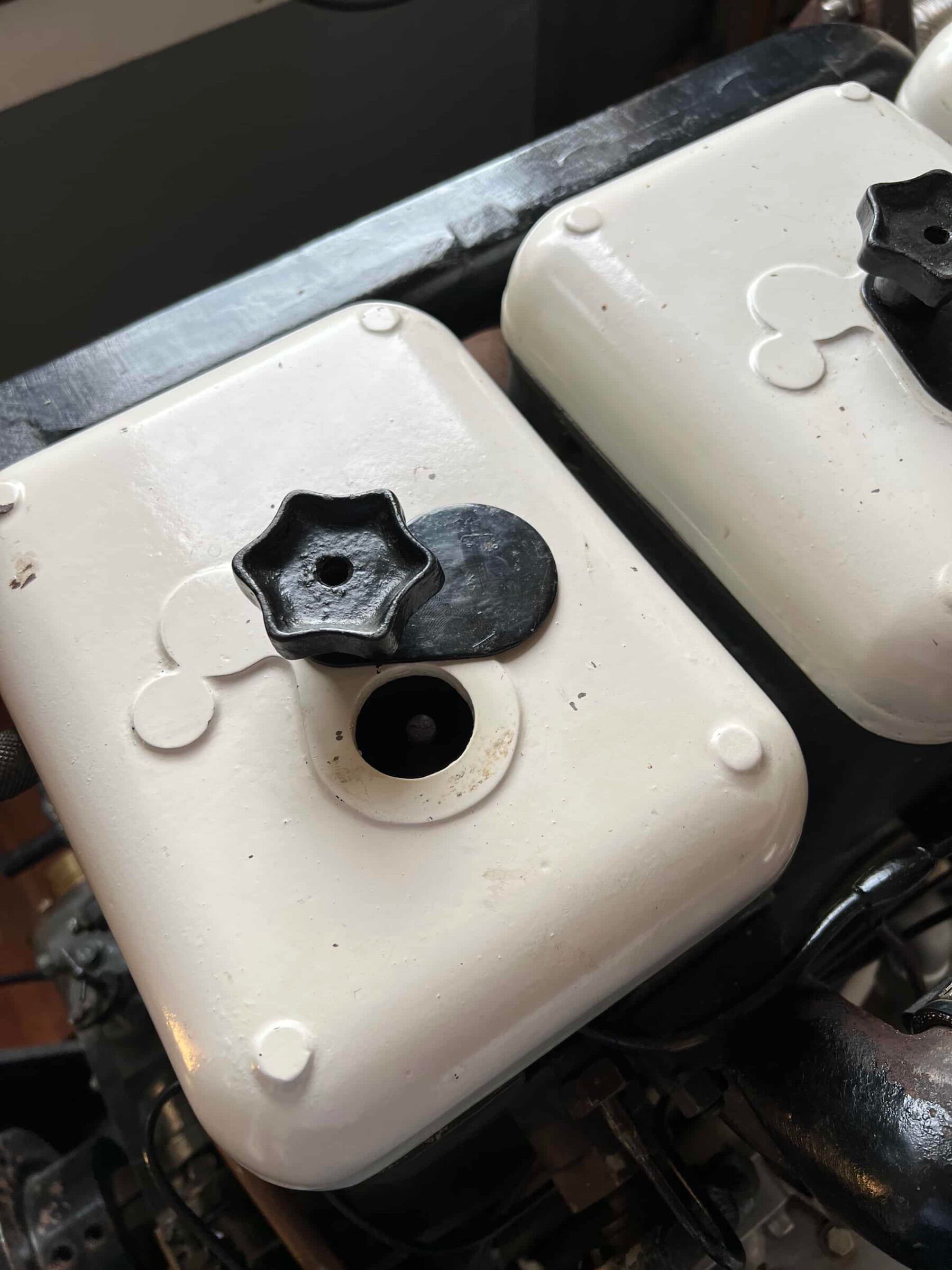

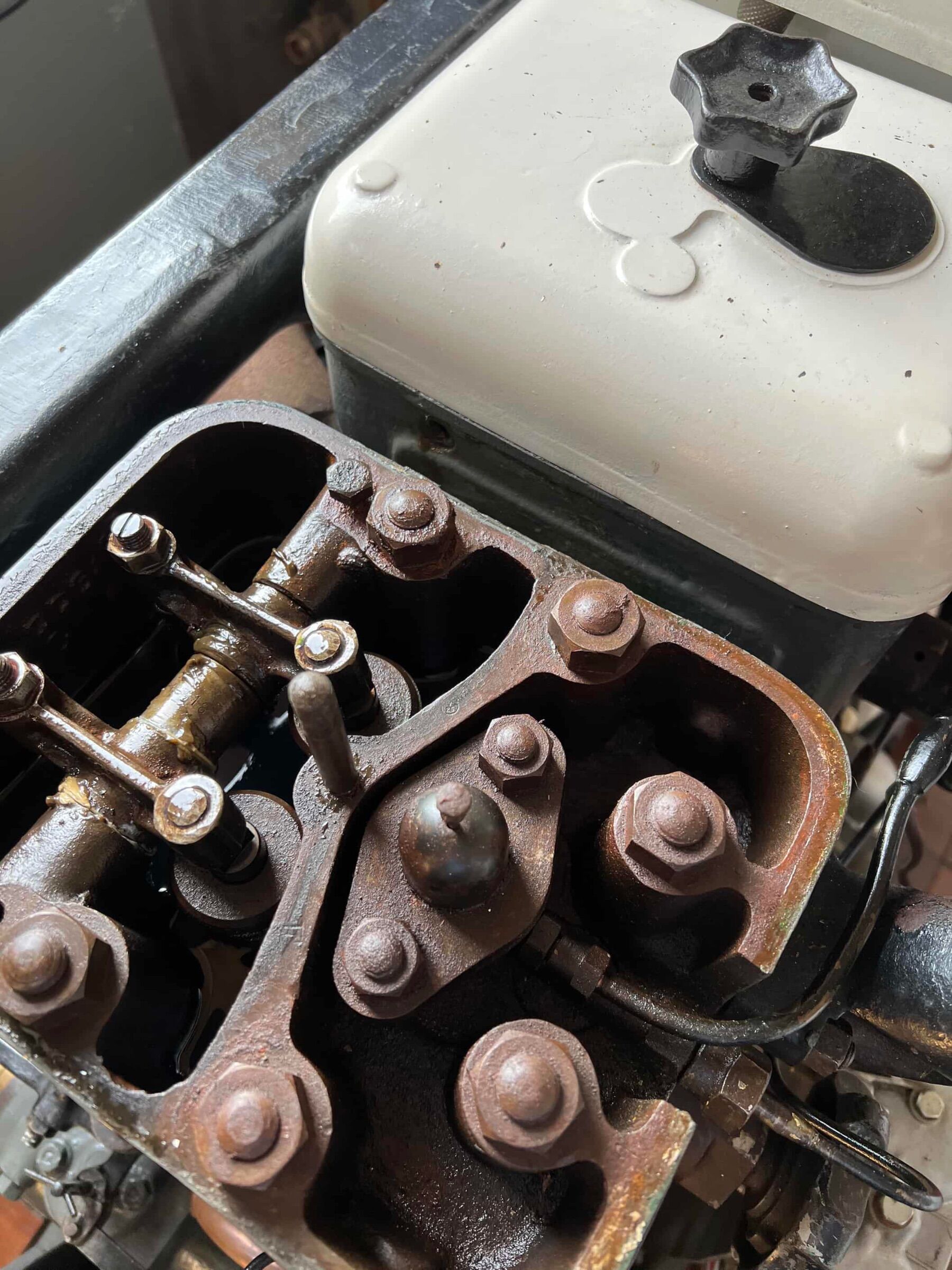

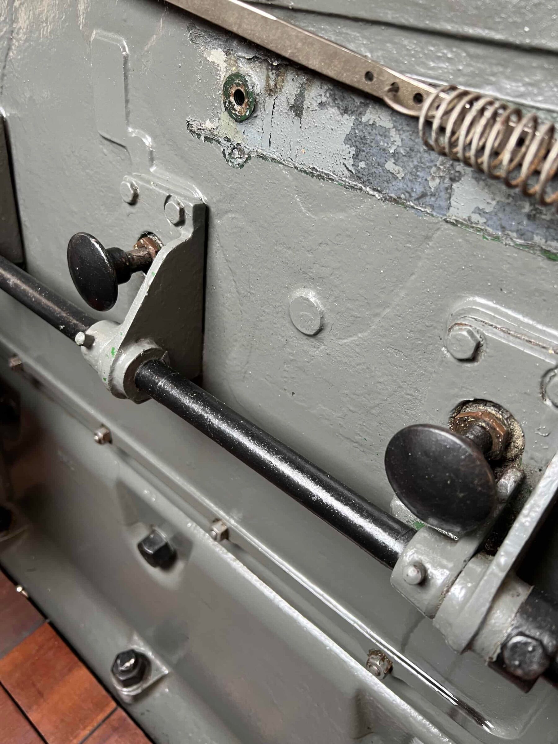

While I’m here… My decompression valves are on the side of the block, not on top as I often see online. On top I have a small inverted bowl with a pin through the centre (accessed through a hole in each valve cover). Should these pins be set in any particular position?
'Mushroom' decompresser knobs on the side of the block are found on older JPs. The decompressers on the rocker cover appear on later engines.
Oilers? Photos would help.
Photos attached.  They show the decompression levels and the ‘bowl’ The bowl is over the injectors so in a separate chamber to the valves.
That dome is the top of the injector. As far as I know the pins don't need to need 'set'. But if you put your finger on the top when the engine is being turned over you will feel when the diesel is being injected.
I assume that it is/was an industrial version as they generally only have the mushroom decompression buttons, and i think those sliding covers are to allow oil to be squirted in - much better to remove the rocker covers though. Judging by the rust and generally dry look of the valve gear side, you need to oil the springs, rockers and shaft assembly as the grease only feeds the shaft bearings. It is normal to leave a pool of oil in the section where the springs sit.
I have two manuals but neither show the configuration I have. The rockers are in a separate compartment to the injectors and are well oiled. I do remove the covers and pour oil over the rockers and valves pre-start so no issues there ( I think the picture makes it look dryer than it is). The section which covers the injectors and pin has no (visible) moving parts.  Looking at the picture I have realised that the top fuel line that heads to top-right of picture is an overflow line. The fuel-in line is the one with the large nut. Is it possible the pin controls how much fuel is released?
No.  The pin is, as David M says,  for feeling the injection occurring.  Steamraiser may know more but I think they are known as an injector feeling pin.  They can be found on other makes of engine but generally are a pre WW2 fitment from the days when making injection equipment was not a well developed art.
Put your finger gently on the pin while the engine is being cranked and you will feel whether the fuel system is properly bled, and, with experience, you can diagnose some maladies of the injection pump and delivery valve.

Long time since I've done it, but from memory if the injector is working nicely you feel a sharp jab from the pin as the fuel is injected (i.e. once every two revolutions of the crankshaft), but if the injector needs bleeding you either feel nothing or just a very slight  weak movement.
Yes,they are called "feeler pins" in the parts list..........if the system is working at peak efficiency ,you should feel a "creak" as the motor is slowly turned over....hear it too...........later JPs have grease cups on the rockers ,which I fill with pure MoS2 /moly dag..

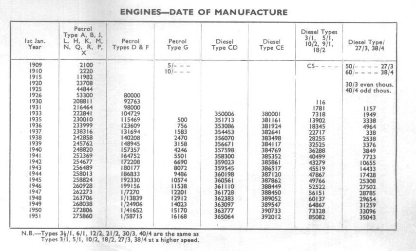

Lister used to produce engines to a 'build number'.  If you can find the list each build number was associated with features of the engine, such as speed, rated output, marine or industrial configuration etc.
I have the technical manual, which gives details of build numbers for later engines, in the era of the HR etc. but not for the JP and JK or JS.

Not sure why I said 1950.  1944 is my estimate based on the attached. Engine number is 60/20579. I think it is likely that it was originally a generator. Prior to installation it was pulled apart for rebuild and the ring/bores etc were apparently in a new condition suggesting that she either saw little to no use or had been completely rebuilt.  I know that the Gardner in my Dutch barge came from a hospital during the Thatcher era clean out. Again, never used.
