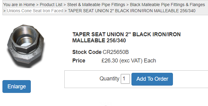

Somewhere in the exhaust you will need to fit a union ( a particular type of fitting which is designed to be separated easily) so that you can assemble the exhaust and disassemble it in future

All sorts of nits here Boat Exhaust System Components (midlandchandlers.co.uk) then you will need at least one of these
And big spanners or a proper pipe wrench!

You don't need a union if the exhaust manifold has a bolted on collar for the outlet but it makes it easier to take the exhaust off again in 5 years time!
