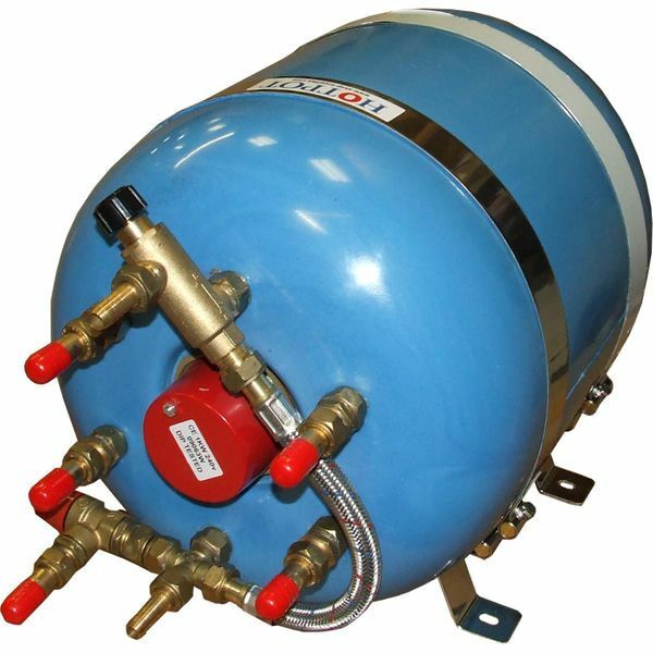

There is often one on the top of the calorifier turn it right down and you will get cold water out ;)
Its the black one in this picture the red one is the PRV

The most common type looks like this. Very hot water from the cauliflower, mixing in cold water to a set temperature. If there is no hot in, possible it may flow cold. Don't know, never tried it.
