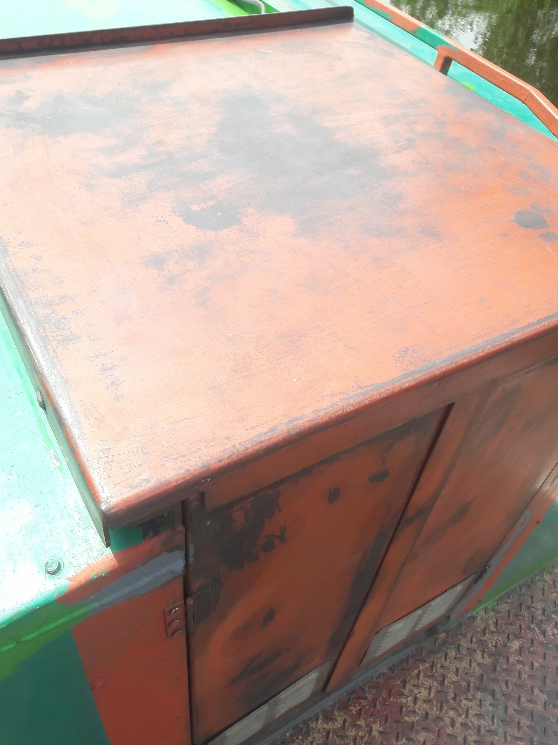

I'm dealing with the rusty spots on my boat, following Craftmaster's approach (6 coats!), but I notice the steel of my doors and roof hatch seems to be different, as there is only a thin layer of rust (the picture shows after sanding and fertan), and it looks like only 1 paint type has been applied. That makes me wonder: is there a less corrosive steel (obviously it's not stainless)..? And if so, should I do the same and apply just a coat or two of red oxide or something..?! Sounds too cheap to be true... I do have spare craftmaster to deal with it if necessary, but I don't want to overdo anything!
