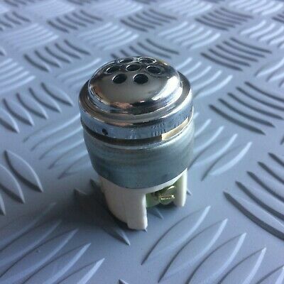

Attached is what they look like, before the chrome burns off and it gets all rusty.

Only think I can think of is that the indicator is actually a series resistor indicator for the plugs, as used on some tractors and old Pentas (I think!). The plugs' resistance is low when cold, drawing lots of current through the resistor, causing it to glow red. When the plugs are hot, their resistance increases, current decreases and the series resistor doesn't pass enough current to glow.
As it's in series, if it blows, then you lose power to the glowplugs.
That is  a possibility but in this case I feel a remote one, and I seem to remember those indicators get hot in use and did not glow as bright as a bulb type warning lamp. I have not seen one on a boat with a modern engine but that does not mean there aren't any though.

I had one on my Isuzu engined Liverpool boat which someone had bodged another control panel into. It would glow bright orange, but not visible in sunlight at all and if it got wet it would sizzle and pop. Replaced it with a relay very quickly!
Thanks, learned something new. That seems to confirm RCR's diagnosis.
