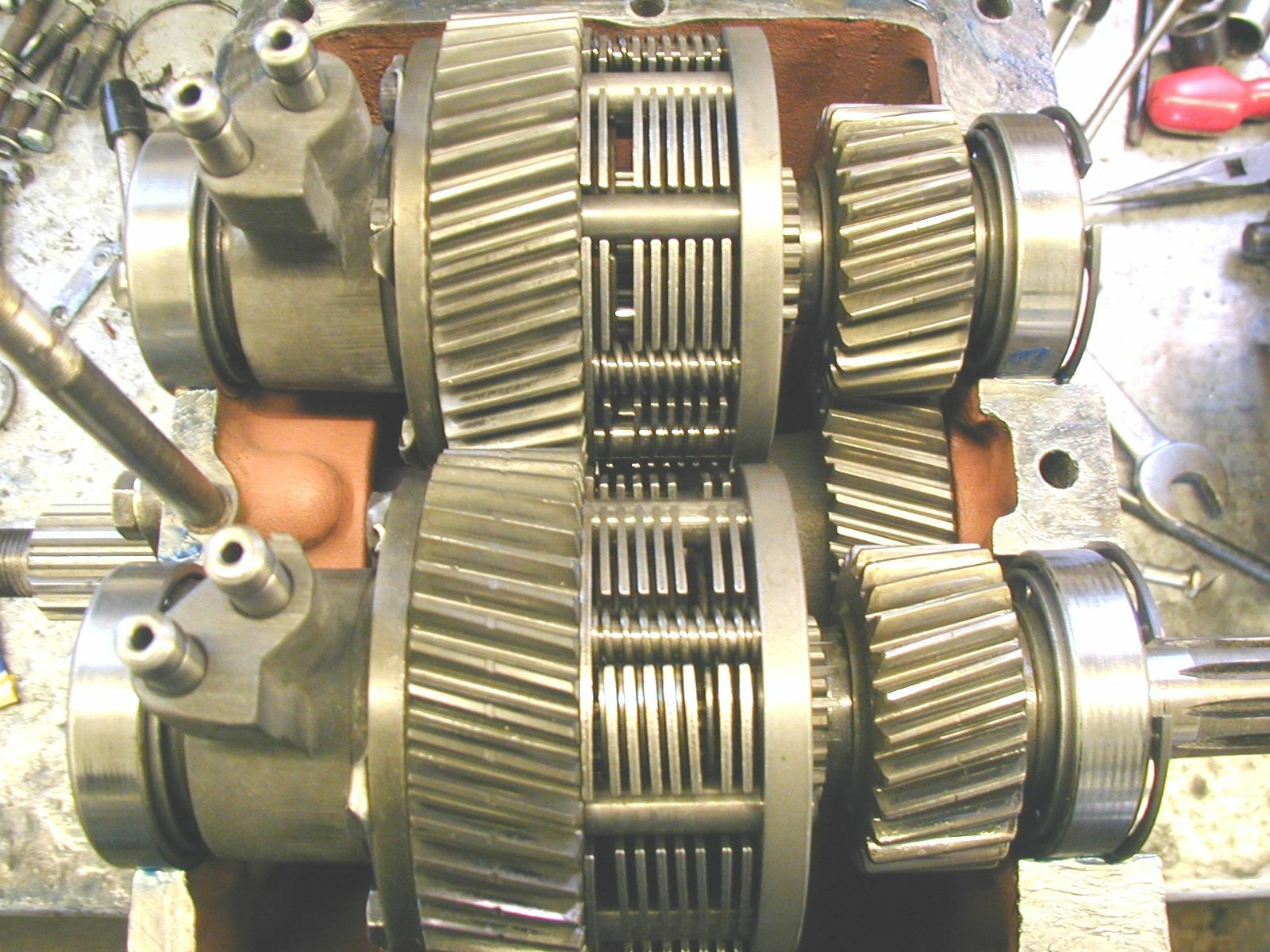

dmr Posted October 12, 2021 Report Posted October 12, 2021 Our 260 is just coming up to 20,000 hours. It was stripped a couple of years ago to fix an oil leak but no parts, not even the clutches, needed replacing. Keep the oil topped up and change it every 600 hours and all should be well. Maybe the low oil level was giving marginal engagement??? but this does not explain the delayed recovery.

David Schweizer Posted October 13, 2021 Report Posted October 13, 2021 16 hours ago, dmr said: Our 26o is just coming up to 20,000 hours. It was stripped a couple of years ago to fix an oil leak but no parts, not even the clutches, needed replacing. Keep the oil topped up and change it every 600 hours and all should be well. Maybe the low oil level was giving marginal engagement??? but this does not explain the delayed recovery. The PRM 260D on Helvetia was strippeed and inspected when we had the engine re-built at 23,000 hours. The engineer could not find anything that needed replacement, so apart from new gaskets and oil seals it was simply re built. Prior to the rebuild I spoke to PRM who assured me that with the set up and boat I had, the gearbox would outlast me (even if I was only 21)
Tracy D'arth Posted October 13, 2021 Report Posted October 13, 2021 7 minutes ago, David Schweizer said: The PRM 260D on Helvetia was strippeed and inspected when we had the engine re-built at 23,000 hours. The engineer could not find anything that needed replacement, so apart from new gaskets and oil seals it was simply re built. Prior to the rebuild I spoke to PRM who assured me that with the set up and boat I had, the gearbox would outlast me (even if I was only 21) They are British engineering at its superb best. The previous PRM 160 was good, unless you got water in it when the "cardboard" clutch linings would disintegrate. 260 and 280 use bronze I believe, certainly not paper based.
David Schweizer Posted October 13, 2021 Report Posted October 13, 2021 2 hours ago, Tracy D'arth said: They are British engineering at its superb best. The previous PRM 160 was good, unless you got water in it when the "cardboard" clutch linings would disintegrate. 260 and 280 use bronze I believe, certainly not paper based. I agree. PRM stands for Percy Riley Motors set up by Percy Riley, unsung engineering genius behind the design and manufacture of Riley cars from 1913 until his untimely death in 1941.
