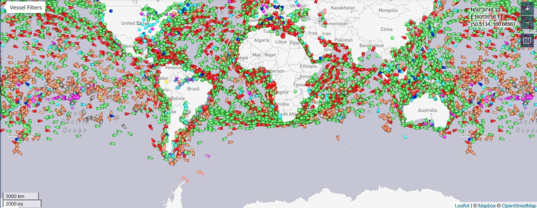

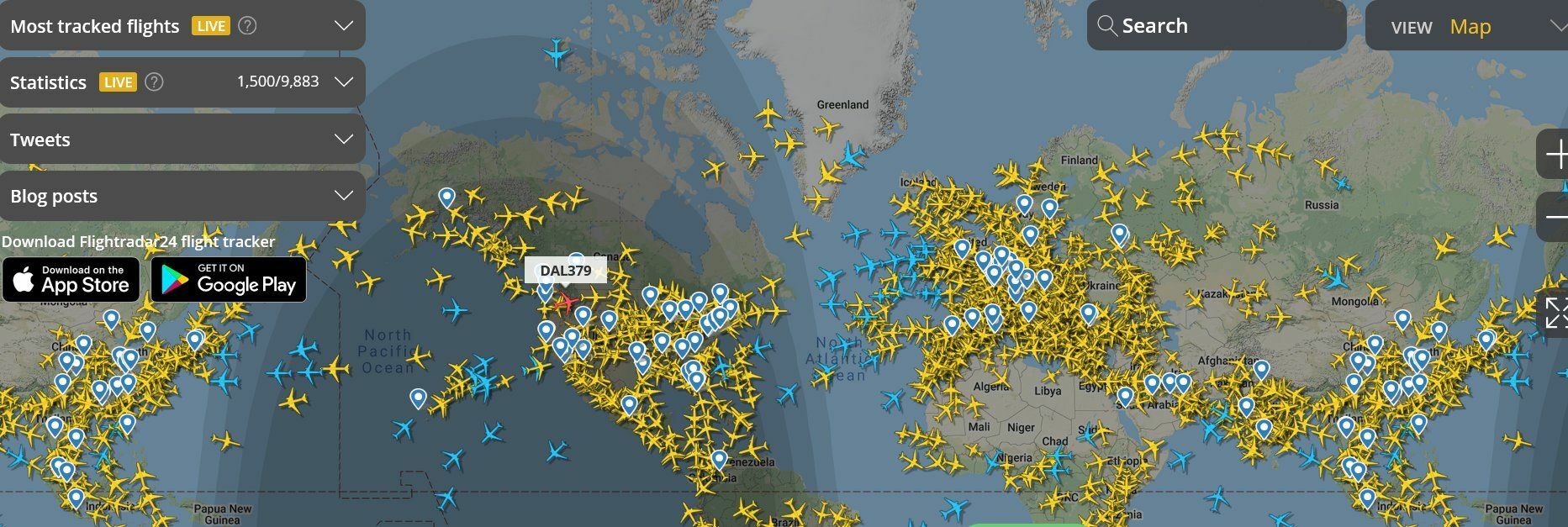

pete.i Posted September 6, 2021 Report Share Posted September 6, 2021 I do not know why everyone is bothering with hybridisation or Telsa or anything else that purports to save the planet. It's either doomed or it isn't no matter what paltry contributions we make. Big businesses are not going to stop shipping your iphones and all the other tech we use in great big heavy fuel oil powered ships belching out massive amounts of pollution. Nor are they going to stop using aircraft also belching out massive pollution in those pretty vapour trials everybody goes "OOOOOHHHHH" at. And that is not taking into consideration the vehicles on the roads or the industry or all the people who want to fly off to "exotic" locations around the world. Some of the ships on our oceans at the moment and aircraft in the skys....... Think about it. Link to comment Share on other sites More sharing options...
Jen-in-Wellies Posted September 6, 2021 Report Share Posted September 6, 2021 22 minutes ago, pete.i said: Big businesses are not going to stop shipping your iphones and all the other tech we use in great big heavy fuel oil powered ships belching out massive amounts of pollution. Ah, the nihilistic approach. We shouldn't do anything because no one else is. Big businesses are doing something. Mostly it is bribing politicians to delay curbs on emissions as long as possible and having a publicity green washing demonstrator ship, or aeroplanes, but some of them are starting to realise the game is up and they are going to have to change. 1 Link to comment Share on other sites More sharing options...
