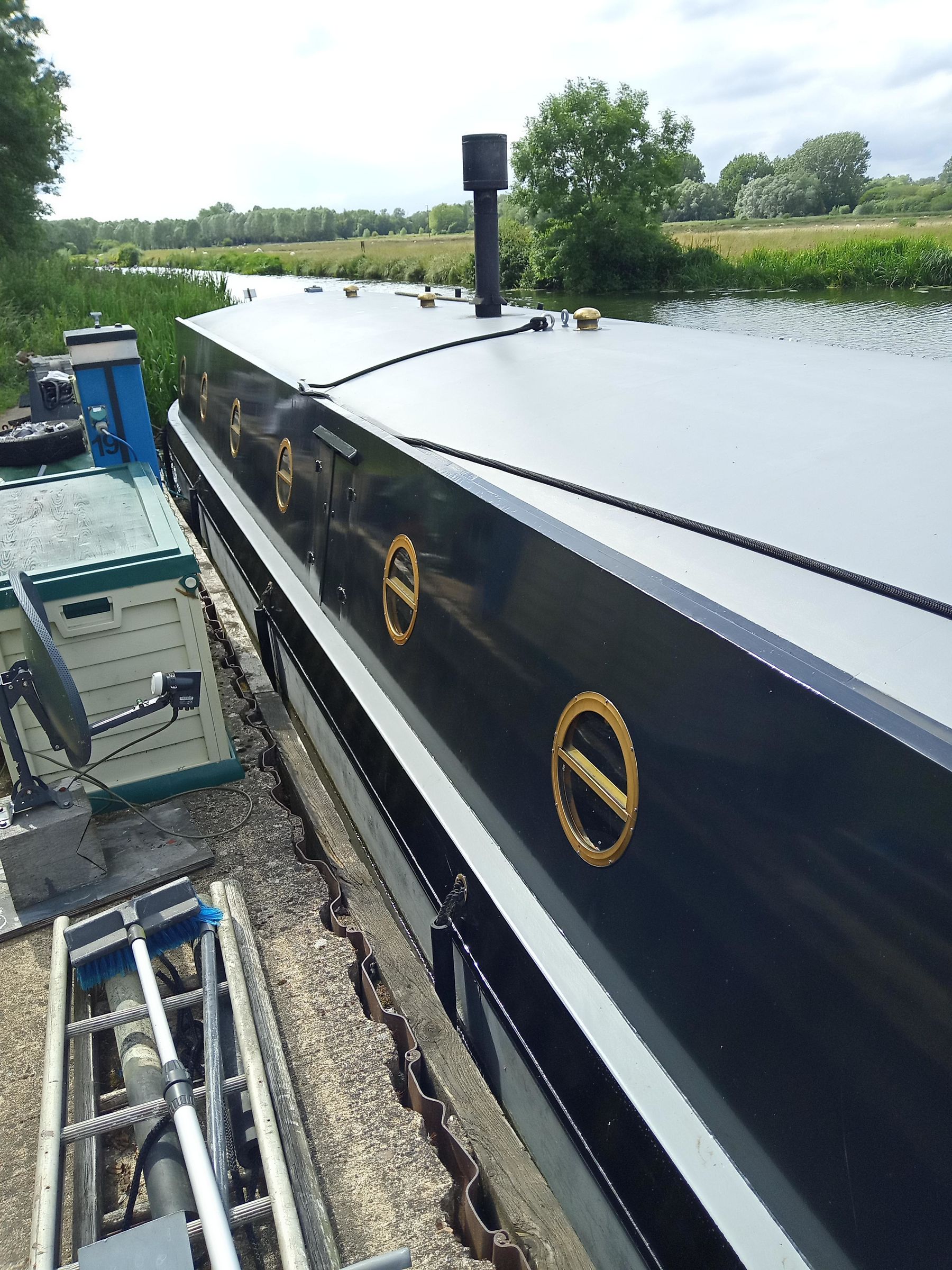

blackrose Posted July 11, 2020 Report Posted July 11, 2020 (edited) Firstly I'm never roasting in my black boat. It's no hotter than my neighbour's boats. However, I have a lighter coloured roof and it's a widebeam so there's a greater proportion of roof area to cabin side area. Whether that makes a difference I'm not sure. On the painting itself, if the existing paintwork is sound there's no need to take it all back to steel unless you really want to. Just sand it back with say a 240 grit paper and wash off the dust. If you haven't gone through to bare metal anywhere and there are no areas of rust then you could paint over with your topcoat of choice, but it might be better to use an undercoat. I used a couple of coats of Hemple primer-undercoat over the entire cabin sides. It's a good choice of undercoat. If you have gone through the paint and you're only patch priming/undercoating the bare areas them you'll have to sand those patches smooth before applying topcoats. Remember to sand with a fine paper between coats, especially if you leave any coat for more than 3 days and want to apply a new coat. I suggest you watch John Barnard's series of videos on YouTube. This is the first of 7. Professional painters go back to bare metal otherwise they might be guaranteeing someone else's old paint! Edited July 11, 2020 by blackrose

blackrose Posted July 11, 2020 Report Posted July 11, 2020 (edited) 5 hours ago, Rickent said: A light coloured roof will help massively, as will good insulation. Well the OP is going to keep their roof light grey. Looks like jaime66 is copying my paint scheme! I've just repainted it and still have to put grey coachlines on. My insulation isn't that great. It's a Liverpool boat after all. I'll be interested to hear if the OP's black paint job noticeably affects the temperature inside the boat or if it's all a bit of a myth. Whenever this topic comes up it always seems to be the people who don't own black boats who seem to know the most about how hot they get inside! Edited July 11, 2020 by blackrose
