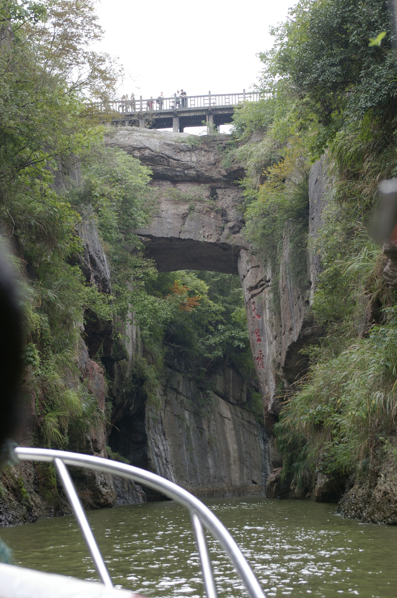

Is this a tunnel or a bridge? It is on the Rouge Canal, just to the west of Nanjing, and was built circa 1390AD. There were originally two 'bridges' of sandstone left when excavating the cutting, though one collapsed later.

So, is it a tunnel or a bridge?
