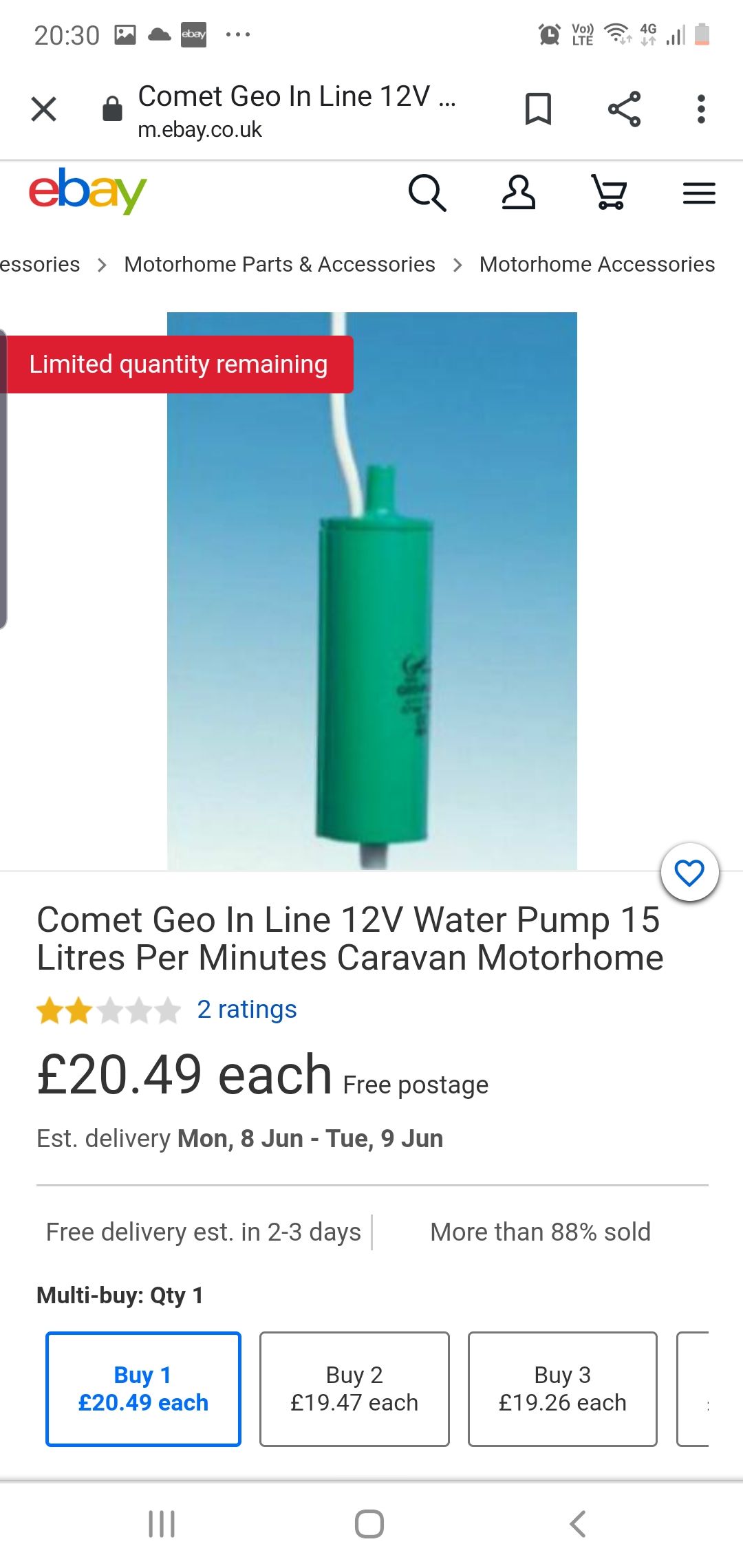

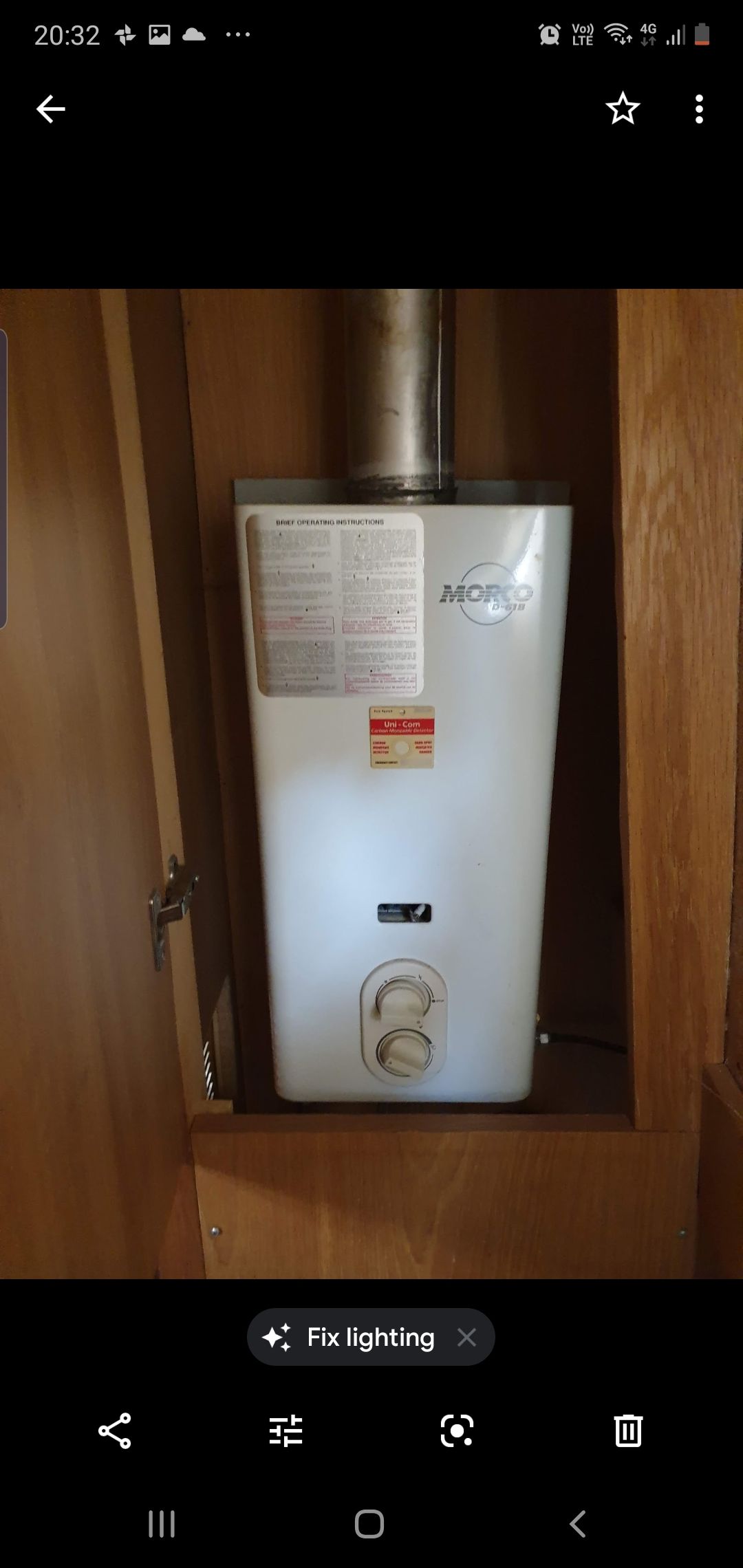

Deano1988 Posted June 4, 2020 Report Posted June 4, 2020 hi all, just in need of some recomendatios if possible currently there is a boiler for central heating only (see pic) with a pump like (see pic). the stat only links to the pump not the boiler. if anybody can confirm that changing the temp on the stat will change temp heating (how would this work?) the pump no longer works anyway so im looking for GOOD QUALITY pump that can pump the hot water around the system and change temp via stat (if even possible) the one that is already in says it only has a life span of approx 450 hours. hope this makes sense and you can help thanks dean
WotEver Posted June 4, 2020 Report Posted June 4, 2020 16 minutes ago, Deano1988 said: ... if anybody can confirm that changing the temp on the stat will change temp heating (how would this work?) I would imagine that pumping the water through the system will cool it, therefore causing the boiler to kick in.
system 4-50 Posted June 4, 2020 Report Posted June 4, 2020 A Morco driving a central heating system ????
nicknorman Posted June 4, 2020 Report Posted June 4, 2020 That in a non-room-sealed water heater designed for intermittent use (ie when a tap is turned on). It is absolutely NOT designed to run a central heating system and it’s dangerous to do so. Do you have any family on the boat? Presumably you don’t like them very much and will be glad when they die.
system 4-50 Posted June 4, 2020 Report Posted June 4, 2020 Have you had the boat long? Are you sure you know which bits do what?
Deano1988 Posted June 4, 2020 Author Report Posted June 4, 2020 19 minutes ago, nicknorman said: That in a non-room-sealed water heater designed for intermittent use (ie when a tap is turned on). It is absolutely NOT designed to run a central heating system and it’s dangerous to do so. Do you have any family on the boat? Presumably you don’t like them very much and will be glad when they die. This this comment is a bit harsh. I'm quite new to this and trying to get a bit of help of people who know what they are talking about. If it's not right I will change it and make it right ( I didn't know it wasn't right) So I WONT be happy if my family die 10 minutes ago, system 4-50 said: Have you had the boat long? Are you sure you know which bits do what? Think I have have got my head around everything in the boat now. This has defo been used for the central heating before there is another exact same that does the hot water for the shower and sinks Thanks dean
Tracy D'arth Posted June 4, 2020 Report Posted June 4, 2020 Frightening. Not being harsh but horrified that anyone would do this.
system 4-50 Posted June 4, 2020 Report Posted June 4, 2020 It is difficult to understand how it could be used for central heating. A Morco needs an unrestricted output to be able to deliver hot water from input cold. A central heating system recirculates hot/warm water. A Morco would not like warm water being fed back in. I'd love to know how it was done. Can you gives us an idea of the major components of the system and how they were connected together?
nicknorman Posted June 4, 2020 Report Posted June 4, 2020 1 hour ago, Deano1988 said: This this comment is a bit harsh. I'm quite new to this and trying to get a bit of help of people who know what they are talking about. If it's not right I will change it and make it right ( I didn't know it wasn't right) So I WONT be happy if my family die Thanks dean Harsh? Yes definitely. But then it is a serious matter.

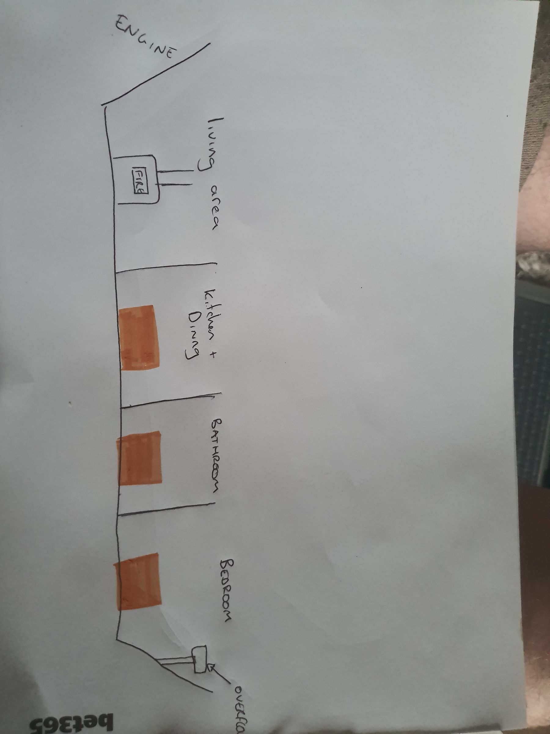

Deano1988 Posted June 5, 2020 Author Report Posted June 5, 2020 Hi all so I think im getting my head around this now. I already have a morso squirel multi fuel burner. (Stove) So if I get rid of boiler that was used for central heating and get a backboiler for stove. Is the picture the right theory. Would it work I will just carry on using the 1 boiler for hot water Thanks
Tracy D'arth Posted June 5, 2020 Report Posted June 5, 2020 (edited) Looks fine but you need an expansion tank at the highest point so that you can fill it and vent the air out. Forget the stat with solid fuel. If you get the pipework to rise the correct way from the boiler and fall to the radiators you can get it to work on gravity, saves a pump and all the electric consumption. You also have to consider what happens if the pump gives up or the electrics fail with a big fire burning, Some will say use a sealed system with an expansion level but it not so easy and I don't like it with solid fuel as its impossible to shut it down fast in emergency. You have to have somewhere for the heat to go at all times, usually the calorifier is included in the circuit to give a fail safe heat dump. Edited June 5, 2020 by Tracy D'arth
Tony Brooks Posted June 5, 2020 Report Posted June 5, 2020 (edited) 1 hour ago, Deano1988 said: Hi all so I think im getting my head around this now. I already have a morso squirel multi fuel burner. (Stove) So if I get rid of boiler that was used for central heating and get a backboiler for stove. Is the picture the right theory. Would it work I will just carry on using the 1 boiler for hot water Thanks In an ideal world you would re-plumb the radiators and stove for gravity circulation so it does not need a pump. If you have a wet stove plus pump if the pump fails the whole system is likely to boil. I think the pump in your diagram is in the wrong place. Its flow will short circuit through the radiator closest to it. You can't/should not use a room stat with a stove. Any stat needs to be a pipe stat that will run the pump once the outlet from the stove reaches a certain temperature. A room stat is likely to cause the system to boil. Edited June 5, 2020 by Tony Brooks
system 4-50 Posted June 5, 2020 Report Posted June 5, 2020 If the roomstat stops the pump and the system is not designed for gravity circulation, what is there to stop the water in the stove overheating ie boiling?
David Mack Posted June 5, 2020 Report Posted June 5, 2020 35 minutes ago, Tony Brooks said: I think the pump in your diagram is in the wrong place. Its flow will short circuit through the radiator closest to it. Pump should be next to the bottom connection on the stove, so it pumps the cool(er) water back into the boiler. Have a search around the forum for similar past threads. There are some diagrams showing how to plumb gravity and pumped back boiler systems.

Deano1988 Posted June 5, 2020 Author Report Posted June 5, 2020 Struggling to find anything that suits my system I require. Would this work? I'm going to keep the morco 61b for hot water in shower and sinks. (There is 2 on the boat) So this is only for the radiators I dont know how to get around the pump I dont think it is possible to gravity fed where everything is. Thanks for all your help it is very appreciated. I wouldn't have a clue with out this forum.
nicknorman Posted June 5, 2020 Report Posted June 5, 2020 As has been mentioned, you can’t stop the pump when the fire is burning, otherwise there is a significant risk of the water in the back boiler boiling. When that happens, the water in the boiler turns to steam and thus expands massively. It pushes out any water in the pipes before venting itself and most of the very hot water, out of the header tank in a forceful way. You certainly wouldn’t want to be near that when it happens, nor have to clear it up afterwards! Also I would check the output of any back boiler vs the size of radiators you want it to feed. Not sure which Squirrel you have but I think the back boilers for them are only a couple of kw, won’t be enough to run a whole lot of radiator area. You are on the right lines here, but the detail is important!
Tracy D'arth Posted June 5, 2020 Report Posted June 5, 2020 Morso Squirrel quoted as 5kw. generally enough for a 58ft boat. If you post a layout of your boat and where the burner would go, preferably fairly centrally in the saloon on the same side as the calorifier, we can suggest how to achieve a gravity circulation system.
Deano1988 Posted June 9, 2020 Author Report Posted June 9, 2020 On 05/06/2020 at 21:53, Tracy D'arth said: Morso Squirrel quoted as 5kw. generally enough for a 58ft boat. If you post a layout of your boat and where the burner would go, preferably fairly centrally in the saloon on the same side as the calorifier, we can suggest how to achieve a gravity circulation system. Just now, Deano1988 said: Hi thanks for the help the rads and fire are already in place all on 1 side of the boat. Any ideas how I would achieve the gravity fed system. Thanks dean
