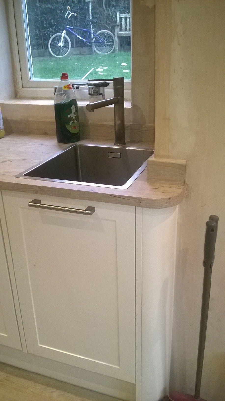

Going to put in solid beech kitchen worktop - is 27mm thickness ok ?, do they warp too easily ?
Or, in practice are they ok ?. Would prefer to do 27mm rather than 40mm thickness as lighter and cheaper ?
Any experience from kitchen / boat fitters appreciated

Thanks. Do you mean this sort of bracket ? Is 27mm a false economy then ? - are there sig less wood expansion warp issues with 40mm ?
... would like wood top so I can do some fancy radius shapes, cant afford acrylic, cant do that sort of thing with laminate...
40mm will be more stable but even so, you could run into trouble with cutting a radius into it. It will very likely be vulnerable to pieces being knocked out.
  An option could be a reclaimed iroko top, not cheap and normally requiring some refinishing but bulletproof and stable.

I have a wooden worktop in my kitchen, no expansion gap at the back, no sliding fittings, it has a washing machine and a tumble dryer underneath it with no moisture barrier, and a microwave, toaster and kettle sitting on it. There is no heat barrier by the hob which is fitted into my wooden worktop, and after the first 3 or 4 coats of oil, it gets one per year to keep it fresh and water repellant. It was delivered on it's side in the lorry which brought it from Scotland, and as I had 4 pieces some stayed on it's side in the hall for a few days. I must be very lucky because 11 years later it still looks good. It even has the stainless steel sink set into it, but I would not try with a set under sink and would be cautious with a butler type, wet endgrain is not good. Mine is Cherry, anything but Oak seems OK, Oak marks from tins sitting on it and anything steel tends to make it go black as does water.

Iroko looks v.nice... a bit of googling suggests I can get the 3.5 linear m I need for kitchen and dinette table for just under £300 new in 27mm (cheaper than reclaimed !?)... so Im tempted !.
Ive got a makita 1/4" hand router which Im hoping will cope if I take my time
I dont like square edge laminate  - dont see how I could do an internal radius with 38mm bullnose variety
and as Im doing dinette table as well there would be a lot of edging to peel away in due course ?

The new iroko worktops are of a similar glued batton construction, whereas the reclaimed is made from wide planks. This is better if you are profiling it as there will be no tiny ends of batton left on the edge of the cut which can dislodge over time. The older iroko is often of a lighter colour than the modern composite with amazing grain patterns when finished well.
Thanks. Will have good rummage on fleabay/gumtree. Can see how would be better than narrow staves. Also has bonus of having lots of pen*s already gouged in, so save time as I dont have to do that myself.

Can pretty much repeat this.  I have wooden worktops at home and on the boat.  Shaped ends with a decent jigsaw followed by a bit of sanding.
