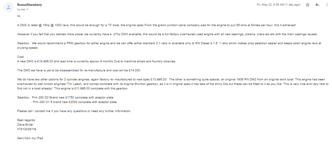

I sent a email to Russel Newbery, they supposedly still make them, they have to get some parts custom made for the engines. I sent an email a day ago to them. I will put in a screenshot of that email. Also, here is their website: http://www.russellnewbery.com/index.html

Vapourware? That's not true.  There are 2 DM2's in production right now with a third awaiting a deposit to start. I am a director of the Register and got this information only 3 weeks ago!  There is also an engine coming out of an ABC hull so that will be up for resale.
As for the other points, why not call the owners of the RN Diesel Engine Co. and ask them?
Yeah, I pointed that out earlier... I didnt know that there were 2 in production. but I did know there is a1936 RN DM2 out of an origanal work boat for sale. I also put in a screenshot of the email they replied to me with
