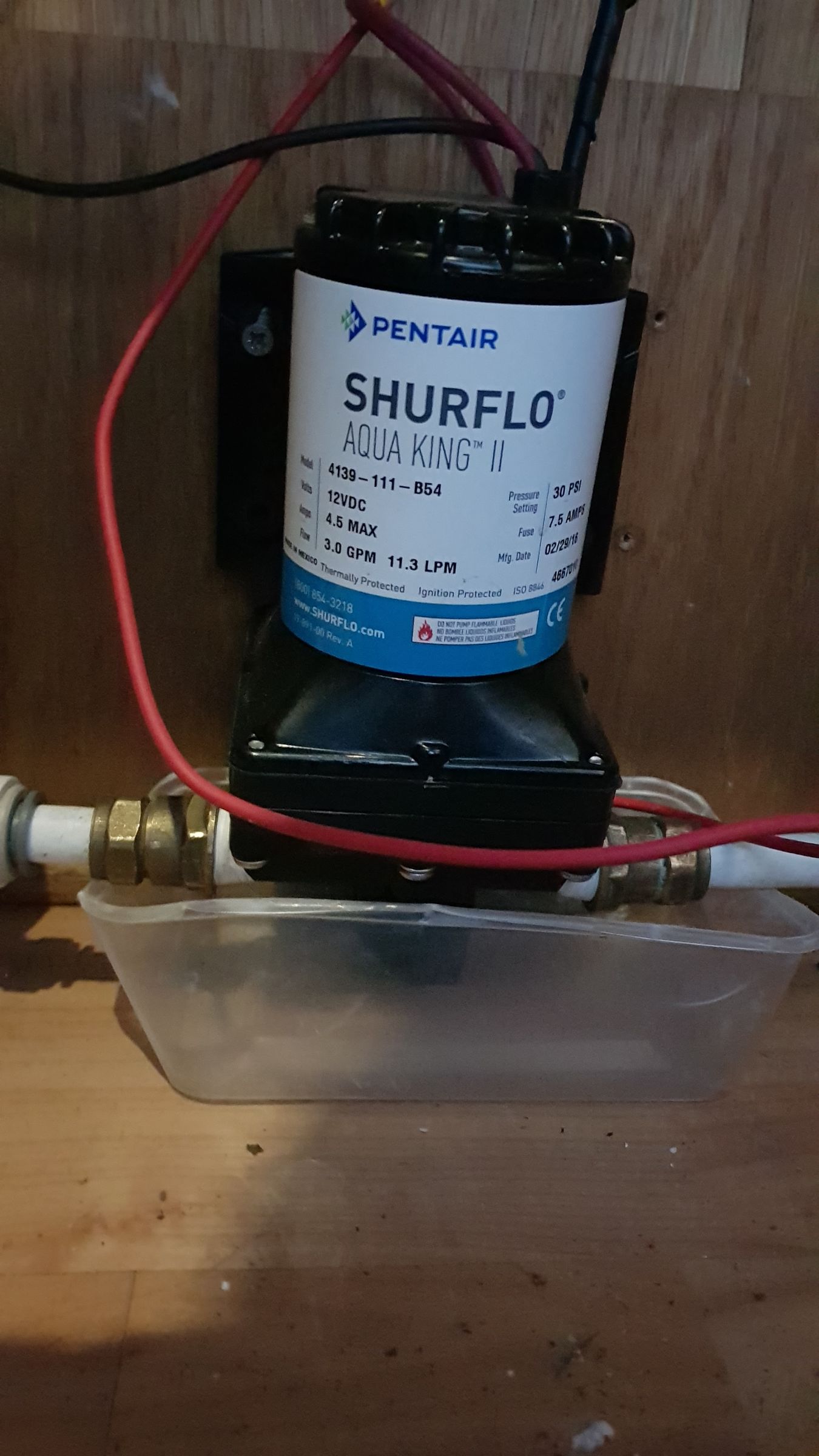

46 minutes ago, mrsmelly said:
I am no expert but have lived on many boats. If it were me I would find out what pump type and pressure is fitted. Some will deffo over power the prv on the cauliflower if it is higher than it should be. It is possible to bugger a cauliflower, dont ask me how I know this to be a fact. Is it a shurflo, whale or jabsco par max type pump?
This is the water pump.
Looks like its mounted with the adjusting screw pointing down into the plastic container? The pump size is fine for your purpose. Can u get to the adjusting screw and drop the cut out pressure a little?
Not easy to get to it. I'll look up where the screw is online and see if I can find a way of getting to it.

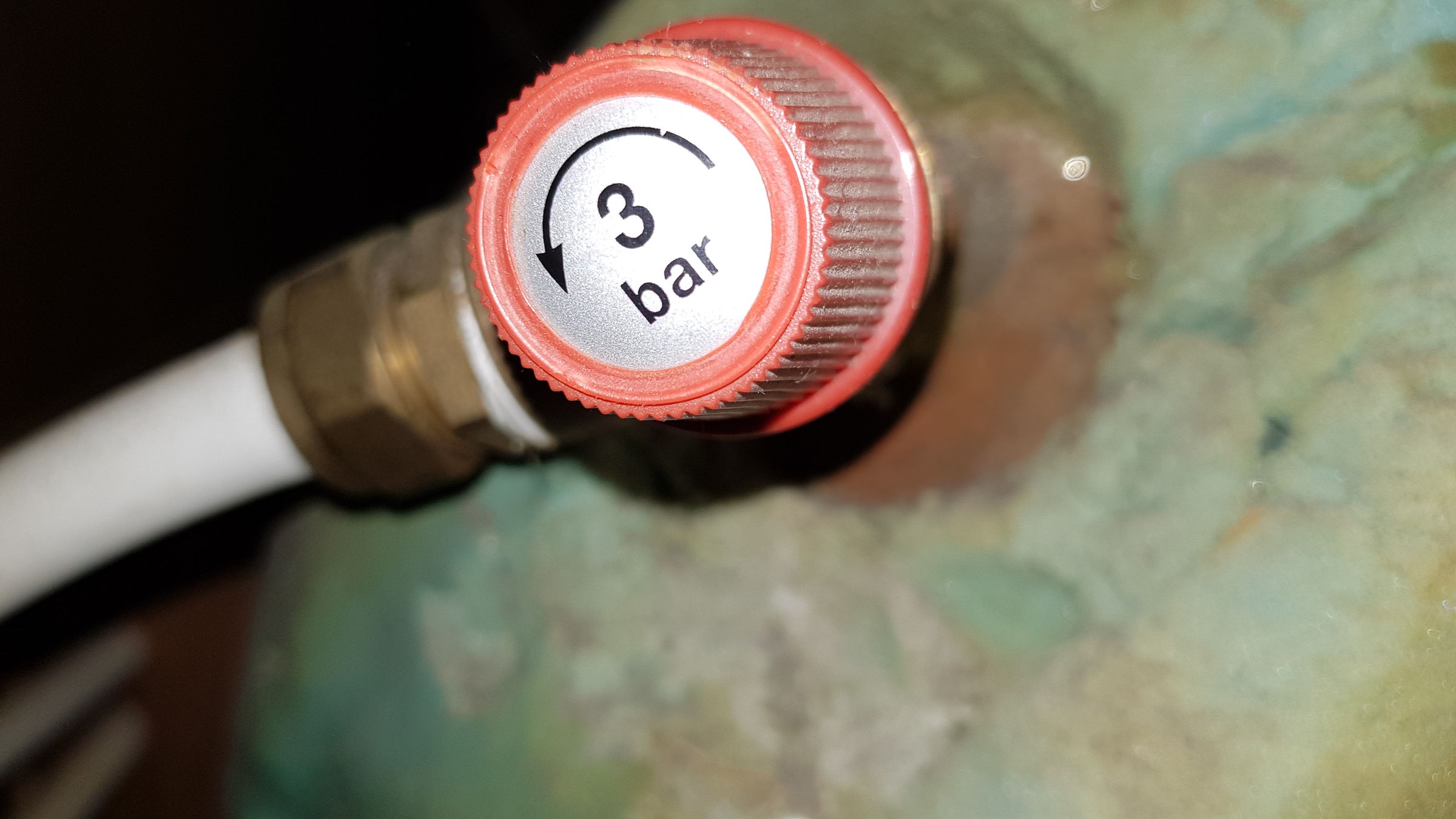

I have turned the water pump on whilst watching the outlet in the bilge, and it starts to seep just as the water pump gets up to its cutout.
Seems that it's either a faulty prv or the water pump cut out is too high.  Any other possibilities?
Prv should be 43psi
Water pump should be 30psi ish.
Not sure adjusting the water pump is going to make much difference?
It's looking like a faulty prv ?
So, the pump is 2 bar and the prv is 3 bar .
Where does the white pipe out of the prv go?
If the pipe leads into bilge is thre any water coming ot of it?
If yes then it,s the prv.
If no then you've got a leak.
If it,s the prv try rotating it , twist the red cap, afew times. It may clear the problem . If not replace it.
If it isn't the prv the fun starts finding the leak
