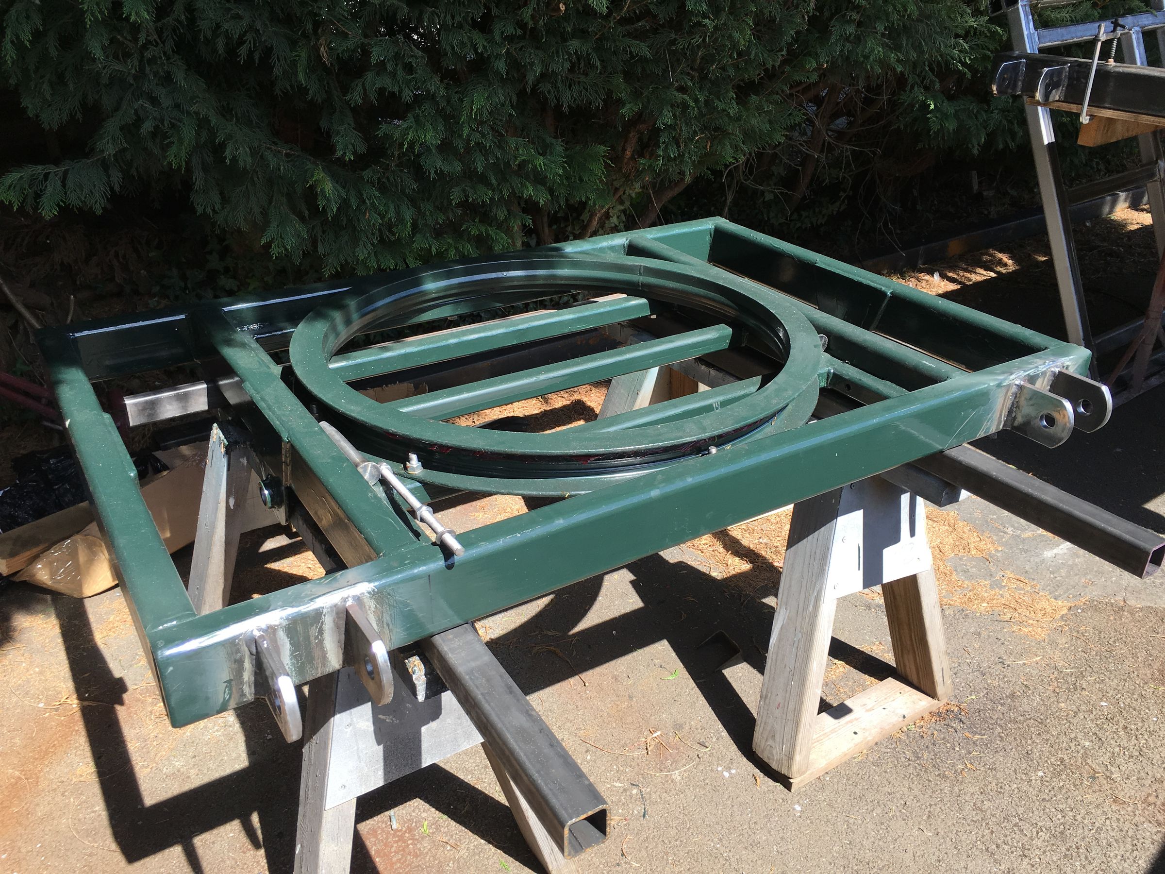

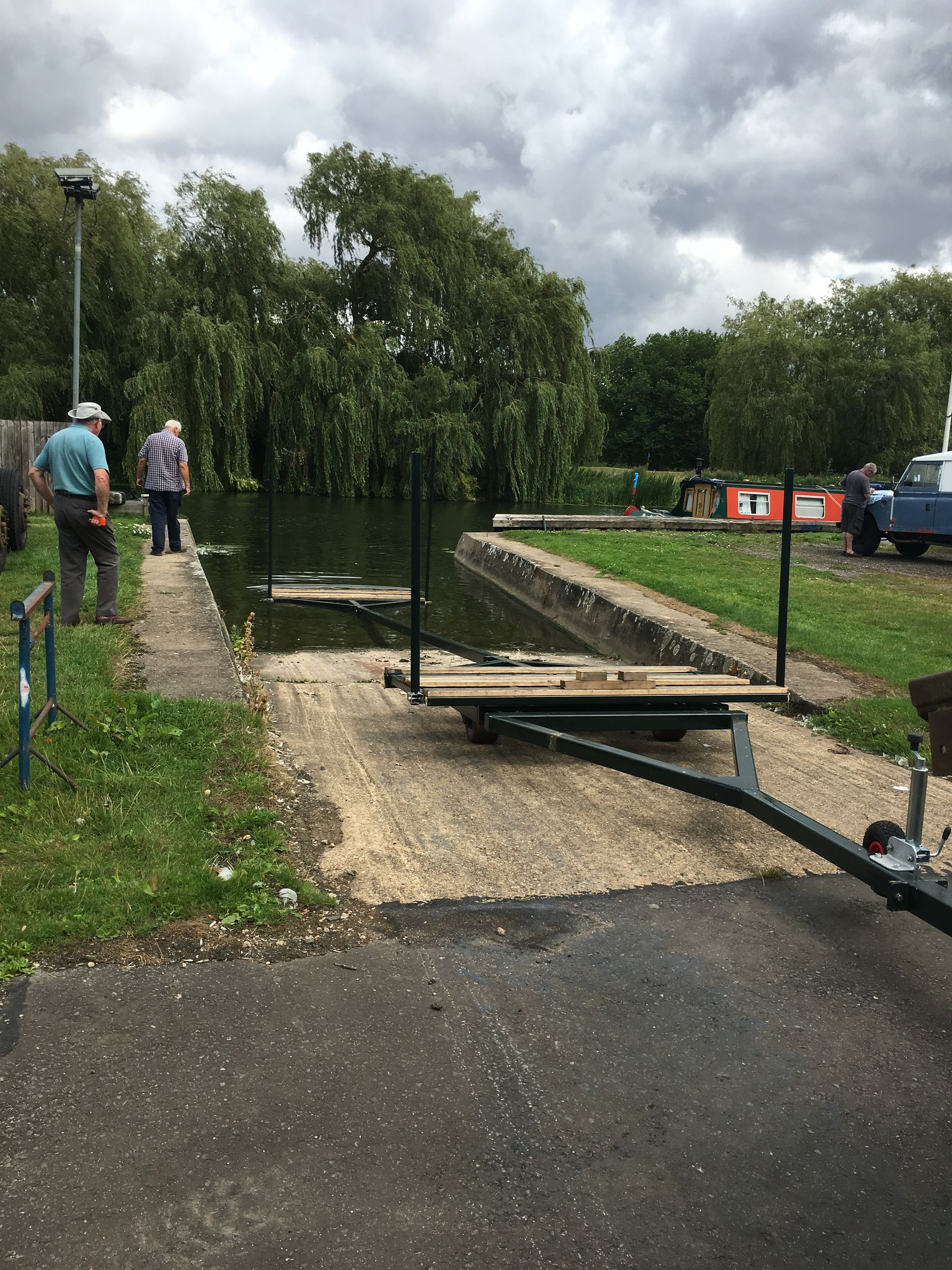

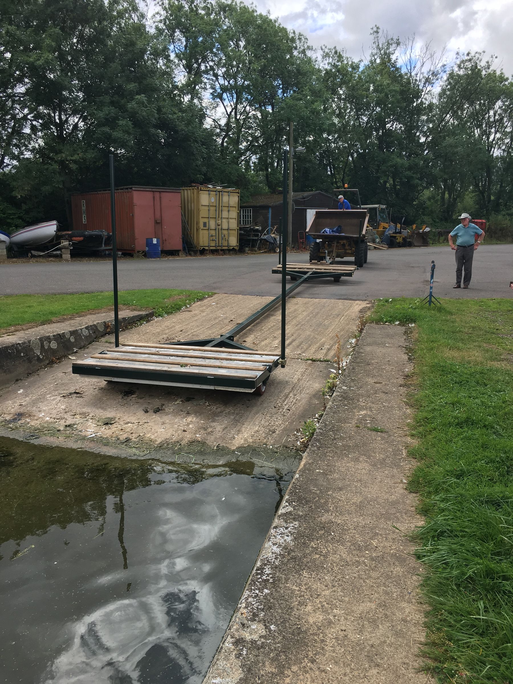

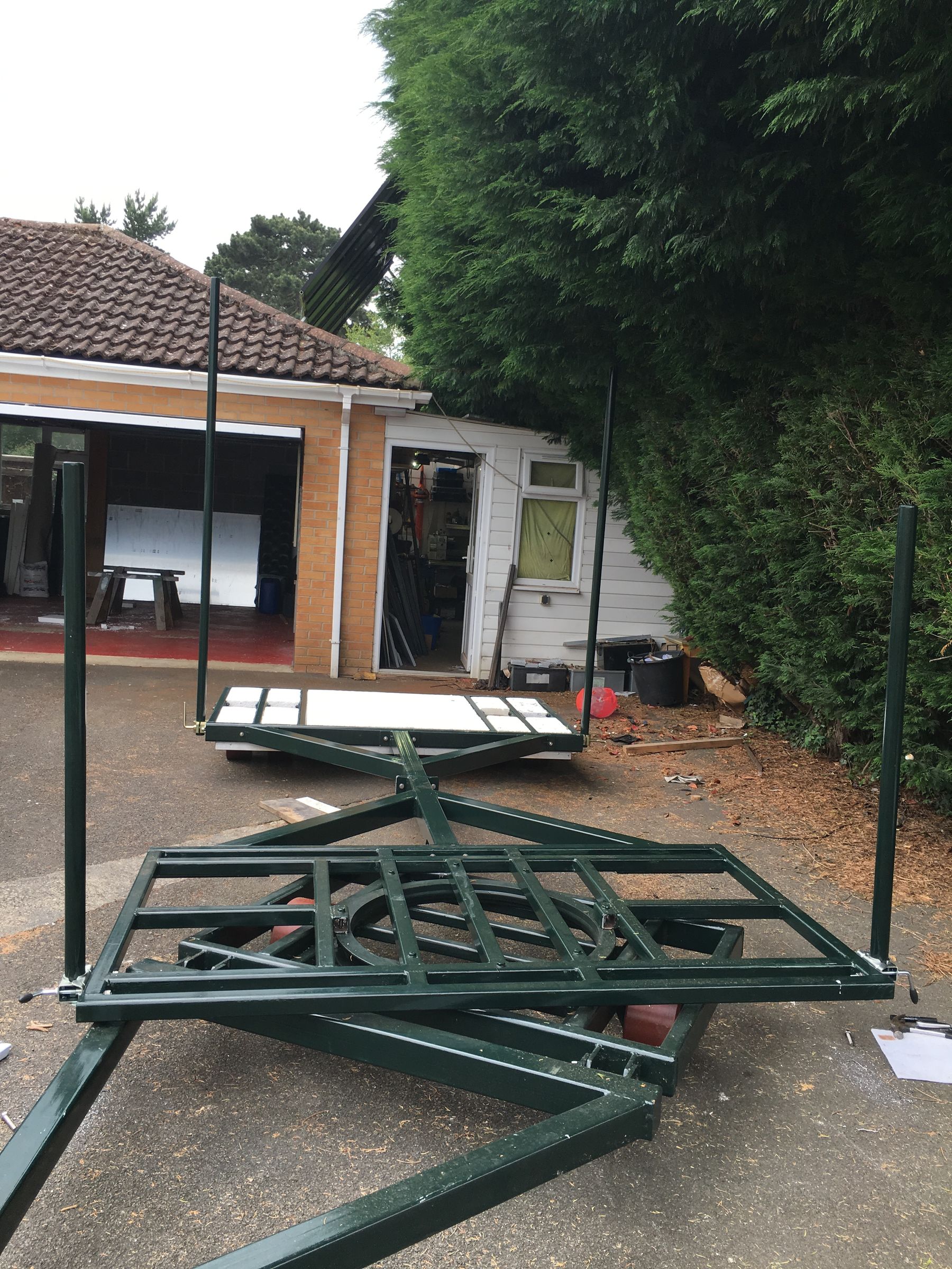

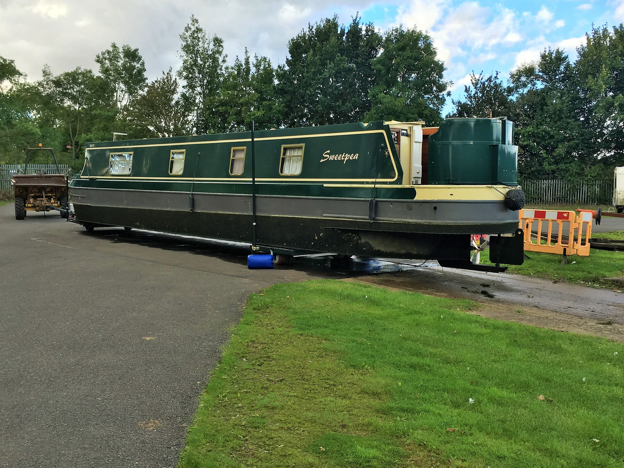

this is a narrowboat launch trailer i made two years ago it will carry 16 tons, with turn table front stearing very maneuverable, it has also got a hydraulic lift system so you can jack up your boat chock it up and pull the trailer out to be use again. the boat can be worked on without tying up the trailer.this has been very usefull tell me what you think

Looks nice.  Loadsa questions!
For starters?
 What is its maximum capacity, length wise and is the overall length/trolley spacing adjustable for short boats?
Will it do V bottoms?
How does the hydraulic jack bit work?
How do you stop the wheel bearings going rusty when it is out of the water?
N
Presumably the same way as the 10's of thousand of towable boat trailers (sealed bearings and / or 'boat buddy bearings')

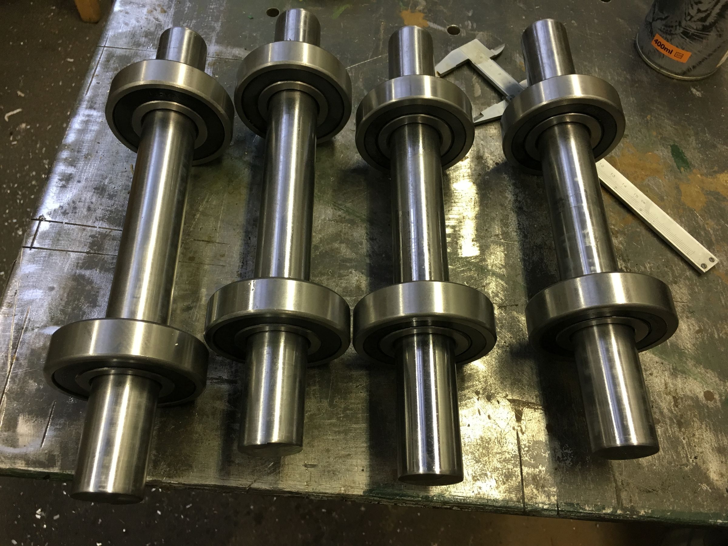

the bearings are sealed, the length is about 20 ft shortest, 70 ft longest back of trailer only sinks 30inches and is suspended in the water by two float tanks

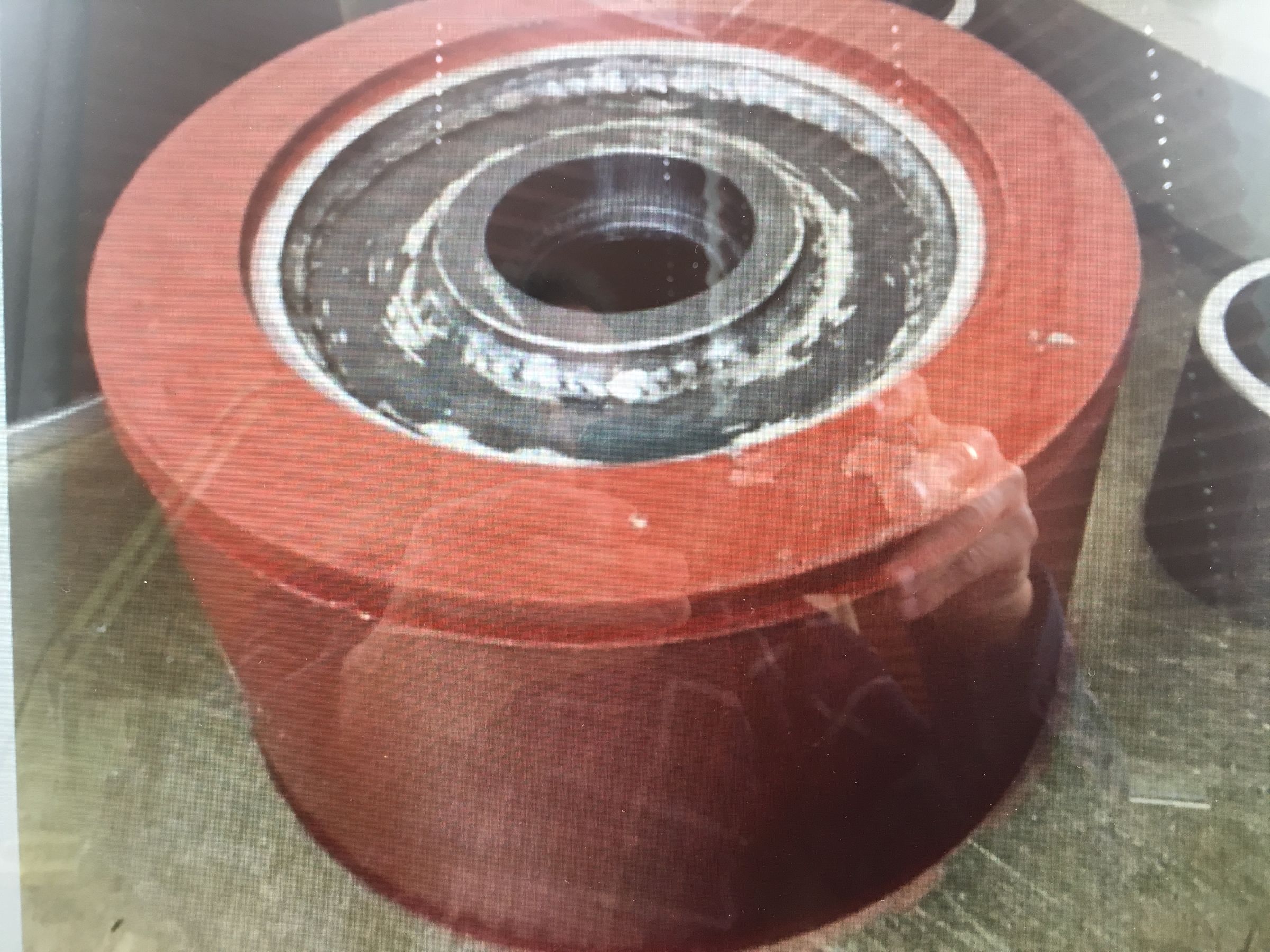

Where did you source the wheels? Are they polyurethane bonded units?

It looks like a home made version (not in a bad way) of one that's commercially available - Droitwich Spa Marina have one.  Theirs is a lot more rugged (I believe it has greater lifting capacity) and has twin tractor sized wheels at one end only so will ride rough surfaces better, but works in a similar way in terms of the hydraulic lift to place boats on sleepers.

8 hours ago, rusty69 said:
It looks good to me, but guess it is only suitable for Shallow inclined slips due to the small wheels.
i made the wheels for our slip and i did not want them outside the trailer it makes it more difficult to remove when boat is on sleepers

my own hydraulic rams

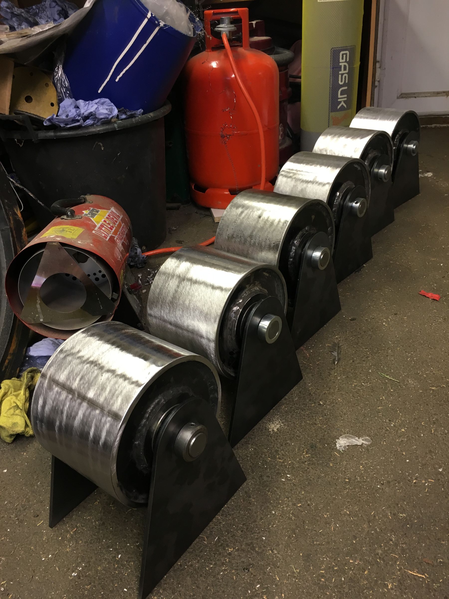

the wheels were a challenge got to carry a lot of weight they carry my 50 ft and a friends 55ft showing no stress 4 at the back do the job
Looks really well constructed and I like how you've fabricated pretty much all of it without re-purposing or borrowing many parts so to speak. The only thing that lets it down is that dumper truck.  ?
Sheesh, does the 50ft go on top?
had to make them myself, to buy ready made to carry this kind of weight was to expensive, my wheels were fabricated steel and cost nothing but my time, the expence was the solid polyurethane tyres done by a company in birmingham cost £400 the most expensive bit of the whole job
