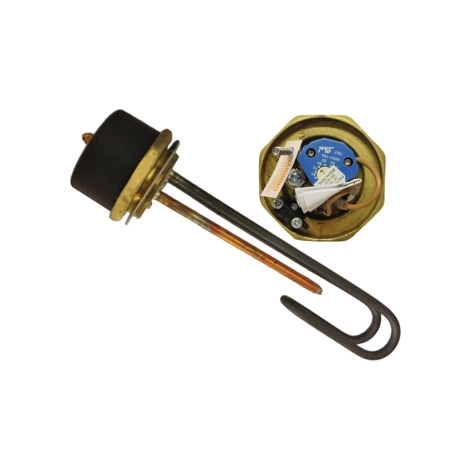

Changing the immersion element within the Calorifier
Onewheeler replied to grockell's topic in Boat Building & Maintenance
The inside of the cover should look something like this: The blue bit is the end of the thermostat and it slides into a pocket. It is only held in by the wires so is easy to change. Try turning it up a bit. If that doesn't work they're only a few quid from Screwfix to replace, just get one the right length. Martin/- 44 replies
More likely that the thermostat needs adjusting or replacing if the water gets warmish. Is it the usual domestic arrangement coaxial with the heater or a separate unit?- 44 replies
