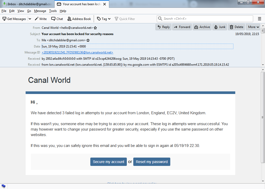

Good point, I had not but have now. These are the links; https://www.canalworld.net/forums/index.php?/lostpassword/ https://www.canalworld.net/forums/index.php?/settings/secure-account/ So it appears the email is from canalworld but does not explain the different email adrress issue. Regards Ditchdabbler
Started a new post because the other one appears to have strayed off topic. Screenshot of email attached. Is this genuinely from canalworld.net? The 'To Me' email address is different to the one in my account settings. Should I be worried? Has canalworld been hacked? Any comments from the Admins? Regards Ditchdabbler
