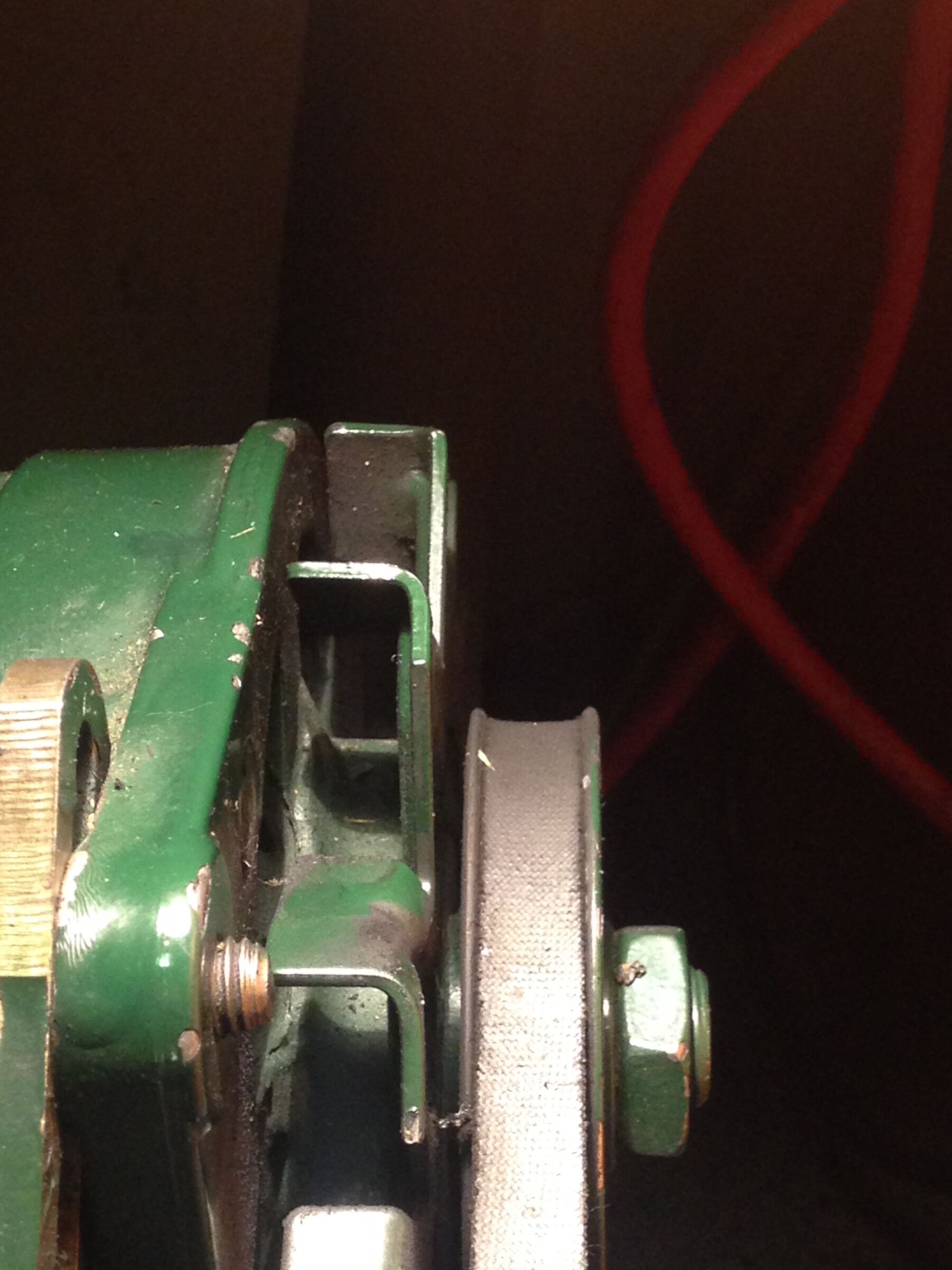

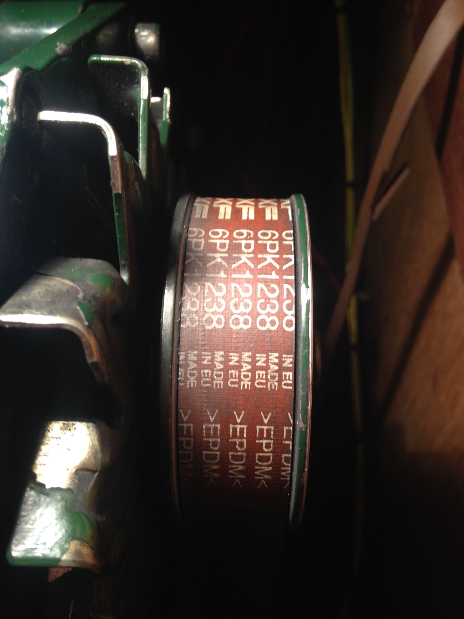

  3. Our boat has a Beta Marine BV1505 engine, which has these two alternator drive belts fitted. Each alternator belt is sitting below the top of the pulley which, I think, means that the belts should be replaced, as they are too worn. Firstly: is that correct? We bought the boat in July 2015, and it came with two spare belts, which have been stored as in the picture below all the time that we have had the boat. I have no idea when they were new. Second question: are these still usable, or are they likely to fail prematurely because of how they have been stored? Thanks in advance.
