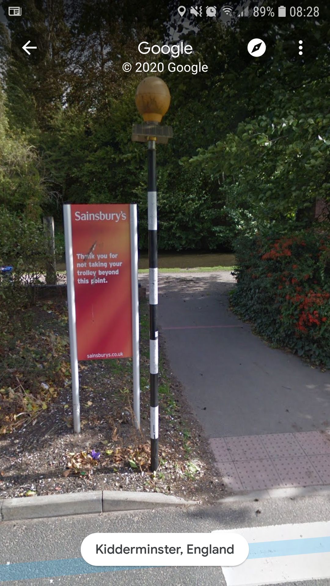

  11. Hidden trolley stop, obviously the wife just blindly pushed the trolley through at which point the wheels locked. I then had to drag the thing down the tow path to the boat. She then announced that the trolley didn't have a pound in it, it was a token from her key ring and that she wanted it back. I then had to drag it all the way back. I thought that passing over the trolley stop would restore wheel function - not the case. After trying to drag it across the car park I could take the shame no more, got another trolley, mated it, recovered token and walked off trying to regain some dignity. I can quite understand why they end up in the canal if they they make it out of the car park!
  12. Moored at Sainsbury's a few years back for a day at the severn valley railway. I remember thinking how horrible the walk across town to the station was. Otherwise great day out. Just annoying that you can't get the trolley the last 5m to the towpath!

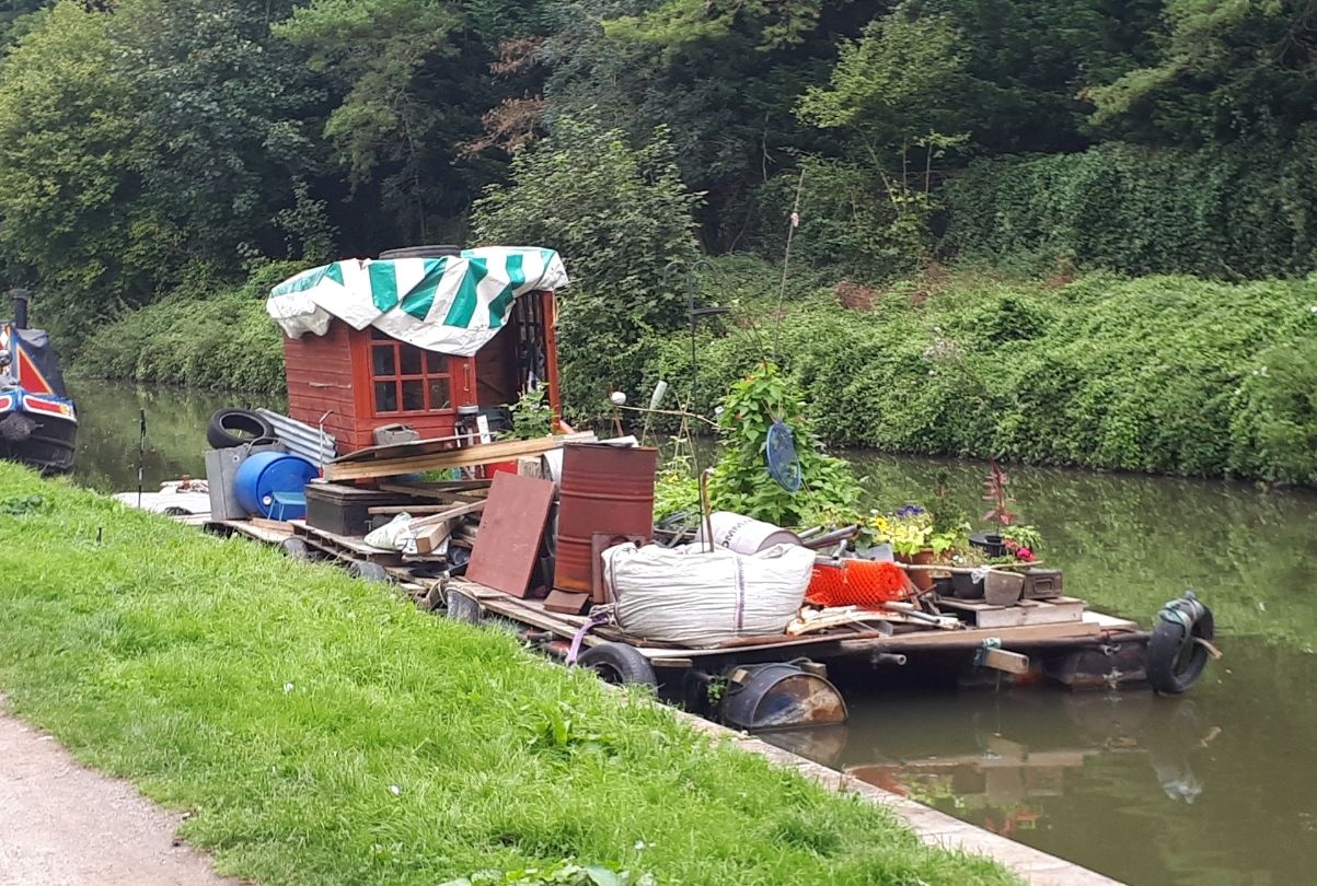

  14. You don't need a residential mooring near Bath, you don't even need a boat, just a shed and some oil drums, sorted.
