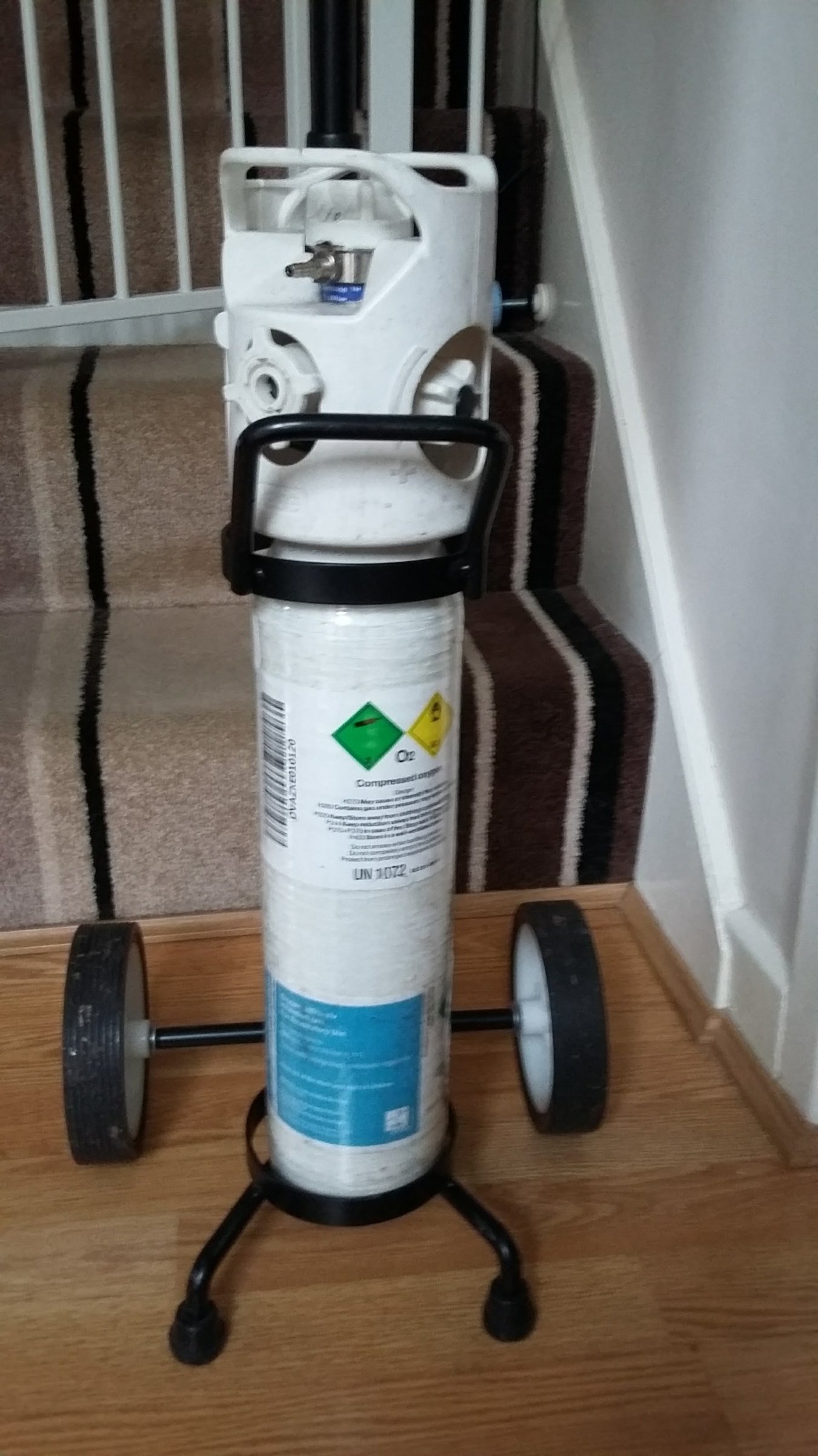

I thought I'd ask on here if anyone is or knows, someone who has to use this to maintain their breathing.  I am a sufferer OF COPD and have had it now for number of years and in January got an infection that resulted in an extreme exasperation as classed by the respiratory team who took care of me.  Now, the question is, as I have to drag a cylinder around on this trolley is there another way of maintaining the joys of boating which I've managed over the many years with something more compact and usable if you follow?  I did try and explain to the team my concerns and my leisure activities with the boat.  But by the look on his face I know he hadn't a clue of what I was explaining about locks and dragging a trolley complete with with oxygen cylinder around with me.b
I'm sure there must be other boaters like me out there, who cope with this condition, and manage their boating with something more manageable?? If so, please help if possible in pointing me in a direction.  As always guys and gals thanks in advance.
Its really going to depend on your usual consumption requirement and what you are hoping to do.  We had to escort a patient on a 4 hour flight and ended up using the aircraft's entire stock of O2 cylinders (3 (B) of them) but his requirement was 8L/min whereas yours I would suspect is no more than around 2L/min.  At this rate the very small medical cylinders should last you about ½ an hour - just enough time to do a lock, or an hour if you go for the next size up.  Any bigger than that and it's probably too heavy and awkward to carry.
