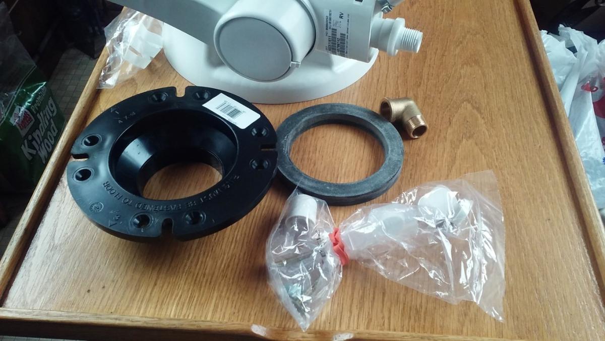

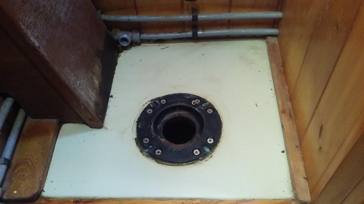

Hi - i've been down to the boat and removed the old toilet.
The job doesn't look like too much ball ache.
The original securing bolts are nowhere to be seen. There is some verdigris that suggests that they might once have existed.
The tank is glassfibre (or possibly ABS), so there is no other corrosion.
The existing floor flange needs to be rotated by 45 degrees. It is bedded in what looks to be rubber sealant, so probably best to take it off and fit the new one that I have already bought.
I don't have new floor flange bolts but the old ones appear to be stainless and in good nick.
The fresh water supply is on the left hand side of the old toilet, and on the right hand side of the new one. Probably easiest to modify the plastic supply pipe that runs behind the toilet so that the t-junction is on the correct side.
Piccy below of the area with old thunderbox removed, and the fitting kit that I have.
If you were able to make it on Tuesday, I'd be very grateful!
Edited by PaulG
You've obviously got enough DIY skills to get this far - any reason why you can't finish the job?
All I've had to do so far is to disconnect a water pipe!
It just strikes me as the sort of job that could go horribly wrong if you don't have any experience.
I've not done much plumbing, and it may be a simple job, but I don't really trust myself.
However, if no-one wants to do it, then I'll probably have a go at it...
Good 'photos and descriptions.
It looks like the trickiest job will be movihg the Te junction from left to right because of the paneling and bulkheads. Can the NuLoo be easily changed or is there room to double back from the Te? Moving the Te will need ether a new length of pipe from whatener is to the left of it (Best option) or a sraight connecter in place of the Te.
