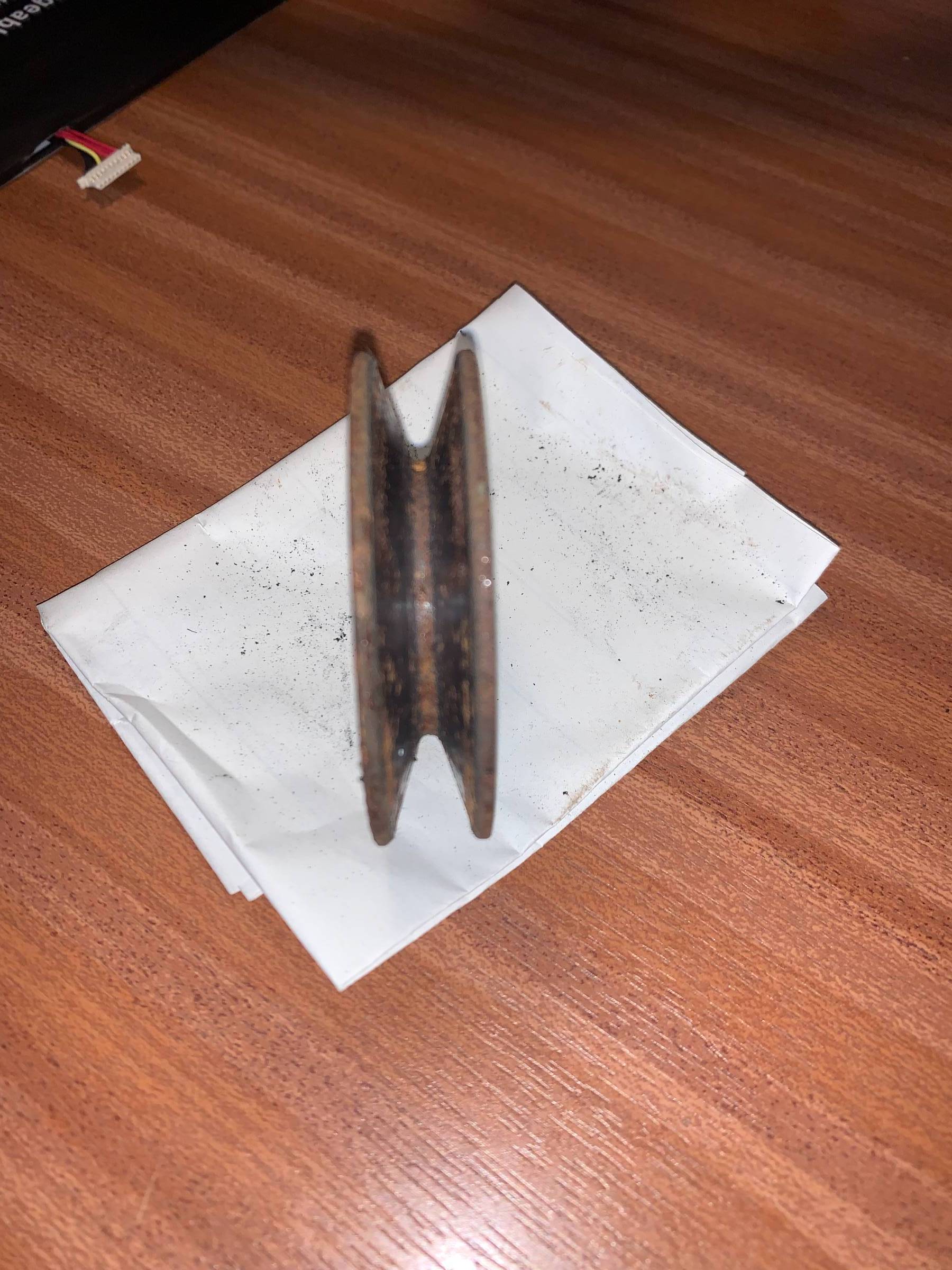

  11. Back home now, so here's some photos of the old pulley.
  12. Not too concerned with its accuracy: for my purposes it should read: idling bimbling chugging thrashing
  13. Indeed. I set the engine to idling, and turned the adjuster on the back of the rev counter to match previous revs.
  14. I haven’t had a good look at it, and it’s now at home, so I’ll inspect it in a week or so when we get back. Certainly the belt seems to fit more exactly to the new pulley.
  15. UPDATE having put up with the rapid belt wear, and slipping on first startup in the morning, for what I see to be four years (doesn’t time fly!), I decided to bite the bullet and replace the 65mm tinplate pulley with a machined steel 80mm pulley. Removing the pulley in situ was easy with an impact driver. The new pulley needed the shaft hole making bigger to fit- easily done with a step drill. The belt was refitted, and so far so good- no slipping/screeching on startup. It does seem to be a much snugger fit to the pulley. The rev counter has an adjuster on the back so I reset it at idle speed, to what it was previously. Theres no sign of reduced charging, so all in all a success. Thanks for the help.
