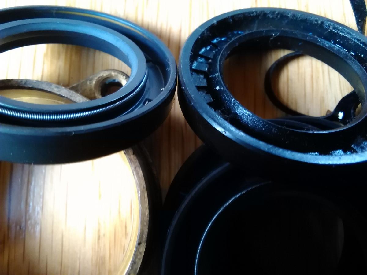

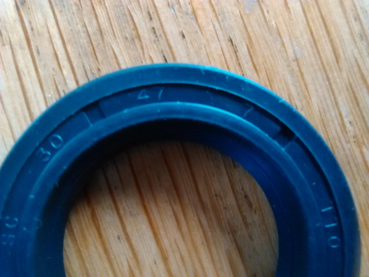

valrene9600 Posted March 1, 2016 Report Posted March 1, 2016 The original Vetus seal, at least from 11 years ago, is plain inside. The ones i am using now have a spring wire inside. Hope description means something, see photo. A word of warning. I once changed one on a friends boat aged about 13/14 years. The seals were NOT removable. The whole unit was one lump. The rubber seals were one and the rubber was for lack of correct term glued inside the bronze unit. Vulcanised perhaps is the term. Anyway this unit is no good for putting loose seals in even if you clear away the rubber its the wrong shape bronze unit internally.
raymondh Posted March 1, 2016 Report Posted March 1, 2016 Thanks for the reminder, I had intended to order a spare set of seals when this topic was discussed some time ago with pics and a great description of how to do and a link to a supplier £7 for two delivered (35mm) They are now ordered Regards Ray
Drayke Posted March 1, 2016 Report Posted March 1, 2016 Thanks for the reminder, I had intended to order a spare set of seals when this topic was discussed some time ago with pics and a great description of how to do and a link to a supplier £7 for two delivered (35mm) They are now ordered Regards Ray Ray would you post a link as to where you obtained these seals from as I could do with ordering some. Thanks Fred
