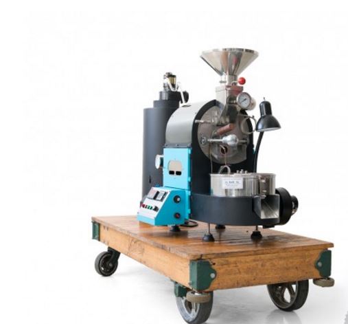

ditchcrawler Posted January 20, 2016 Report Posted January 20, 2016 I seem to remember watching a TV programme on roasting coffee and the roaster was LPG heated so could be a good compromise gas heat and electric motor at 300W say = 30A at 12V for 15 minutes say 7.5Ahs Different kettle of fish https://millcityroasters.com/shop/coffee-roasters/1kg-gas-coffee-roaster/
Dave Payne Posted January 21, 2016 Author Report Posted January 21, 2016 Yes gas roasters are commonly available, but i already have an electric roaster, maybe i could sell it and purchase a gas one, who knows. In terms of monies, i would not be relying on trade from the towpath or markets, that would be a small part of the business, the main part is selling online and building a solid customer base from coffee shops, restaurants and home users.
