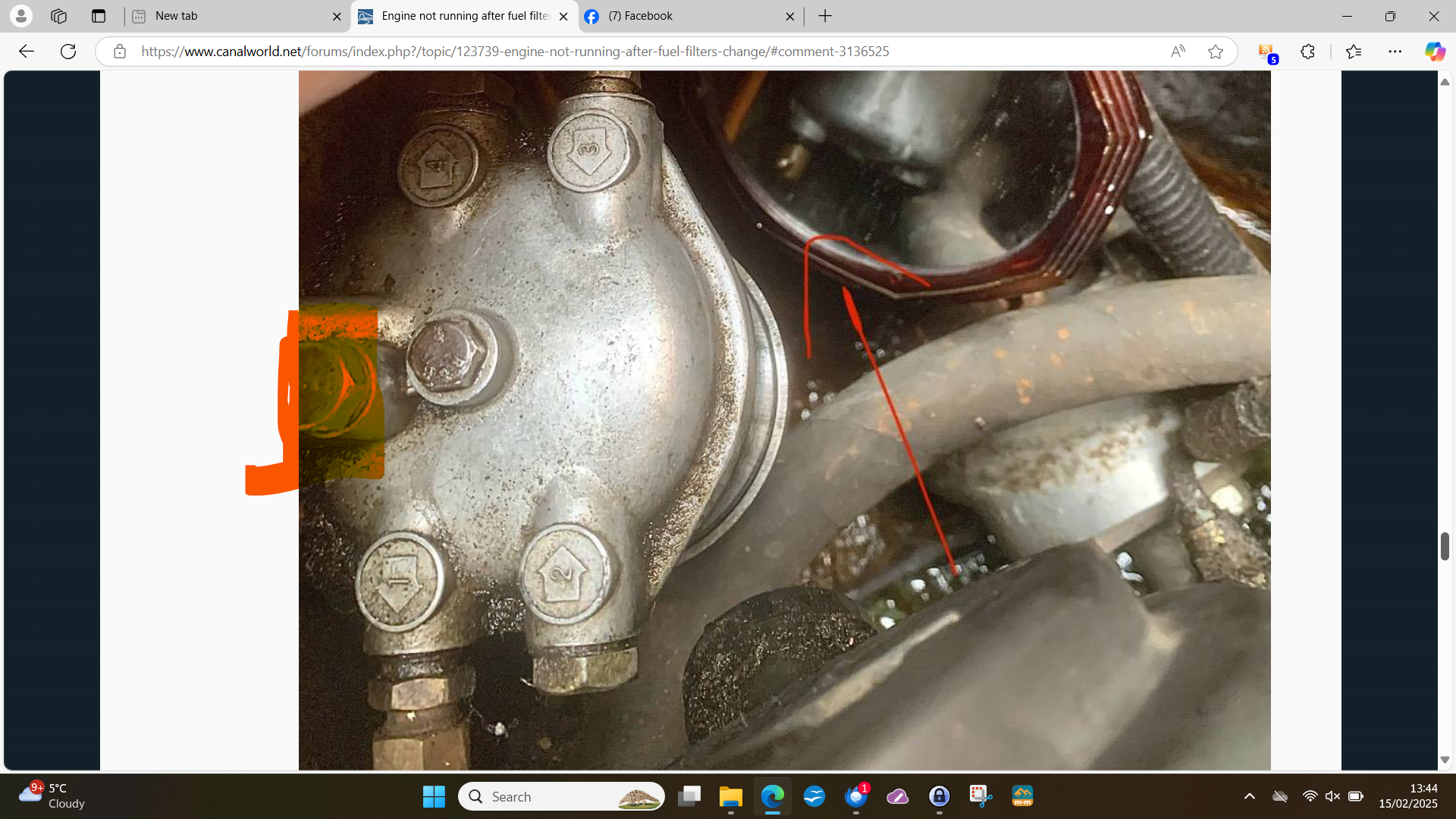

3 minutes ago, Tony Brooks said:
Try filling the ENGINE filter with clean diesel before fitting it (assuming it is a spin on type).

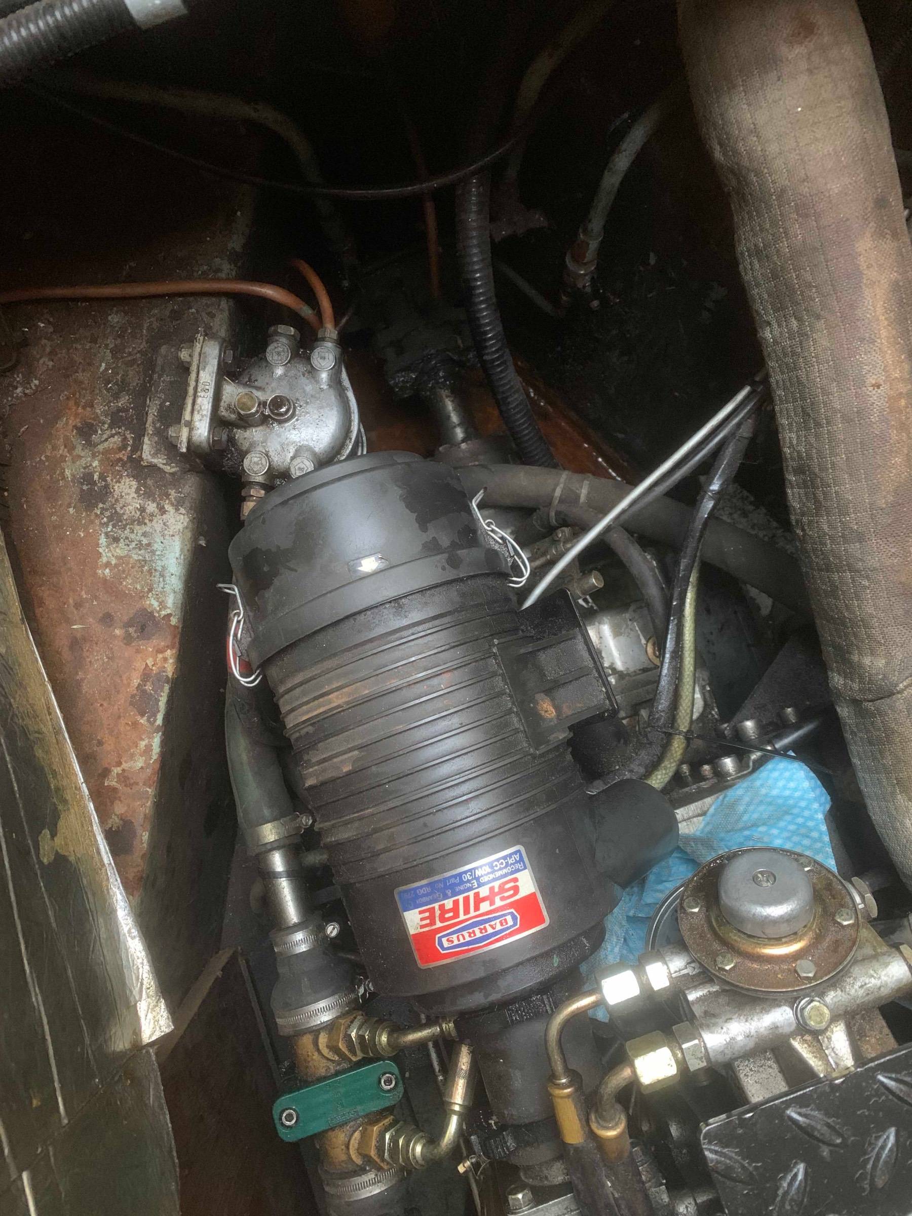

They are both the same as the one on the photo attached, I tried to fill them but they leaked straight away so I just waited until the run most of the diesel down and put them on.
Were you careful not to tread on the filter alongside the 'tread plate'
you may have knocked or squashed something.
(That's a stupid place to put a filter - or tread plate)

I find it hard to believe that Barrus have fitted a 296 type filter as an engine filter. It sounds as if you might have a sedimentor and agglomerator in addition to the engine filter, but I can't be sure without tracing the pipes.
I echo what others have said about the difficulty some people have in getting 2956 type filters to seal. I find that if, when you are approaching, nipping the canister up against the seal, then if you twist the canister you can tell if it is rubbing on rubber or is scraping on metal.
If the hidden filter is like the one in the photo and as long as fuel flows into it by gravity, loosen the bleed bolt which is behind/beside the centre bolt until just air flows out. Replace it and do the same on the hidden one.  I think that you may well have yet another one, but until I know I can't say how to bleed it. There is more to do, but until I know more about where each filter is in the system, I can't tell you what to do next.

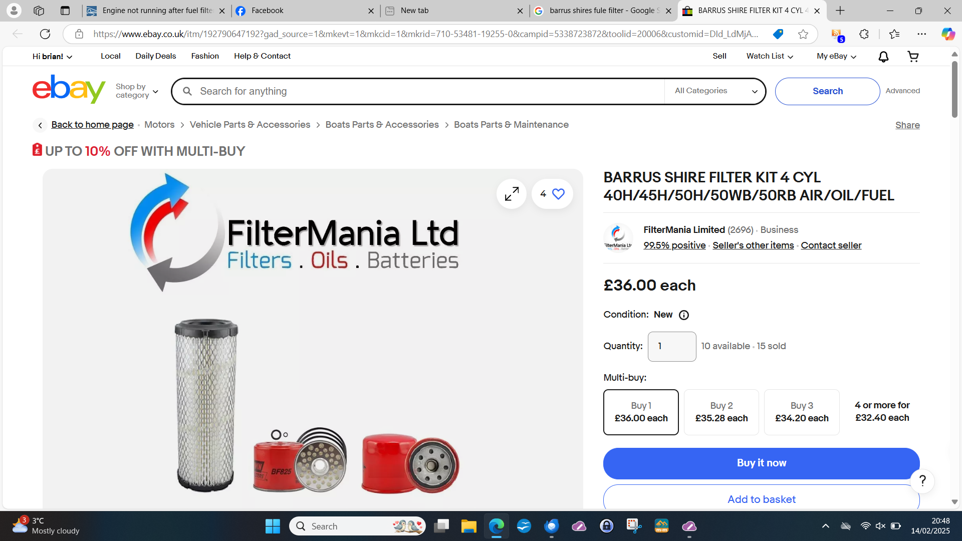

Looking online it looks as if Barrus Shires lists a spin off filter, but I dont know which engine the op has

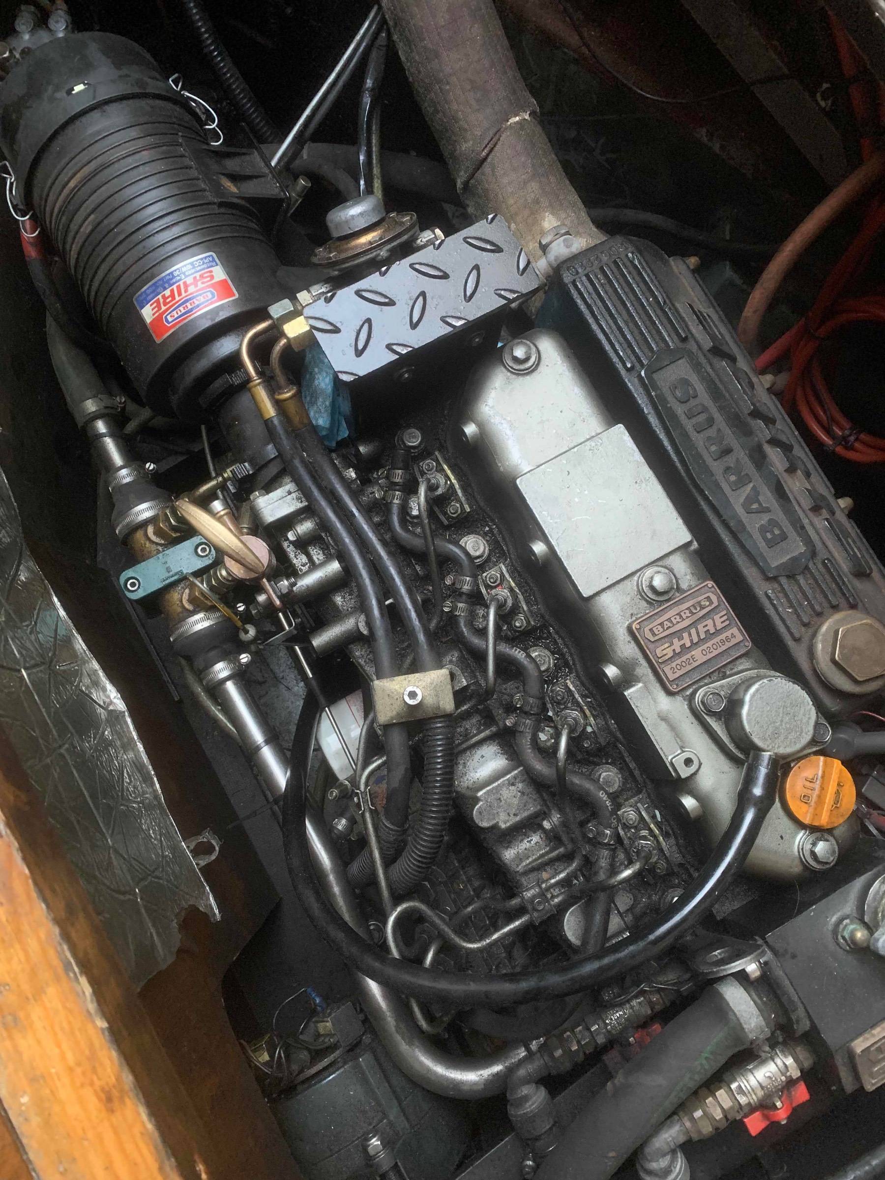

If the set up is the same as the last Barrus Shire engine I bled circa 2000 engine, both the filters are 3 part, housing, filter and bottom drain bowl all held in place by a long bolt, they are not spin on. The engine only has one filter on the engine as seen near the foot plate, it’s not a spin on but has a metal drain bowl on the bottom and is all connected by a long through bolt, I’m sure it didn’t have a bleed nut, unlike the first filter. Obviously once the first filter is bled you need to bleed the engine filter, there’s no need to bleed to the injectors. The silver dome needs to be pumped to bleed it, it’s fairly easy at first, then it gradually gets harder once bled until it’s too stiff to pump, it does take a while, once pumped to max, try starting the engine.
 Have you pumped the silver dome to max?
 Also be careful in over tightening the long bolts on the filters, they do snap.

Correct! I have got this exact system on my boat. I am gonna re-start the whole process with all the tips about the O rings gave me above (thanks all by the way) and maxing the silver dome pump.
Before I do that, just the last couple of doubts : as you rightly said, the engine filter doesn't have a bleed nut at the top, but a valve at the bottom, i'd assume that's how I bleed it? The first filter has a bleed nut at the top and a bleed valve at the bottom (see attached photo), do I need too bleed them both? Do I bleed the filters before or after having maxed the silver dome pump?
Also do I need to fill both filters with diesel before putting them on, despite the fact that they'll leak most of the diesel straight away?

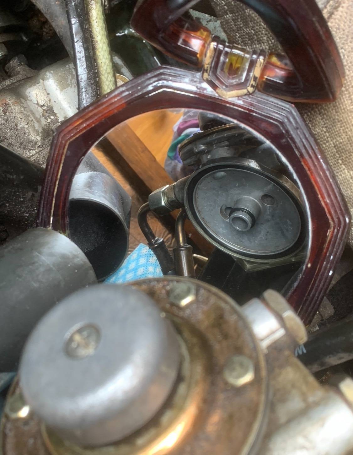

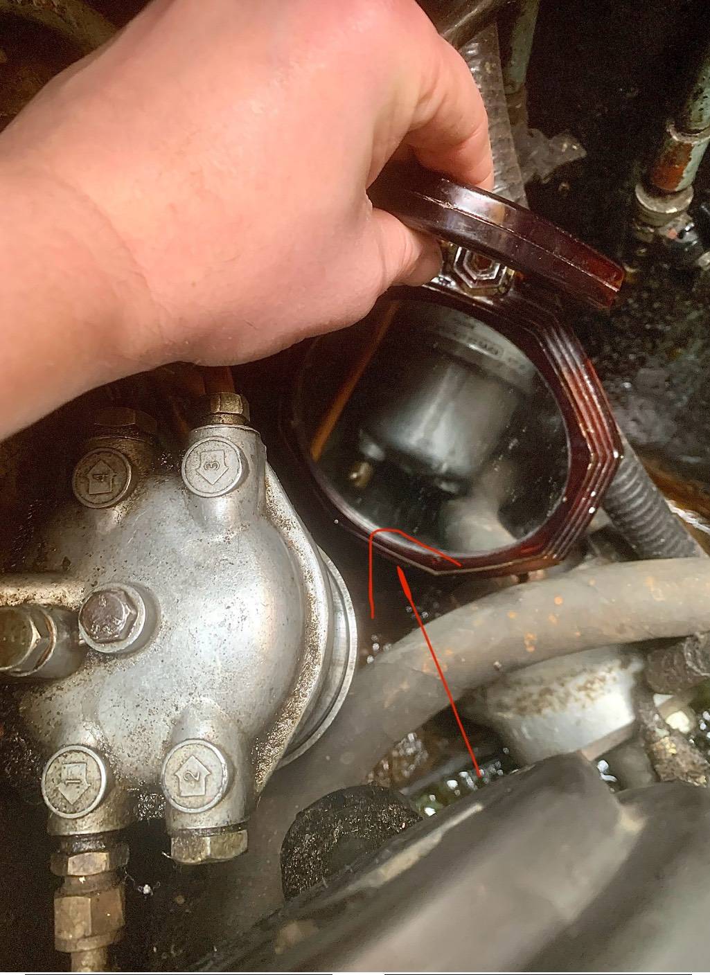

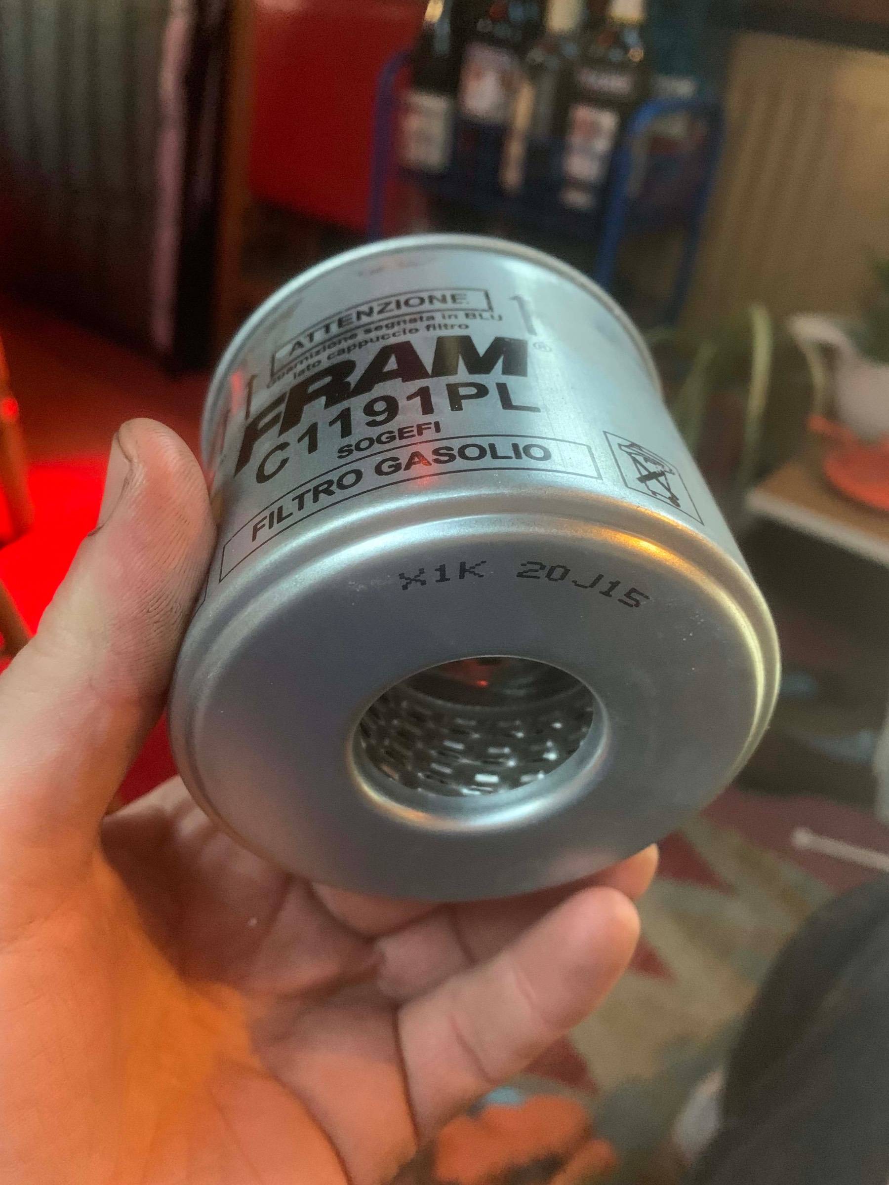

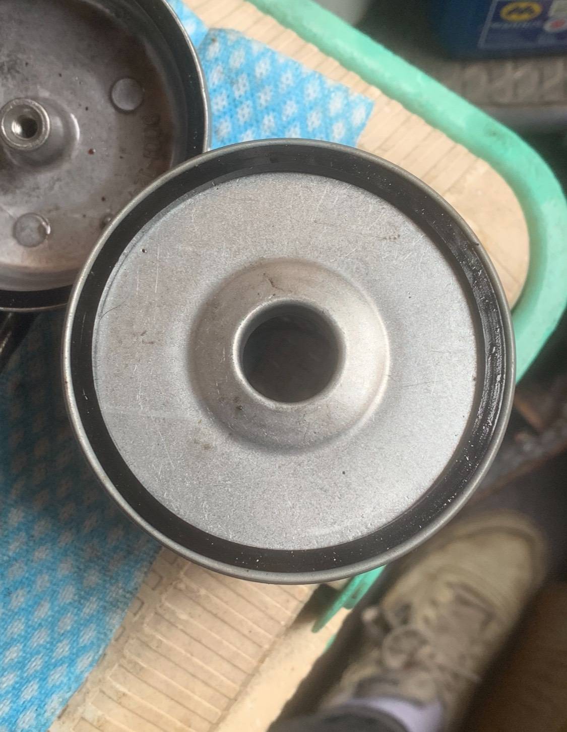

Okay, I am fitting al the 0 rings again with some silicone grease, by doing so I realised that on the second filter I left an old ring (see photo attached), which is larger than one on the filter itself. The filter came with only 2 of the large new replacement 0 rings while here it looks that 3 on total are needed? or I should not fit the 0 ring on the filter itself in this case and just leave the one on there housing?
Edited by Roberto Conigliaro
The O ring in the filter should not be there, it will stop the fuel passing through the filter. Pull it out and bin it.
The top photo shows that O ring is well-fitted, so when you reassemble when the bolt starts to pull the three parts together start twisting he filter to feel (and hear) if it is rubbing on rubber or metal. It should not rub on metal.
It’s a awkward fit to get everything aligned on the engine filter, you can bleed it, get it running and still have a small leak from the filter, you could tighten the bolt slightly to seal, but whatever you do do not overlay force tighten, as you can snap that bolt. Then it’s a pain, but if you do they are readily available.

This is the bleed so if you try and bleed it correctly before taking it to bits it may work
