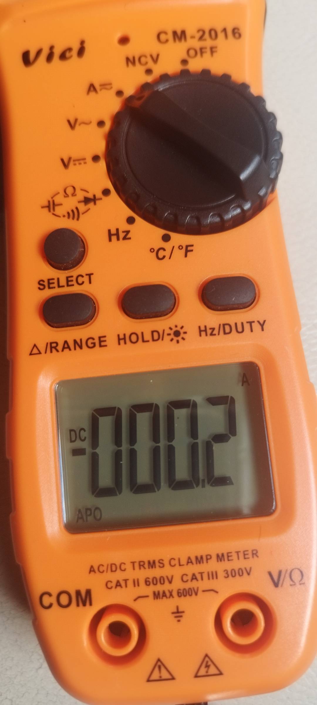

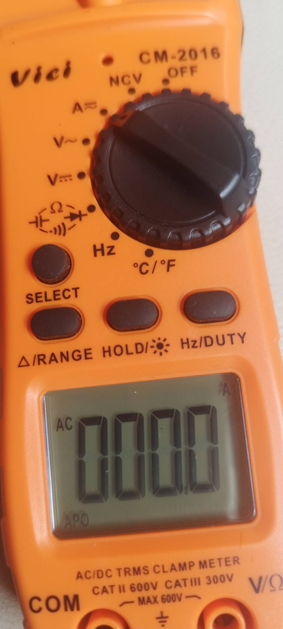

4 minutes ago, blackrose said:
I've got one of these. I've no idea if it's any good but it seems to do the job.
Vici CM-2016 Handheld Digital Clamp Meter Multimeter AC/DC Volt Amp NCV Tester orange & black
https://amzn.eu/d/56lBQSM
It doesn’t do dc current, so not much use for 12v systems.
It definitely does DC current. You set it to current and use the select button to choose AC or DC
Edited by blackrose

Yes I can see the Amazon product ad says it only does AC current, but as shown in my post above it actually does both AC & DC. I've measured DC current on my BT charge cable using this meter so I know it definitely does DC current.
