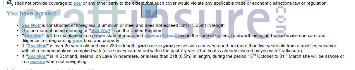

MtB Posted July 18, 2024 Report Posted July 18, 2024 4 minutes ago, Alan de Enfield said: I think it depends on which underwriters they are using at the time .................... Is "Sea Wolf" a narrow boat then?
