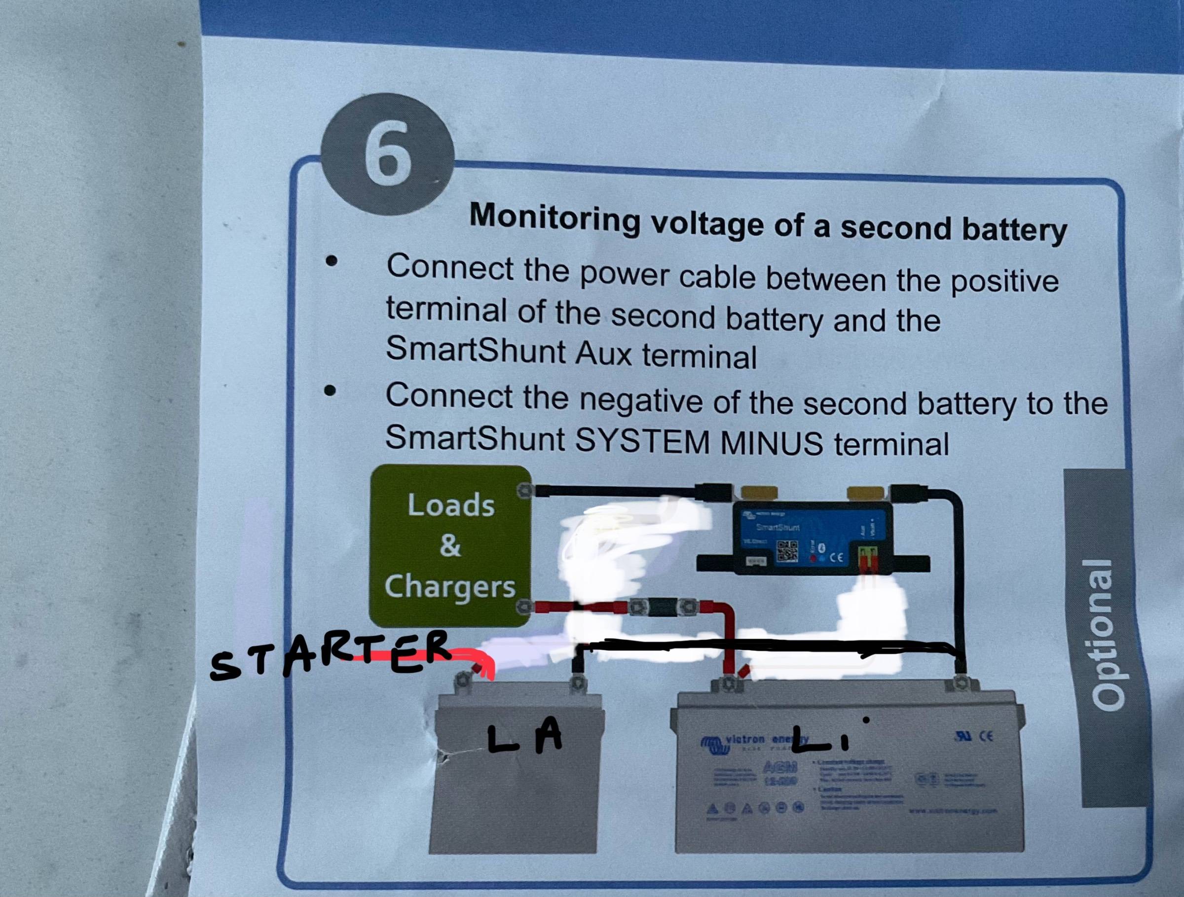

I’m planning on adding a shunt into my leisure bank wiring but looking at it the other day it seems to be set up as in the “picture” below. The starter battery (charged from its own alternator has a negative that’s connected to the leisure bank. Will this setup work ? Or should the negative return to the starter battery with no connection to the leisure bank?
    Please ignore the shunt, I just used the picture as it’s easier than trying to explain or draw my own picture
The negatives of both the starter system and the domestic system should be grounded to the boat shell. In your diagram the starter battery should also have a negative cable going to the negative terminal or a mounting bolt of the starter motor (with the engine block then grounded to the hull, especially if it is on rubber mounts). The grounding of the domestic system is then achieved by linking the two battery negatives. Not the only way of doing it but looks fine to me.
What David Mack said. Without seeing the way the engine electrics negative is or proposed to be wired, one can't be sure you will not put the starter current through the shunt, which is not a very good idea.

You must have only one thing connected to the leisure battery negative, and that is the battery side of the shunt. The load side of the shunt is connected to the starter battery negative, the boat systems negative (for lights, pumps etc) and a single connection to hull. A connection to hull is likely to already exist via the engine (via exhaust, control cables, prop shaft etc) so in order to avoid current paths through the hull, just make a good quality connection between engine and hull.
That is, unless the engine is isolated from starter negative, alternator negative (unlikely, but possible) when you can make a connection from eg starter battery negative to hull.

No sorry this is wrong. If you link the battery negatives directly the shunt will not work properly. If you have multiple negative connections to hull, this creates a current path through the hull which can cause corrosion.
As I say, the picture is somewhat of a simplified version of reality. But I would have thought the starter battery earth should return directly to the starter battery and have no connection to the other batteries

That is one way of doing it, but topologically it is exactly the same whether you have one connection to the engine going to the starter battery and with the shunt connected between starter and leisure battery, vs having one wire from shunt load side to engine and another wire from starter battery negative to engine. You just physically move the point where the two negatives are connected without any effect on the circuit. The two negatives are now connected at the engine instead of being connected at the shunt load side.

If all the domestic charging and loads go through the shunt, it shouldn't matter which side of the shunt is connected to the starter battery negative and from there to the hull ground. The only difference will be that the potential of the domestic battery negative terminal will be a few mV different in the two cases. The rest of the domestic system should be fully isolated from the hull, so where could any additional negative connections to the hull arise?
No. It creates an alternative current path for the domestic negative so the shunt only registers about 1/2 the charge current but all the discharge current.

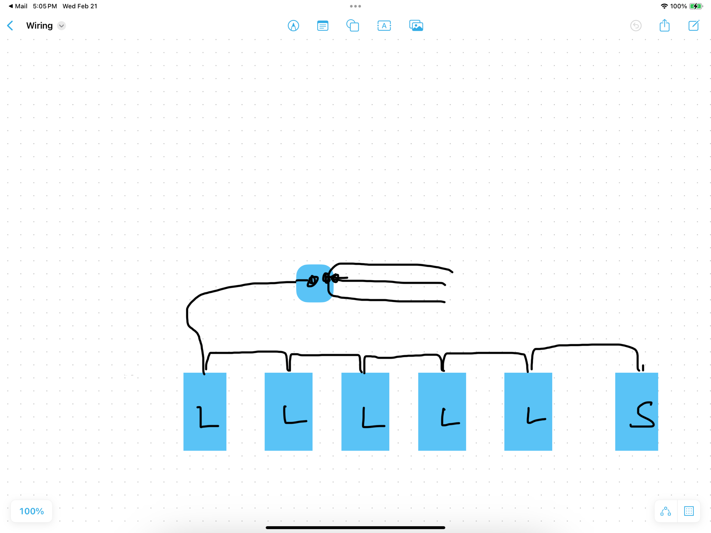

I’ve finally worked out how to draw so,   The picture below shows what’s actually there if that’s any clearer, it just strikes me (probably wrongly) that if the shunt were placed between the junction box and the leisure battery then wouldn’t the starter be caught up in the readings?
The rule is that there should be one thick wire going from the "battery" terminal of the shunt directly to the domestic battery negative, and Nothing else should connect to this, nothing at all. Hence no matter what is going on elewhere you can be sure that ALL of the current from the domestic batteries is going through the shunt.
.....but for the pedants, there is just one exception, if you have a Smartgage or anything else that needs to accurately sense battery voltage then this can connect to the batery terminal. These devices only take very small currents so bypassing the shunt is acceptable.
and a negative busbar is of course fine as long as nothing else connects to it 😀

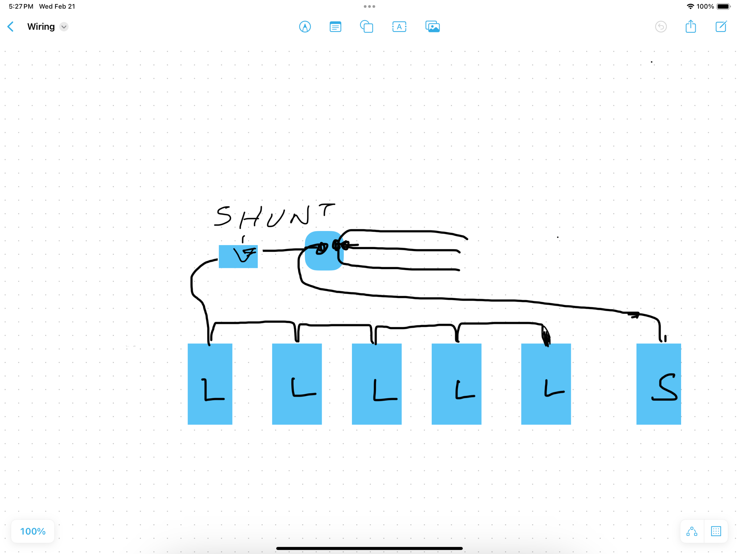

I’m on a ferry from Amsterdam to uk and about to lose signal, but just to clarify, connections to be as follows:
From leisure battery to shunt (battery side). From shunt (load side) to engine/alternator negative - either via a connection to starter negative and thence on to engine/alternator negative, or direct to engine/alternator negative (both these options are the same from a circuit point of view. Nothing. Nothing. NOTHING  to be connected to leisure battery negative, apart from the shunt.
Just now, David Mack said:
How? The OP refers to the domestic battery (LA) having its own alternator, and his diagram shows the Li domestic battery as having its own charging (presumably including a second alternator). So no charging current (for either battery) will pass through the lead connecting the battery negatives so there can't be any impact on the current through the shunt.
The alternator negatives are connected at the engine, so some of the leisure alternator negative current will flow via the shunt, some of the leisure alternator negative current will flow direct via the starter battery negative lead bypassing the shunt.
7 minutes ago, Moke said:
So this is how it should be?
Yes. Somewhere in your”junction box” you need a lead to the engine casing (alternator negative). From the engine casing a short lead to the hull.

If I understand you correctly then a shunt in the cable between the junction box and the first leisure battery (as in the first drawing) would work ?
