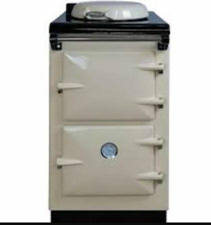

Maudesmaster Posted September 25 Report Share Posted September 25 (edited) Hi in Skipton Yorkshire looking for an OFTEC fitter to service our range 1 doesn’t do boats and couple more too busy has anyone serviced their own and can tell me how to if quite easy thank you in advance Rich Edited September 25 by Maudesmaster Link to comment Share on other sites More sharing options...
Alan de Enfield Posted September 25 Report Share Posted September 25 2 hours ago, Maudesmaster said: Hi in Skipton Yorkshire looking for an OFTEC fitter to service our range 1 doesn’t do boats and couple more too busy has anyone serviced their own and can tell me how to if quite easy thank you in advance Rich If you are loking to only work with an OFTEC certified fitter you may have a problem - he will not doubt only work on it if it is fitted in accordance with the manufacturers instructions, and invariably, you cannot fit one on a boat within the manufacturers requirements (Flue length is a typical failure point) What sort of range is it ? Solid fuel, Gas, Diesel, wood, ??? Link to comment Share on other sites More sharing options...
JungleJames Posted September 25 Report Share Posted September 25 It'll be either diesel or electric. As he wants it serviced, assume diesel. Heritage do advertise putting them on boats. So you'd hope it would be fitted as per their instructions. Might be easier to ask Heritage. Whilst you do see some on narrow boats, it doesn't seem to be many. The cost probably puts a lot of people off!! Link to comment Share on other sites More sharing options...

magnetman Posted September 25 Report Share Posted September 25 41 minutes ago, JungleJames said: Forced combustion jet burners according to the website. That will be a PJ Installation and Maintenance Qualified technicians familiar with range cookers and modern pressure jet burners will be able to install and service your Heritage. Link to comment Share on other sites More sharing options...
JungleJames Posted September 25 Report Share Posted September 25 40 minutes ago, magnetman said: That will be a PJ Installation and Maintenance Qualified technicians familiar with range cookers and modern pressure jet burners will be able to install and service your Heritage. Yep, I assumed so! Link to comment Share on other sites More sharing options...

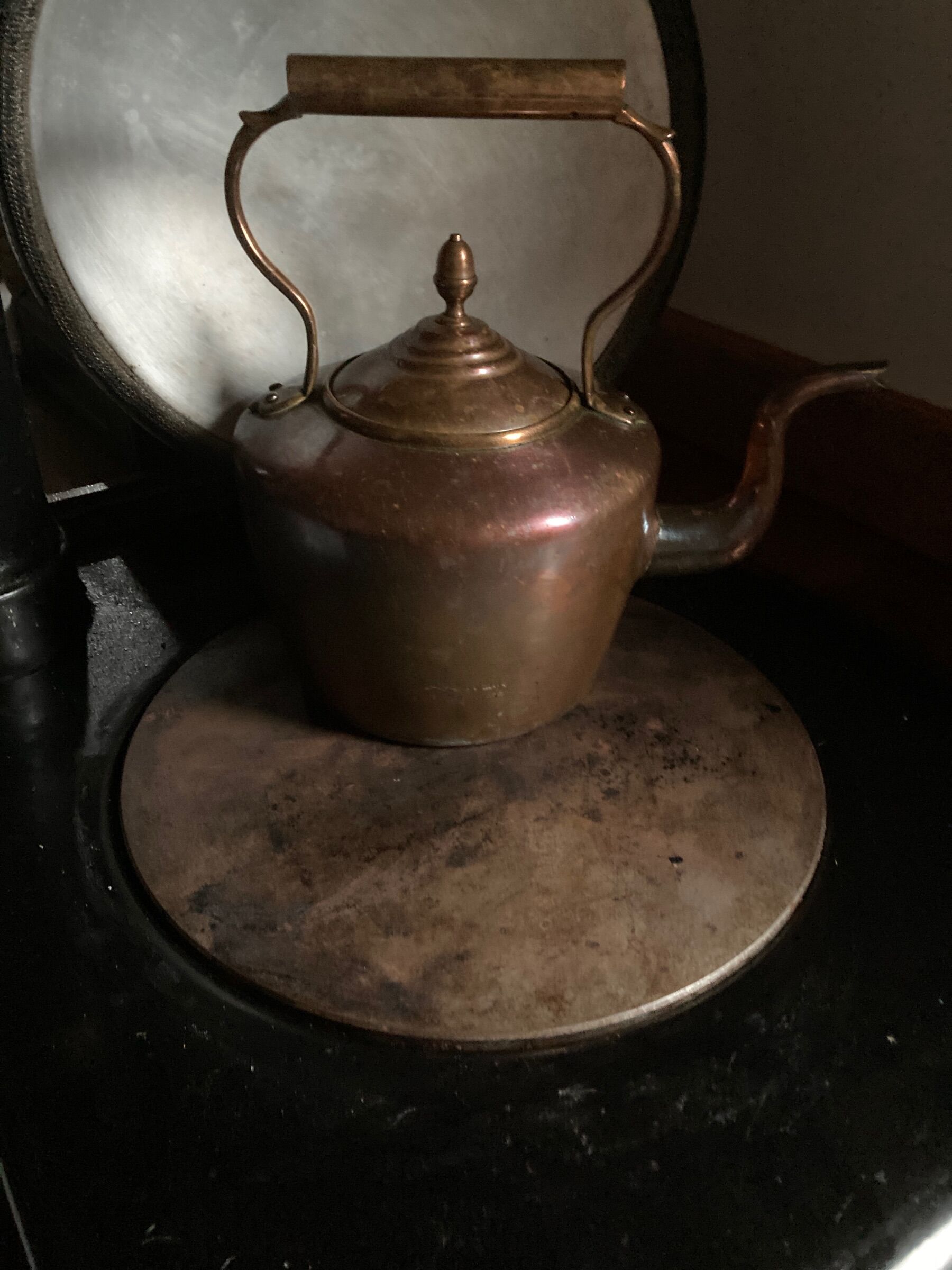

Maudesmaster Posted September 26 Author Report Share Posted September 26 It’s 240AC fan Diesel burner cooking only and was fitted by OFTEC people who deal with Heritage 3lw Gardner 2’3 draught from cold takes over1 hr to boil a kettle would not recommend and no after sales service sent E mails about flue when first fitted nothing back Link to comment Share on other sites More sharing options...

plato Posted September 28 Report Share Posted September 28 Ok, my first thought is do you need a whole kettle of water? Try putting in only the amount of water you actually need. Also what type of kettle do you have? I use a le crueset, found that pretty good. you could also turn the temperature up a bit and see how that goes. If it makes no difference you may have a problem with the thermostat Mine was a cook plus model , which did cooking, heating and hot water so by the time I’d boiled the kettle and made some toast it had made enough hot water for the day and warmed the bathroom. Link to comment Share on other sites More sharing options...
Maudesmaster Posted September 28 Author Report Share Posted September 28 The kettle is a big vintage copper we only fill half way to bottom of spout we have a le crueset but find this quicker as fatter bottom However range now cuts out after a while and thermostat says needs a service so I either need instructions on servicing or preferably an OFTEC fitter Link to comment Share on other sites More sharing options...
plato Posted September 28 Report Share Posted September 28 Good tip , I might try that. I think you’ll have a Stirling burner in there , very common and no problem for an engineer to service. If you’re of a practical bent it’s fairly easy to to change the nozzle. That will help but when my engineer does mine he analyses the exhaust gases and makes adjustments to get it burning efficiently. Which you wouldn’t be able to do. He charges £80 which is a lot less than heritage do. my stove had been sat unused for 2 years in a boat that had been partly flooded. So it wasn’t running at all well when I first used it. Heritage did send an engineer up to Gloucester from Cornwall but it wasn’t cheap. He did strip it down and did a very thorough job on it. if you phone them them I’ve always found them to be helpful. I put redex in my diesel and it definitely helps. My engineer commented how clean the nozzle was when he serviced it. Generally they’re very sooted up. Redex is often on offer in Tesco or Lidl so not costly for the benefits you get. good luck with it and let us know how you get it sorted Link to comment Share on other sites More sharing options...
Ex Brummie Posted September 29 Report Share Posted September 29 Range cookers rely on the storage of latent heat. Solid fuel or oil vaporising burners are always on. Gas or oil blown burners on more recent units are still kept ticking over and the core is kept to around 150-180oC. You can put this on a timer so that it doesn't race away all night, and it will still retain some heat to speed top up in the morning. when you look at the thickness of the hotspot under the lid, you can see why it takes an hour to boil a kettle. The thermostat measures the oven temperature so the hot spot will be cooler. Most users always have a kettle on the top of the hob, transferring it to the hot spot when needed. Obviously on a boat in warm weather this permanent running can be uncomfortable. In an open farmhouse kitchen it was not so much of a problem. The new range of Aga's and the like, to adapt to modern living and levels of insulation, have elements for the core, controlable ovens and independent hobs. Unless you have a 60ft widebeam, a range cooker like this is probably not a good idea. Link to comment Share on other sites More sharing options...
