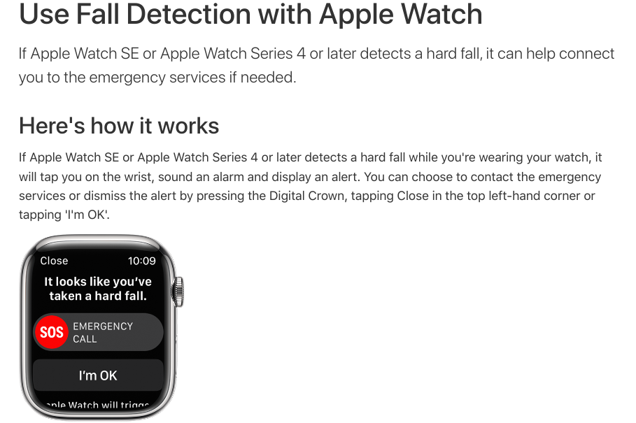

Psychalist Posted February 9, 2023 Report Posted February 9, 2023 2 hours ago, BilgePump said: Just steer clear of roller coasters. The high acceleration/deceleration can set off the crash detection feature and people didn't realise it had activated. PLB perhaps a better option... Skiers false alarm Boxers false alarm

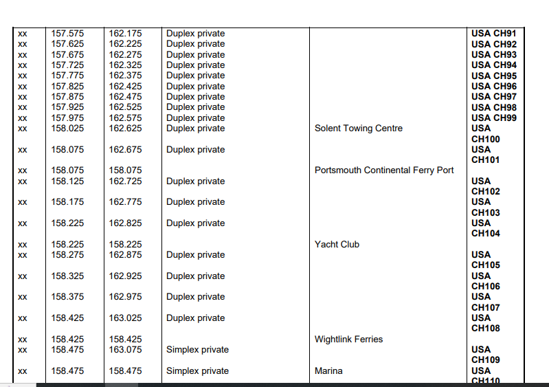

Alan de Enfield Posted February 9, 2023 Report Posted February 9, 2023 (edited) 56 minutes ago, magnetman said: Channel 16 is the same frequency whatever hardware you have on the boat. If you have a VHF set originating from the USA (I have two USA sets on one of my boats) CH16 works in the same way as a UK radio would. Channel 16 is the emergency channel which is on a standard frequency. If you read what I said you would see that I did not suggest that is was not one of the common frequencies. I explained that there were additional frequencies in the US Marine band that were allocated for alternative uses in the UK, and likewise there are frequencies in the UK Marine band that are allocated for other uses in the US. That of course leaves SOME common frequencies of which cahnnel 16 is one. You probably think that the UK Coastguard keep a listening watch on Channel 16 - sorry to dissapoint but they have not done so since 2011. DSC is the accepted method of notifying distress now, I'm sure that you are also aware that a few years ago due to the need to provide more channels in the VHF band in the UK the marine 25khz channel spacing on some of the duplex channels was 'split' producing 27 new channels (not available on US radios) with 12.5Khz channel spacing, meaning that the old duplex channels now became simplex. Edited February 9, 2023 by Alan de Enfield
magnetman Posted February 9, 2023 Report Posted February 9, 2023 5 minutes ago, Alan de Enfield said: If you read what I said you would see that I did not suggest that is was not one of the common frequencies. I explained that there were additional frequencies in the US Marine band that were allocated for alternative uses in the UK, and likewise there are frequencies in the UK Marine band that are allocated for other uses in the US. That of course leaves SOME common frequencies of which cahnnel 16 is one. You probably think that the UK Coastguard keep a listening watch on Channel 16 - sorry to dissapoint but they have not done so since 2011. DSC is the accepted method of notifying distress now, I'm sure that you are also aware that a few years ago due to the need to provide more channels in the VHF band in the UK the marine 25khz channel spacing on some of the duplex channels was 'split' producing 27 new channels (not available on US radios) with 12.5Khz channel spacing, meaning that the old duplex channels now became simplex. Interesting about the channel 16 thing. Are you saying nobody monitors it? I think there will be some commercial craft who keep it on just to check for problems. Maybe not. Maybe I misinterpreted your post. It appeared to me that you were saying that using PLB was in some way similar to using a marine VHF radio. Sorry, I thought you were suggesting a US radio would not work to call for assistance on channel 16. I see now I did misinterpret this. Ditchcrawler: That's a bit like having marine radio but no licence. If I don't have one and still call them will they come. Alan de Enfield: Maybe a better comparison would be having a marine VHF radio on the US / International frequencies, using it in the UK and asking for assistance.

Alan de Enfield Posted February 9, 2023 Report Posted February 9, 2023 (edited) 3 hours ago, magnetman said: If you have a VHF set originating from the USA (I have two USA sets on one of my boats) CH16 works in the same way as a UK radio would. Just found several pages of US Marine VHF channels which are not allowed for general Marine use in the UK. Some of these frequencies have been sold by the regulator for private use - so your USA VHF will be transmitting on UK 'Private' channels : Edited February 9, 2023 by Alan de Enfield

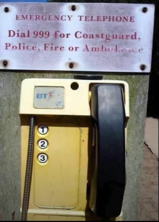

George and Dragon Posted February 10, 2023 Report Posted February 10, 2023 On 09/02/2023 at 09:03, magnetman said: Don't get one of these That's a european phone - you have to call 112 1
sigsegv Posted February 10, 2023 Report Posted February 10, 2023 @LadyG can you specify whether you want a device to call emergency services *on your behalf* given some particular event (i.e., a fall, submersion, etc.), or simply a device that is small and portable that enables you to manually call the emergency services easily?
TheBiscuits Posted February 10, 2023 Report Posted February 10, 2023 3 hours ago, George and Dragon said: That's a european phone - you have to call 112 Option 3, presumably!
