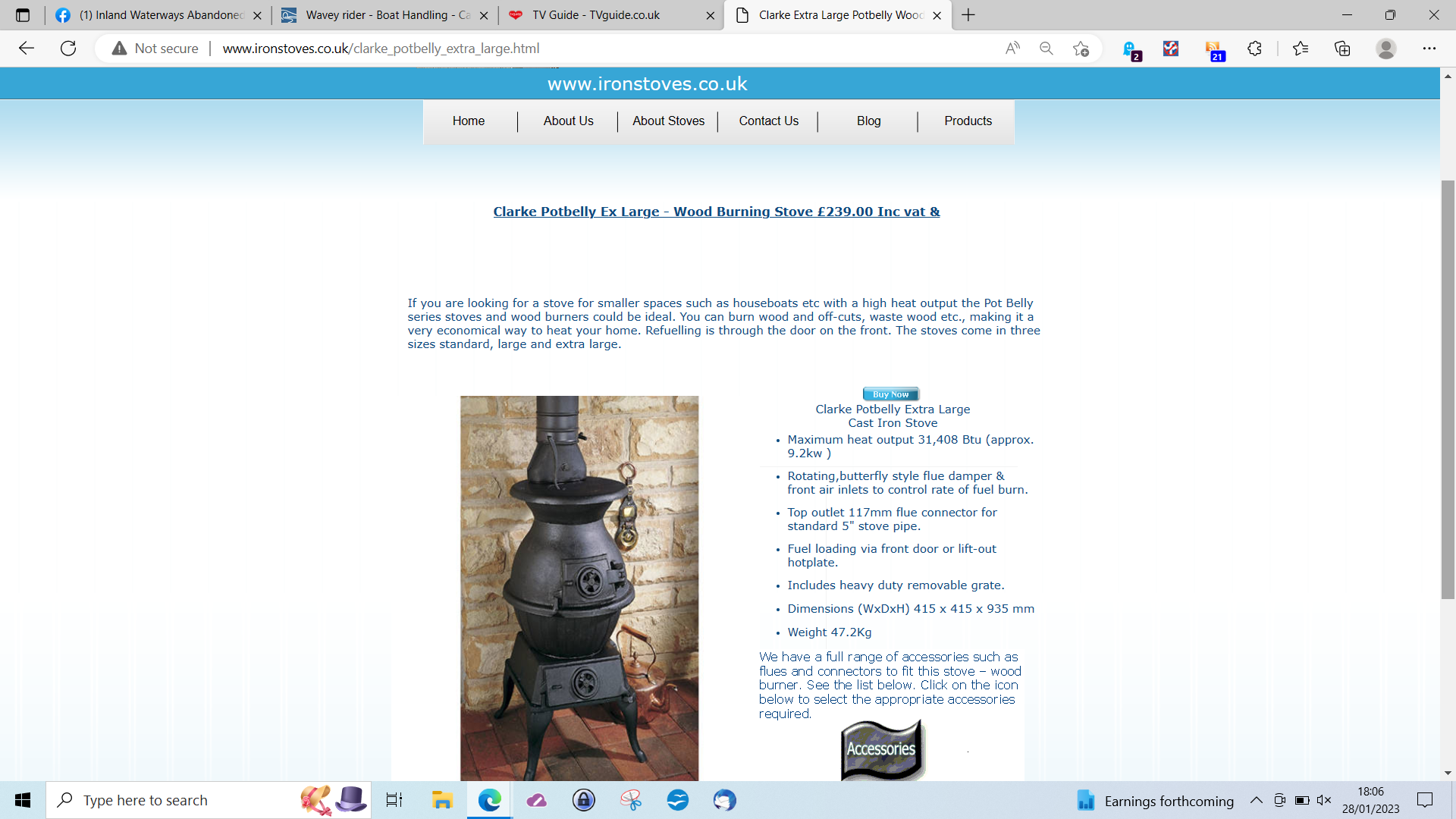

Ronaldo47 Posted January 28, 2023 Report Posted January 28, 2023 (edited) I understand that the sale of new pot-bellied stoves is now prohibited as they are not sufficiently efficient, so you would need to find one second-hand. The heritage railway where I volunteer needed a replacement one last year and discovered this. They ended up fitting the old one with a red LED light for cosmetic effect and stuck a fan heater under it. Edited January 28, 2023 by Ronaldo47 typos 1 1
magnetman Posted January 28, 2023 Report Posted January 28, 2023 9kw seems a bit large I'd be looking for 1kw although that is difficult to achieve with a wood stove. A small tall square one DIY made from box section could work but watch the flue size.
ditchcrawler Posted January 28, 2023 Report Posted January 28, 2023 18 minutes ago, magnetman said: 9kw seems a bit large I'd be looking for 1kw although that is difficult to achieve with a wood stove. A small tall square one DIY made from box section could work but watch the flue size. It was the first one I saw to show potbelly are still available
Ronaldo47 Posted January 28, 2023 Report Posted January 28, 2023 (edited) Whrn I looked on-line last year I found a couple of sites that advertised pot belly stoves, but on ringing to check availability it turned out that I had been looking at old versions of their web sites that for some reason were still on the web. They confirmed tfat they were no longer allowed to sell them. On the other hand it could be that they still have stock that they would like to dispose of, despite the regulations. A local one-man electrical shop near me (but not in the main shopping centre), still has a bin of 60W tungsten GLS lamp bulbs on open sale, despite their sale having been prohibited for some years, and they are not the special "rough service" bulbs that I think are still allowed. Edited January 28, 2023 by Ronaldo47 typos

Ronaldo47 Posted January 28, 2023 Report Posted January 28, 2023 (edited) 2 hours ago, ditchcrawler said: I tried that site just now. It says to call them, but I couldn't find a phone number anywhere, just an enquiry form, the link to their T&C's doesn't work, and their latest blog entry is 2015. This might be the dead site I found last year: the prices look far too cheap to be current products. I will be pleased if I am wrong! Edited January 28, 2023 by Ronaldo47

Ronaldo47 Posted January 28, 2023 Report Posted January 28, 2023 (edited) Clicking the link, (for which I got a warning that the site was not secure), did get me to the pot-bellied stove. However, on clicking the site's HOME tab, the product line is found to consist only of radiators and baths. So it looks like another fossilised web page. I would be happy to be wrong. Edited January 28, 2023 by Ronaldo47
