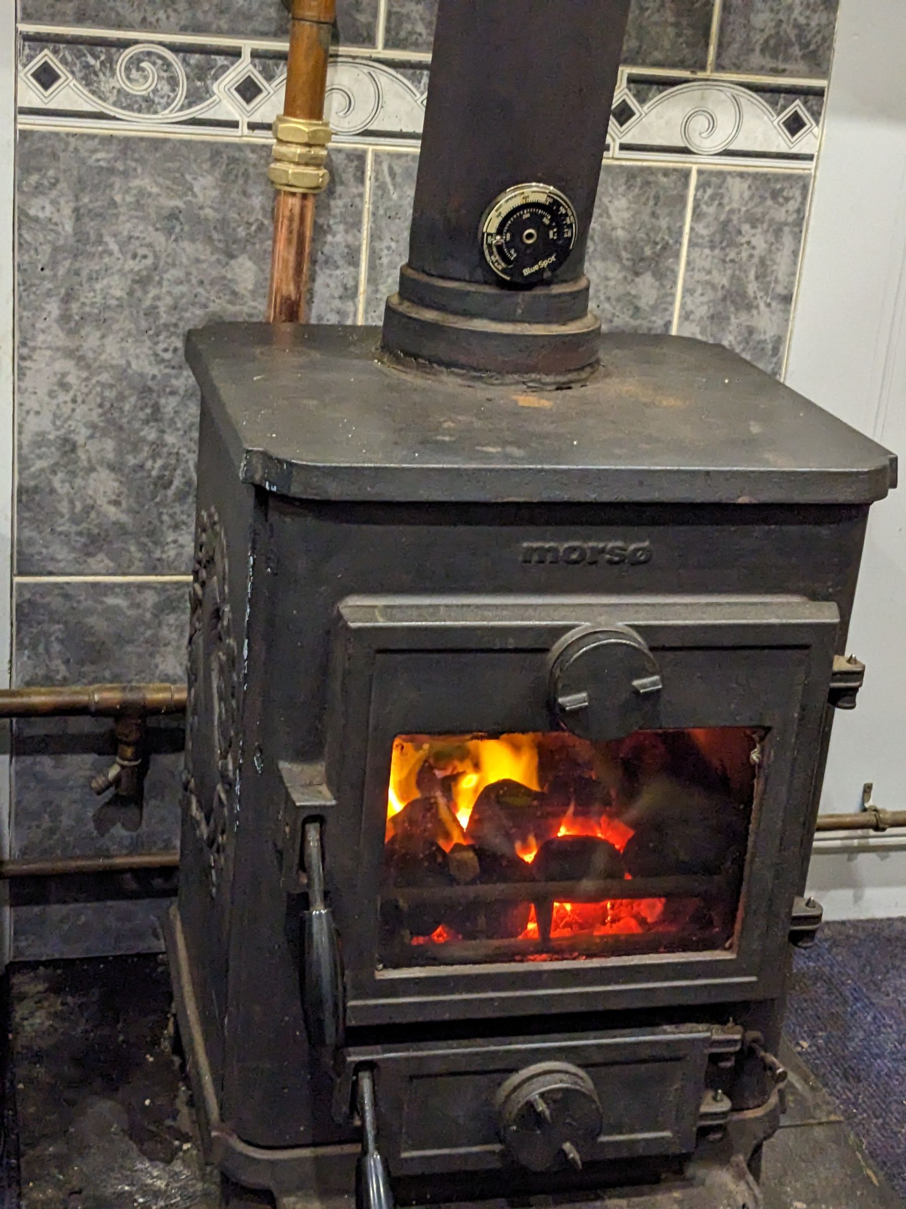

DShK Posted December 14, 2022 Author Report Posted December 14, 2022 Me and the pup will be toasty tonight thanks to everyone. Thank you everyone so much. I really appreciate it. I couldn't have done it without you all. I will update when I can tell if this sorted out the circulation issue. I have cleaner running through it at the moment too. I notice the boiler is not making any noise at the moment, which is great. 1 1
magnetman Posted December 14, 2022 Report Posted December 14, 2022 Thats great. Nice to see a hot fire on an unusually cold night. 1
