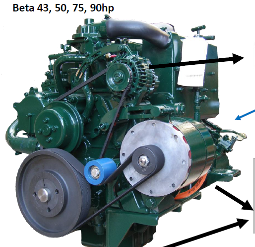

Which means an idler pulley is needed, like this... (alternator is a 48V 100A Electrodyne)

IIRC Balmar specify a 180deg wrap, if you don't have an idler pulley with their standard (6-rib?) polyvee pulley you risk it slipping -- see picture above for a recommended layout.
If you have the rib side on the alternator then you will also have the ribs on the flywheel, not the flat side 😀. I think the idea of using the flat side refers to idlers as in the picture above.  An issue with a big pulley or flywheel is that it results in very poor wrap at the alternator, unless you include an idler. I have seen installations where this is partly solved by mounting the alternator some way from the engine rather than on the engine.  mtb???.

You don't want a very long unsupported belt run between flywheel and alternator anyway, it can make the belt prone to vibrating/resonating from side to side (like a plucked string) driven by engine torque fluctuations -- especially with a big (heavy) alternator spinning quite fast, which has a lot of inertia.
FYI Beta recommend using a freewheeling pulley with big alternators like this to reduce vibration and belt wear, but these are only available in certain sizes (diameter and V count).
