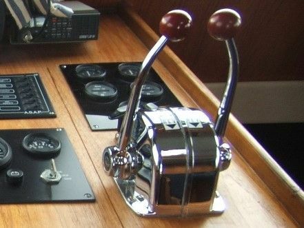

7 minutes ago, MtB said:
If you have a Morse or Teleflex single lever control, there is usually a button somewhere (often in the middle of the pivot) that you can press in whilst moving the lever forward to raise the engine speed.  Holding the button in prevents the gear from engaging, so the propeller does not rotate when you speed up the engine.
I can’t find any buttons on my gear but I’m sure I’ll find out how to adjust it with some investigatory research!
Post up a photo of yours and someone will recognise it. I've yet to see one without some sort of gear disengagement button, lever or whatever.
Here are some photos
Excellent, thanks.
Loddon was right on it! Pull the whole lever outwards using those recesses in the middle to grip it, then push the lever forward to rev the engine without engaging gear.
14 minutes ago, Loddon said:
In which case the whole handle may pull out, grab round the pivot point and pull awayfrom the panel as you move the lever.
easier to do with the engine off
Sounds like that’s it! Thank you!
They were at the top of my list because of space saving so thank you so much for the tip off!!!
I have known a control where the whole lever pulled out rather than just pulling a knob
